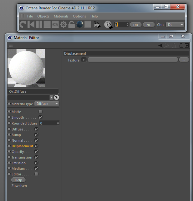

NVN
Posts: 504
Joined: Tue Jun 08, 2010 8:10 pm
hi aoktar.
i cant use Displacement.
It is normal?
Tested in r14 and 15.
