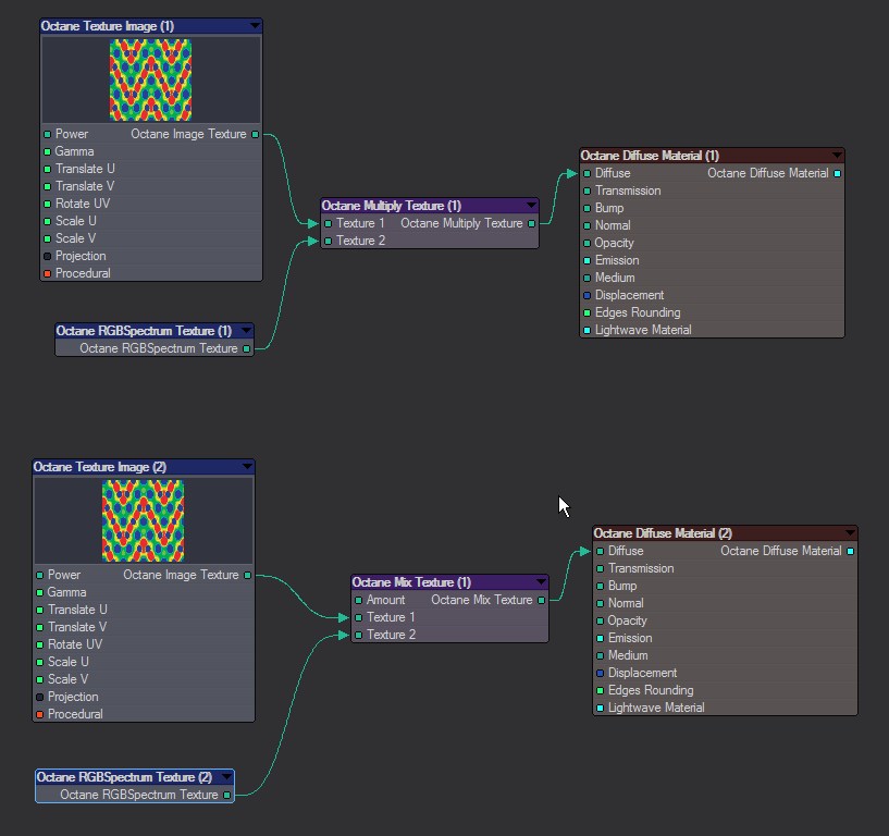

i would love to see a node which could give the LW surface color as a plain color texture to be mixed with octane textures. the reason is that i have many materials which actually use layered textures which are combined with surface color. these are not easy to translate to octane, as only textures can be mixed, not colors with textures. also, more combination modes would be necessary, like photoshop multiply and screen.
is there a chance to see this in future versions? currently, material conversion for existing projects - in order to preserve look continuity to native LW projects - is really limited by these factors.

You can mix or multiply textures with colors if you use the Octane color texture nodes.3dworks wrote:not sure if this is the right place for a feature request...
-Juanjo

ah thanks, juan, that's OK - didn't realize this was possible.
another request would be if the 'get texture' button could also get projection parameters for that texture? in case of multiple layers, even just getting the parameters of the first layer would be helpful, as most materials use just one layer. also, it would speed up to setup the nodal network without having to copy paste on the run.
EDIT: found now out that the UVMAP node does more or less what i want! this node is going to be supported in the future?
