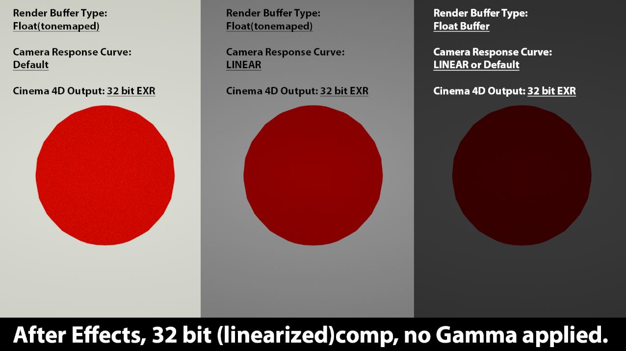

What Raphael here says is actually correct - if you choose "Render Buffer Type - Float Buffer" the render is actually pretty dark no matter the camera response curve you pick. To get it looking right in post you'd do have to add a 2.2 gamma.
However, this is probably approached from a wrong angle. You will get a correct linear result if you pick "Render Buffer Type - Float(tonemapped) AND you select a "Linear" response curve for the camera. It's the same result you would get after adding 2.2 gamma in post to any dark-looking "Float Buffer" render. So, in my understanding, "Float (tonemapped)" is THE way to go and the output (linear or tonemapped) is to be controlled by the camera response curve. You want linear output? - set the cam. response to linear. You want tonemapped - leave it as it is.
I am not sure if this is physically correct but by the "looks" of it - it is. See if the image attached will make any sense.
Dobs
Dobs

Hi and thanks for all your responses especially shawnfrueh!
Other suggestion:
If the Untonemapped is correct that way I´d rather stay with 32bit tonemapped as shawnfrueh suggested.
Would it be possible to not clamp the Tonemapped 32bit output as I really need the above 1 values in compositing?
Cheers,
Raphael
