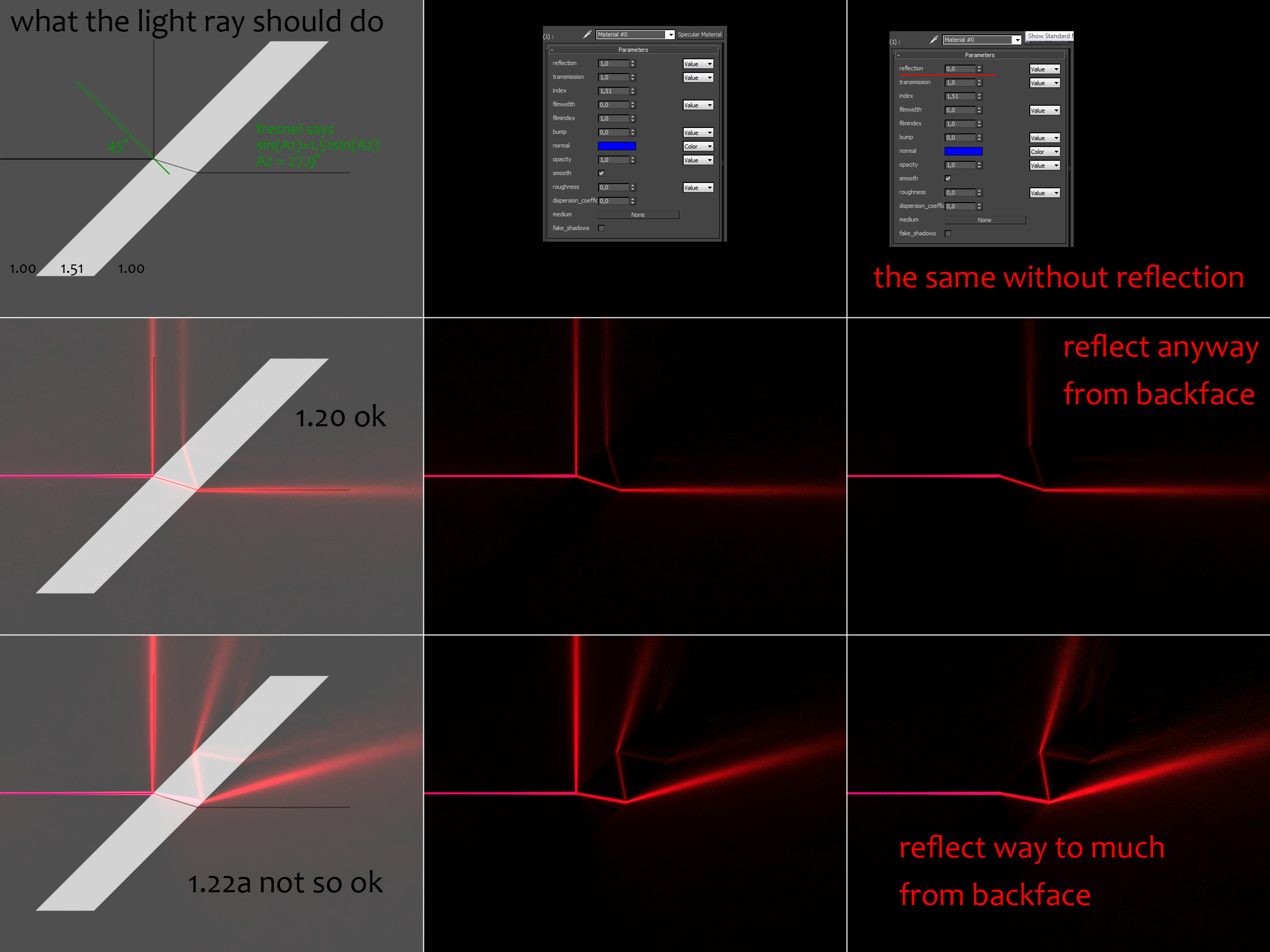

While playing with octane to test how specular materials react with light, I just found a bug with PMC caustics
http://render.otoy.com/forum/viewtopic.php?f=33&t=37578
Tested in 3dsmax 1.22a but I think the problem is the same with standalone.
1.20 is ok
1.22a is not.
Refraction is ok (same result for 1.2 and 1.22a in rendering a glass filled with liquid) but caustics are KO.
Another annoying point is that backface is reflecting way too much even if reflection is set to zero (the problem is also visible in rendering)
http://render.otoy.com/forum/viewtopic.php?f=25&t=37537
Meanwhile 1.22a is much faster (2.3x)
