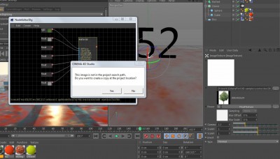

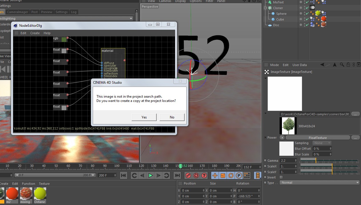

what is the plugin version? Windows or Mac?

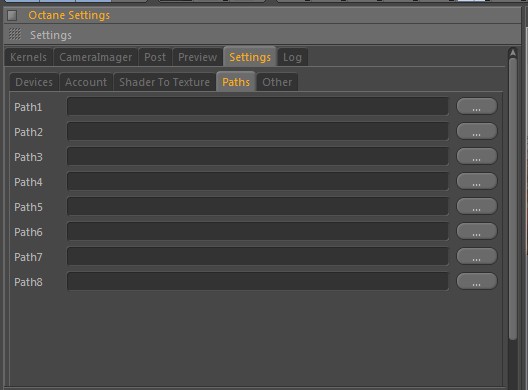

Normally it must ask to you as in picture. Also first picture is search paths. If you fill these, plugin will search in these locations if they not found.

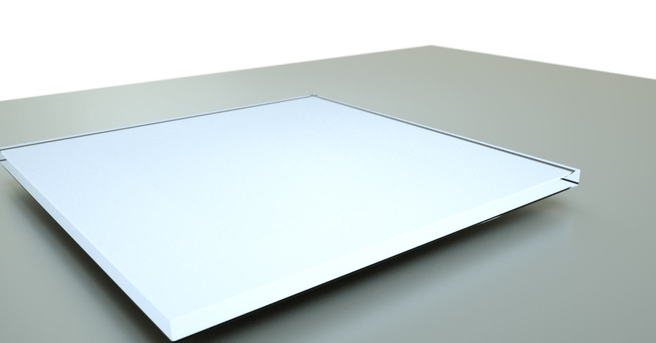

Hi aoktar,

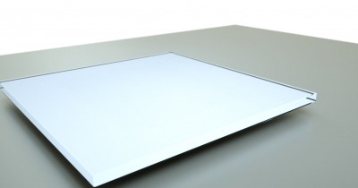

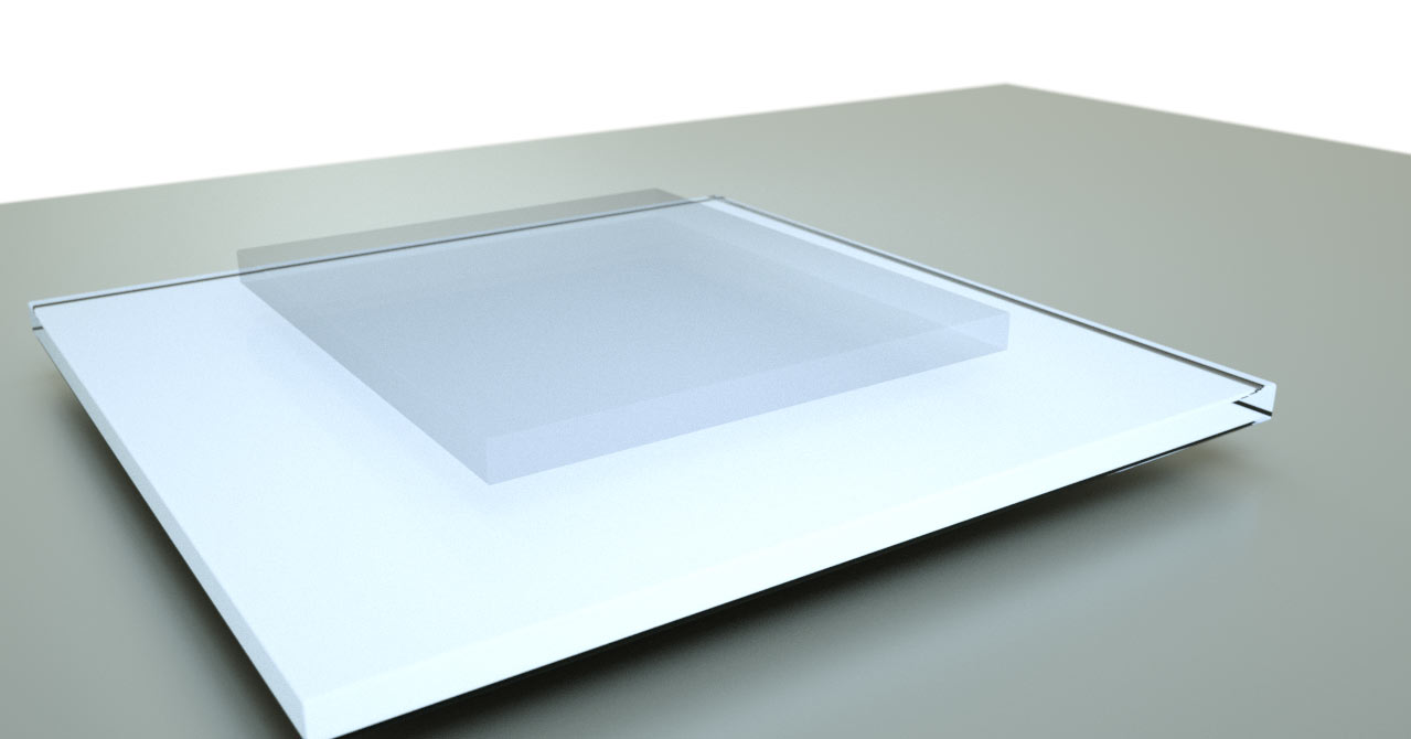

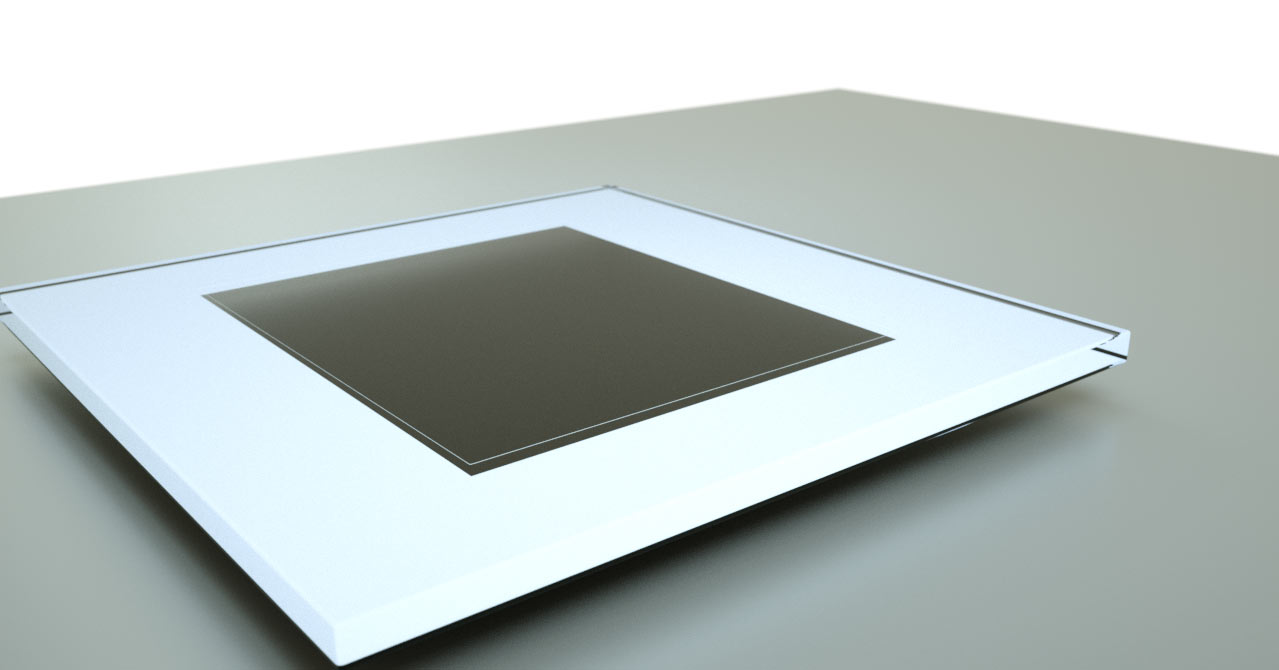

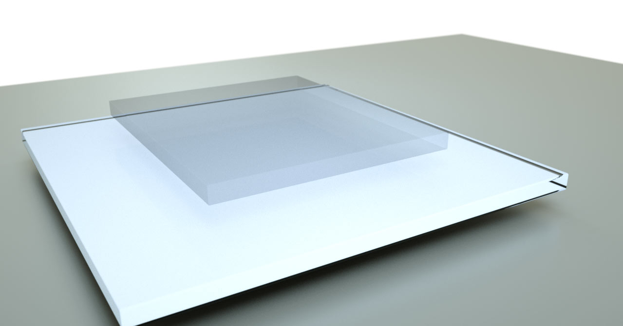

I prepared a simple scene to show the problem with the material problem when two objects move through each other.
I am not sure, whats the problem here and if it is related to octane.
The scene has a cube with glass material, a diffuse white plane inside the glass and a cube coming out of the glass. The problem happens on frame 680 (dark color or inverted?)... and it has to do with the plane inside the glass. If I disable it, the problem disappears. Animation runs from frame 675-725... and the material of the moving cube is animated (opacity 0-100%, don`t know, if this matters).
Here are some screenshots, and the scene file.
Frame680
Frame680
Frame681
Frame681
Frame710
Frame710
Frame725
Frame725
MaterialCubeSampleScene.zip
(352.35 KiB) Downloaded 280 times

aoktar wrote:what is the plugin version? Windows or Mac?
Same issue with textures here, but I think I got the point now (Win 7, Beta 0.7.2 SDK 1.2).
Because Cinema searches subfolders too, the images are probably shown. But they aren't calculated by Octane as long as the path isn't exact. Obviously, Octane does not scan all subfolders like Cinema. Or, it does, but only one time, so it does not ask. Later on then textures are 'gone', materials become white (here).
If typed in the exact path so Octane does not have to search any subfolders, anything works fine.

plugin looks the file is available at absolute path. if it's not a full path or not available, looks project path and tex folder. if still not found, search in octane texture paths. but not in c4d preferences paths.
I should know it can be related texture counts. or scene is saved or new file? can some peope capture a video to show problem?
