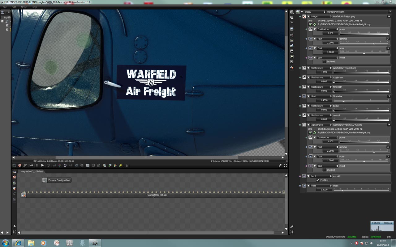

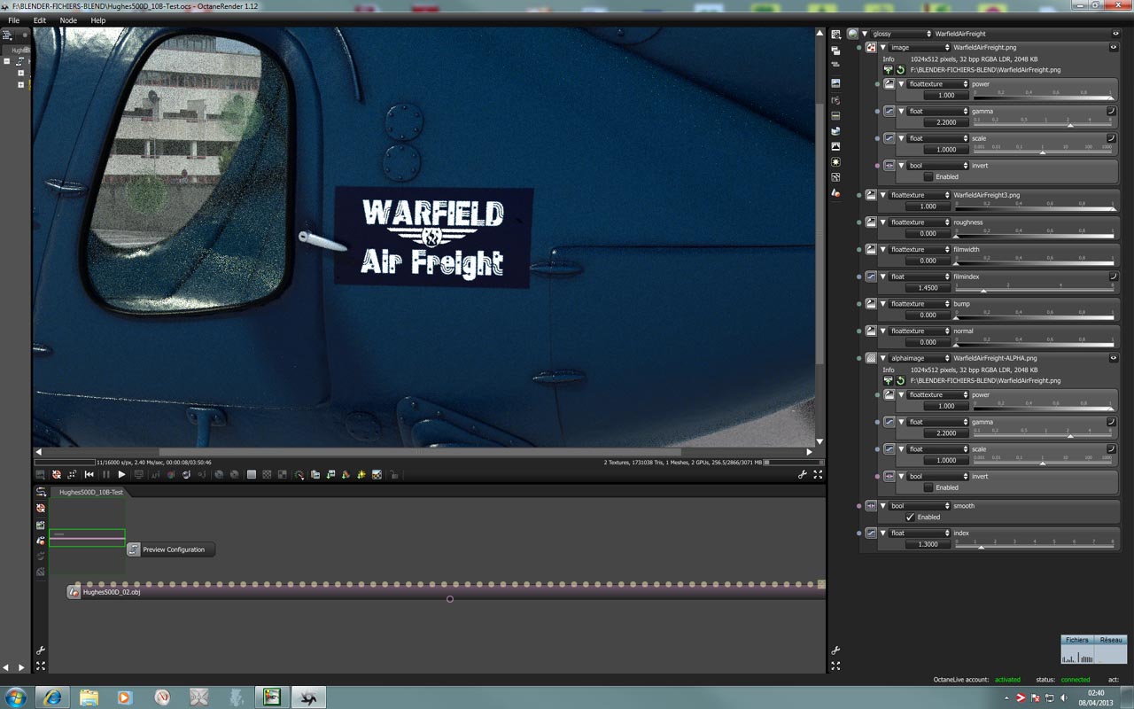

VERY IMPORTANT: I have just discovered that transparent shadow seems broken since Octane 1.11 !
Tested with 1.0, 1.10, 1.11 and 1.12. It works with 1.0 and 1.10.
On the example below, the white sticker "WARFIELD Air Freight" on the helicopter has transparent background (png). It is not mapped on the hull of the helicopter, but instead like a real sticker : Mapped on a slightly curved plane matching perfectly the surface and placed just 0.4 mm over the surface of the hull.
This method allows easy placing and replacing of stickers even on complicated topologies, and very practicle organisation of textures, and also allows various kinds of mapping (mix of UV and procedural). It is a good alternative on softwares not allowing several UV coordinates systems.
With exactly the same scene and settings, the transparent area of the sticker casts a shadow on the hull (rectangular dark area) with Octane 1.11 and 1.12.
First images shows the result (OK) with the scene(created with 1.12) opened in 1.10.
The lighting also looks different, but it is not the main problem.
It is a pity, I have to switch back to 1.10 to render with transparent shadows.
VERY annoying : a fix release would be welcome !

I think many changes touch some transparence and SSS trouble since v1.11 as you can see in my last TOPICSROUBAL wrote:VERY IMPORTANT: I have just discovered that transparent shadow seems broken since Octane 1.11 !
http://render.otoy.com/forum/viewtopic.php?f=33&t=30248

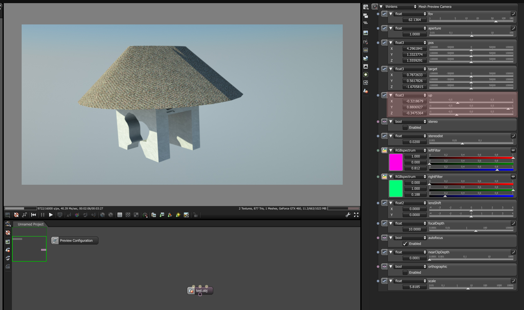

Possible bug report
1) If you assign a material from the online database and plug it into an object , then overwrite that material by dragging and dropping a new material onto the object in the Octane render window, it correctly overwrites the material, but the name of the previous material stays on the node.
2) Not sure if this ones in import bug or not but, if you create a 24 side tube in Sketchup and send it without a material into Octane , then assign a material in octane, the material smoothing works fine,If however you assign a material in Sketchup as a 'placeholder material' and then when that material is reassigned in Octane with a new material , the smoothing tick box will not work, you can still see 24 faces on the cylinder.
I hope the explanations above are clear, if not, please let me know.
addendum
Ok, I've narrowed down the smoothing problem.It appears that if you assign a material to grouped object in sketchup, that's when the smoothing will not work.
not sure of the reason why , but it just means you need to assign materials in exploded view only.
one last possible bug
In exporting a sketchup scene the camera up direction control is not aligned to 0,1,0 .I have noticed this in past versions, it's only now that i've gotten around to reporting it, just not sure if this is a bug or an export problem!
Please see screen grab
Cheers
Jaba
