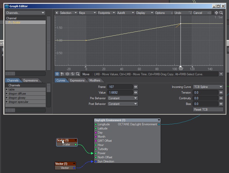

Is there anyway to animate target of focus to make "shifting focus" effect? I want to make a null and use it as the focus object and animate it to make shifting focus effect..

You only need to link a LW constant node to animate any render targer parameter unsing the constane "E" envelope.
-Juanjo

Working :)
