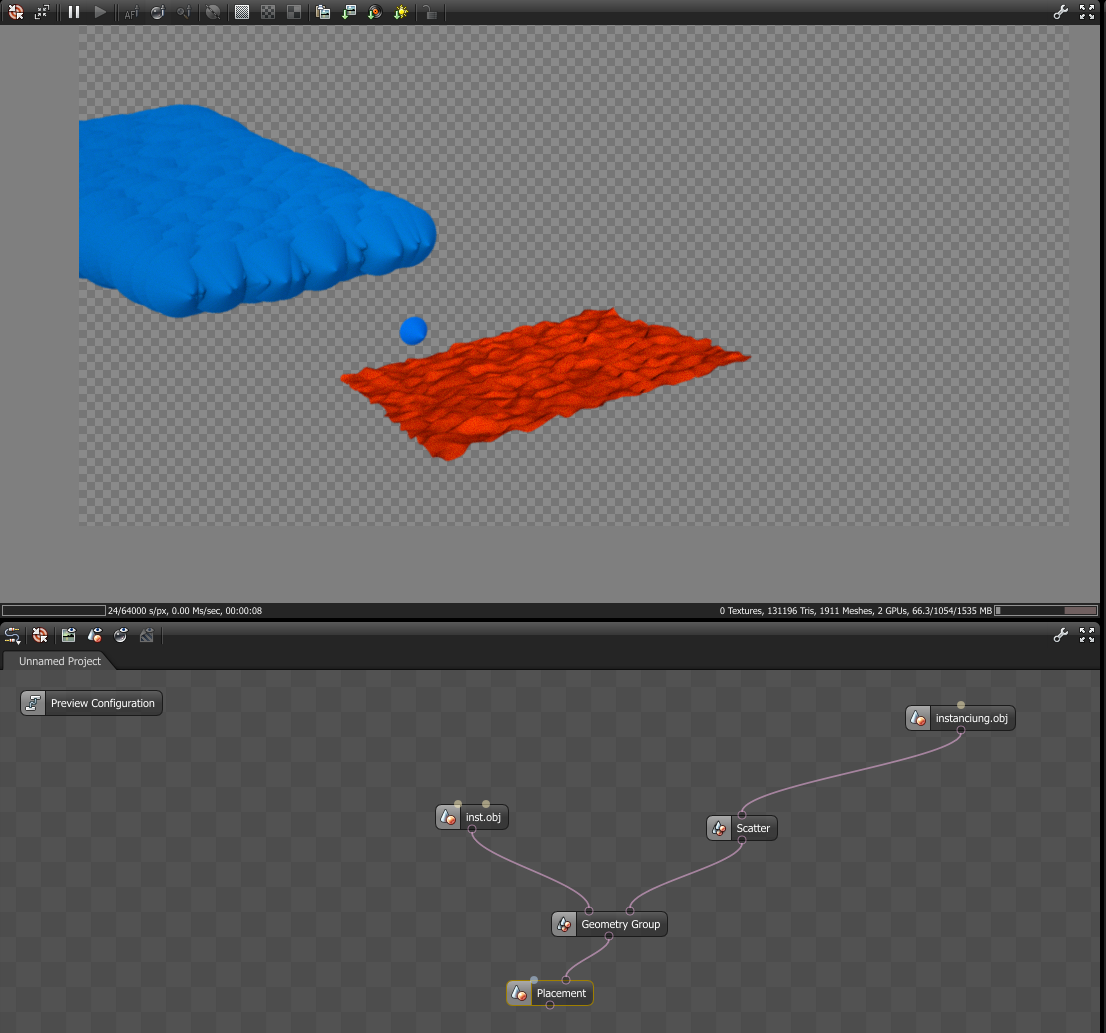

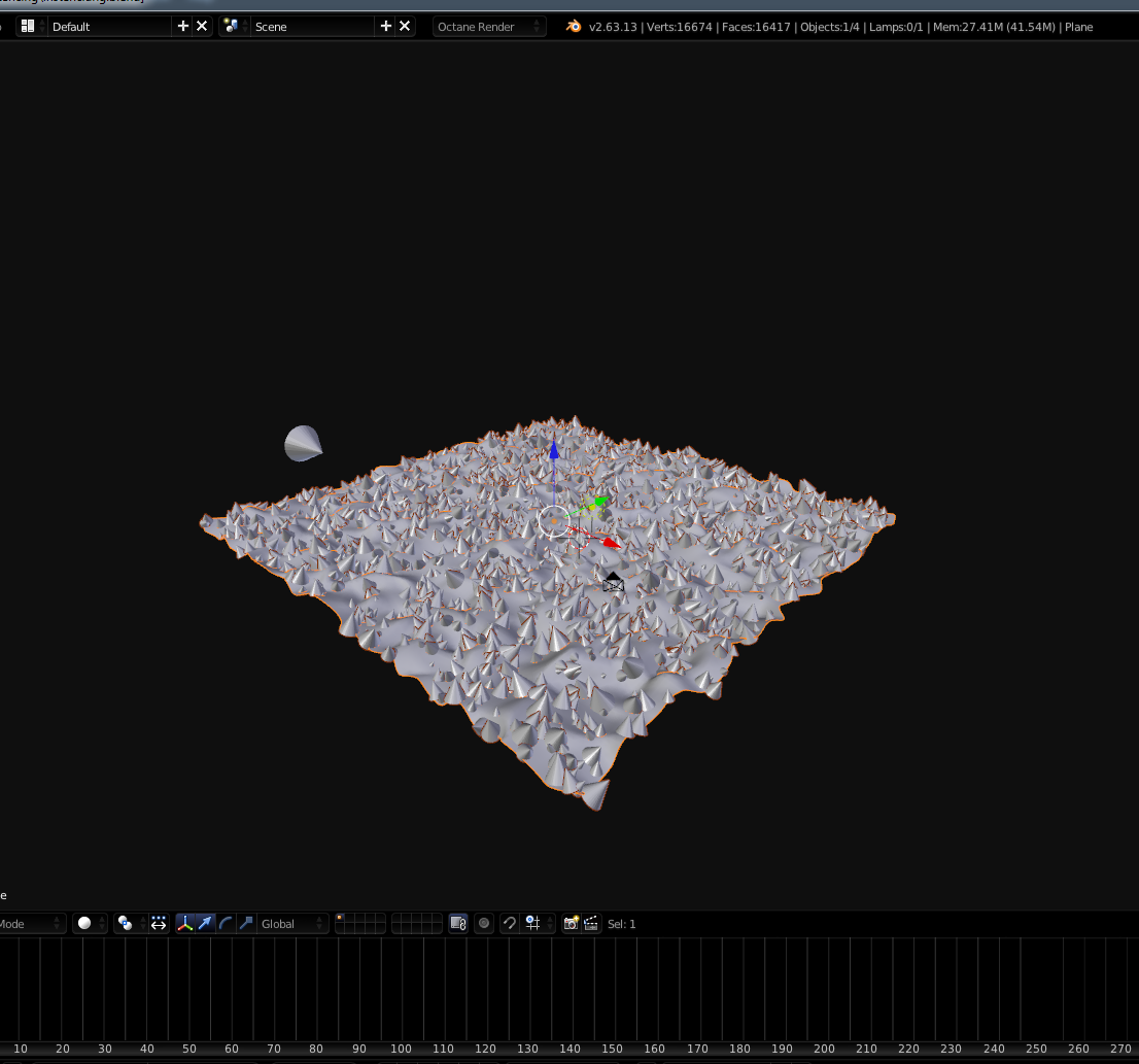

Any reason why this is happening?

radiant wrote:Any reason why this is happening?
I had something very similar happen yesterday. I assume it is because the objects are not working off of the same origin. I was just going out when I spotted it so I didn't have time to investigate fully.

I suppose the world origin is at the emitter center? Your cone dupli object does not appear at world origin in Octane (but translated like in Blender). Either: you did not use the latest version of the script or you didnt have enabled "write dupli objects to file", when you exported the transforms. This latter is required if you translate the dupli object away from world origin, because it corrects this translation back (if you manually export the dupli object, then you must correct it yourself)
Your rotations are also off, please read the guidelines & limitations on the first page.

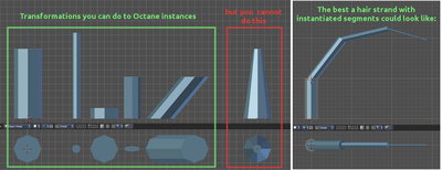

A few more thoughts about Blender strands & Octane instances.
The idea I talked about in my previous post on this subject (instantiated strand segments), would not be that great also because you usually want your hair to have a wider root and a thin tip. But you can do only affine transforms with Octane instances, so you cant "taper" an object. This is best explained with a picture:
A better solution for exporting strands would be to create the whole strand as geometry and then instantiate its children. If you have 1000 hairs with 100 children each, you would still save a lot of memory. Unfortunately there are two major problems that prevent this:
1.) Blender python API doesn't seem to expose the data needed for this (individual child transform). In the field of particles some things are still unfinished, it seems.
2.) Octane would need to have support for "scatter mesh groups". With the current implementation in the above example of 1000 parent hair strands, you would need 1000 scatter nodes to represent the whole system in Octane (which is clearly insane to do). If Octane would allow to export all the 1000 parent strands into one single mesh file, where each strand would get an ID, and then export the children transforms for all the parents into a single .csv file (again, assigning the ID to create a relation between the two), then it would be possible to match which child transforms apply to which mesh part in the mesh file and do the whole system with one scatter node.
tldr: currently its not possible to satisfactory instantiate hair strands.
