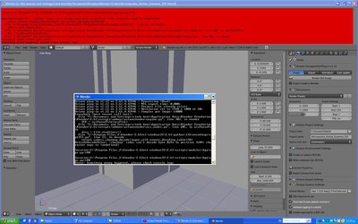

OK, thank you guys. I removed all Texturepathproblems but I still have this Error:
What means this Error ?
Kind regards
Alain

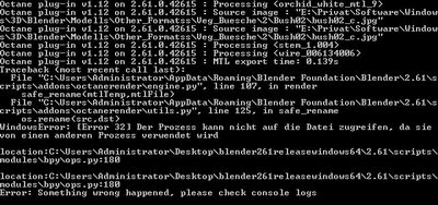

[Unsupported] Blender plugin v1.12
it seems that the temporary mtl file is already in use at the moment you're trying to export. The plugin first creates the mtl and obj files using temporary names (so during an animation the next frame can be exported while the current one is rendered) and then rename them to the proper names.
It's a bit strange as the newly created temporary mtl file cannot be in use at this time and the destination should already have been removed 2 lines earlier... I can hardly imagine what's happening here.
Please remove existing obj and mtl files and try again.

My work flow was :
1: edit on blender
2: Render still image
3: work on Octane
4: save Octane scene
5: Close octane
6: goto 1
Untill I did a UV map (I had already some UV on my scene when it worked)
and now it says this :
I tried deleting mtl and obj but it does work...
If I bypass the export do just the obj export on blender instead of the "render still imager"
the file works on Octane BUT... then step 4 cannot be done! It sais something about permission...
Thank you for caring blender mate!

Possibly there is an image/name/path somewhere that contains a non Latin letter, something like a ç
Look at the last UV map you did before it broke.

I am reading your console about the unicode decode issue.
I supposed there would be an unusual character there somewhere....
Good luck with it.
Good luck with it.

byte '0x9a' definitely means one of the files contains a non-ascii character. It is apparently using windows-1253, which is the Greek windows code page. '0x9a' is indeed not a valid value in this code page. You will need to find out what file it's trying to read, and either convert this to windows-1253 or remove the character.
Roeland
Roeland
it is reading the ocs file. Please post a copy so I can check where is the wrong character.
