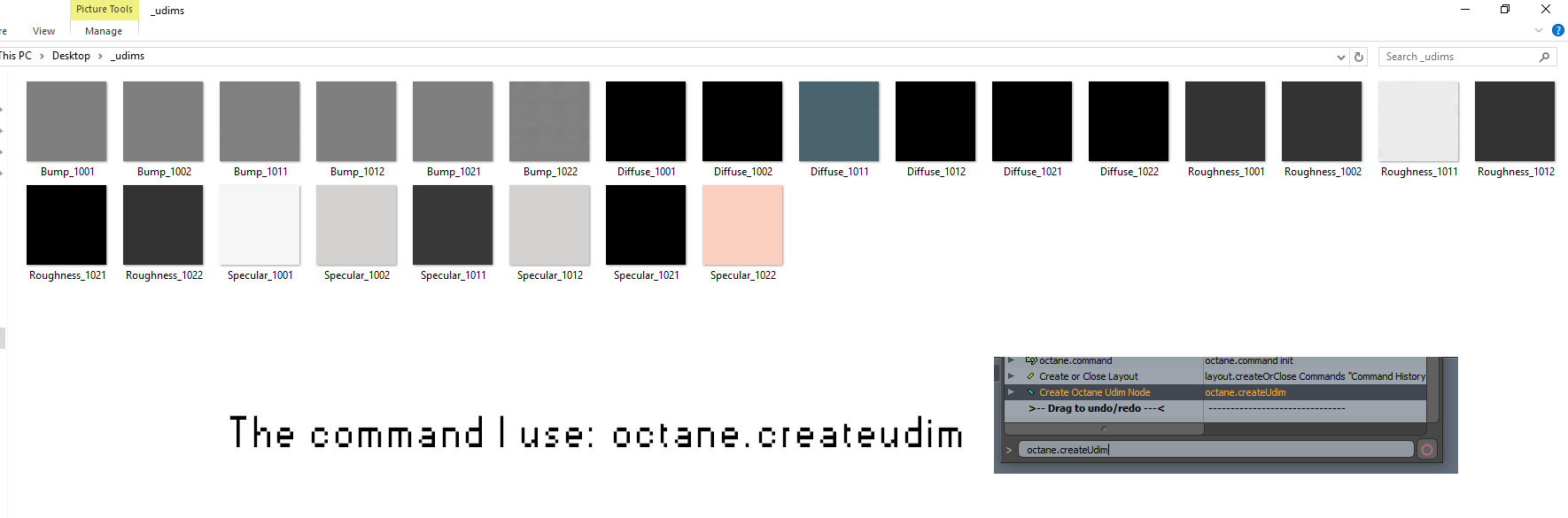

v1adut
Posts: 154
Joined: Sun May 30, 2010 4:27 pm
face_off wrote:
the naming was like this: objectName_bump_1001.png
Can you post a screenshot of the folder holding the files and the command you used to create the UDIM in the plugin pls?
Paul
Hi Paul, I made the screen shots.
face_off
Posts: 15809
Location: Adelaide, Australia
Is it possible you are selecting both Bump*.png and Diffuse*png (or Specular, etc)? When using the octane.createUdim command, all the selected files need to be the same prefix.
