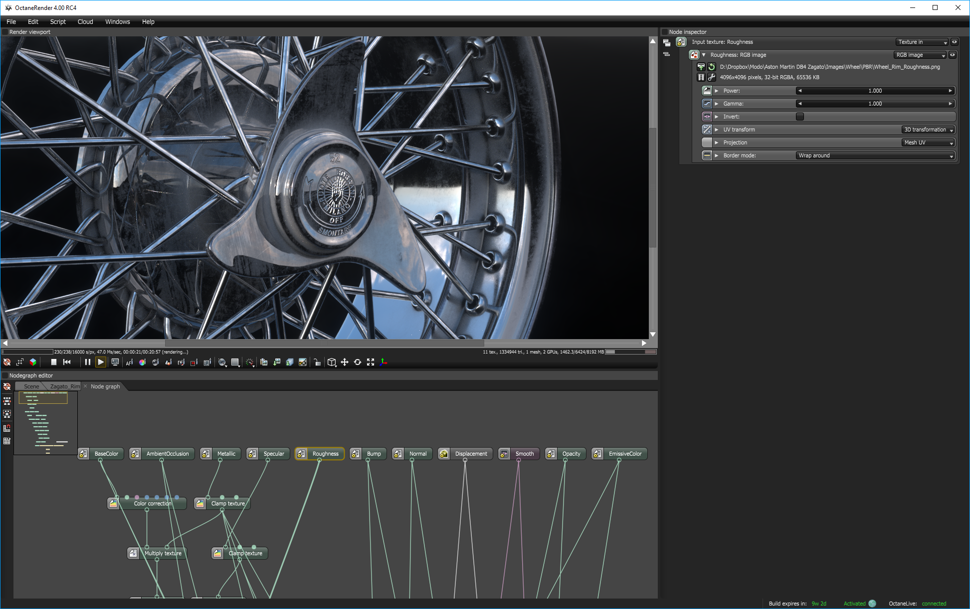

Thanks I had forgotten about the showNodeGraph command. I've been off Octane for a while using Vray but I thought it was time to have a look at what's new since I last used it over a year ago.
If I set the roughness texture to 2.2 in the shader tree it seems to match the Modo render. That gives me a gamma of 1 in the node graph. The base color on the other hand looks correct at gamma 1 in the shader tree.
Is it correct that I should set the roughness to 2.2 in the shader tree to get the correct conversion? Does this also apply to the metallic texture?
It is possible the shader material is not picking up the color space of your scene correctly. So I suggest seeing if changing the Scene->Default colorspaces fixes the issue. Making changes to the Unreal material would be what difficult now, and in the medium-term it is better to replace it with the new Octane Universal material.
Paul

No worries. I eyeballed it to match my Vray render by adjusting the roughness gamma.
