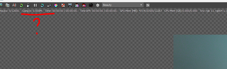

In this version samp/s stays at 0 in octane preview sometimes
We think motion blur somewhere is causing it. As soon as it is off it works
