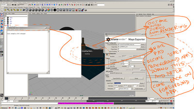

Ok Marcus, i tried your explanation for the motion blur and it's working, thanks.
For the 'pop up' while anim rendering, i join a picture.
The context is:
- I launch an anim with Maya/octane ( but there is same issue with lightwave )
- i launch for example notepad to write a text during the anim. computing with octane.
Each time Octane begins a new frame , there is the popup window of the 'octane-scene-initialisation' ( importing, parsing, voxelising etc...) appearing and becoming the foreground app.
After this phase, during the real octane computing, my notepad becomes again the forground app ( automatically, without clicking on it, which is great....).
The more the scene is complex to prepare ( polys number ) and the more the time to wait for using notepad again is big...
The question is: is it possible to make this 'octane-scene-initialisation' phase on backround app. too so that there is absolutly no break on the notepad workflow... ?
Anyway, as i said before, the situation is actually a lot better with this 2.49b solution for animation computing.
thanx

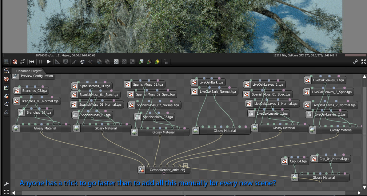

Thanks for everything!
But now please, allow us to work faster with shortcuts to create nodes and add the possibility to duplicate them! [...] aaaw that would be wonderful ! (Love!)
And maybe also add the possibility to retrieve and edit materials within the scene directly inside the node system ! [...] without having to recreate everything from scratch [...] aaaw that would be awesome ! (Love!)
I know you know! But I couldn't help!
Thanks again for building Octane!

@retmia
+1 for me too :)

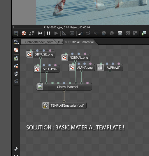

@Rickky
I've just had a little idea to make the waiting for a more intuitive node system easier [...] you just create a Material Macro where you put all the things you often need in it, and save it [...] so now you load it in two clicks and you just saved at least twelve clicks plus mouse moves! :mrgreen: you gain around 30s+ per material! ^^ Well you still have to put the right maps in it, but its quicker!
And about the material encapsulation, I'm on the well organised folders side :) it's more flexible.
