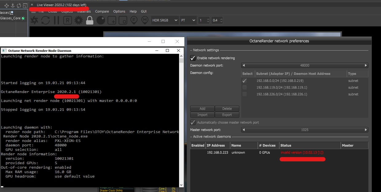

I have an invalid version message with my network nodes with plugin R2.
viewtopic.php?f=85&t=77169
viewtopic.php?f=24&t=77111
Plugin and nodes not matching for me.
Only on my side ?

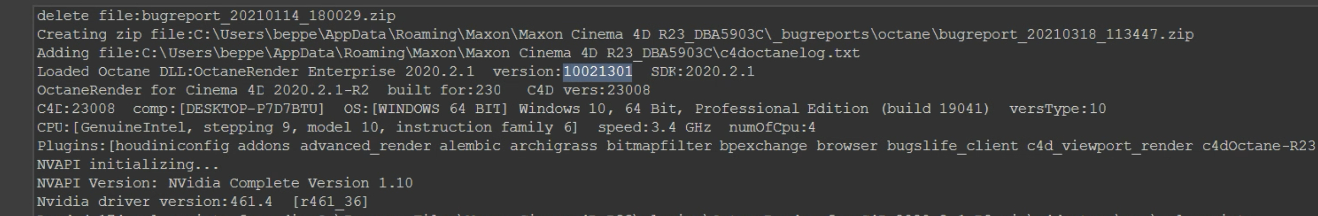

please press SHIFT+F10 and share a screenshot: Net render is working as expected here with 2020.2.1-R2. Looking forward for your feedback,

Apologies for the inconvenience, it's all my fault, I got stuck in the versionsbepeg4d wrote:Hi,
ciao Beppe
There are days like that
Thank you, Beppe, for pointing me in the right direction.

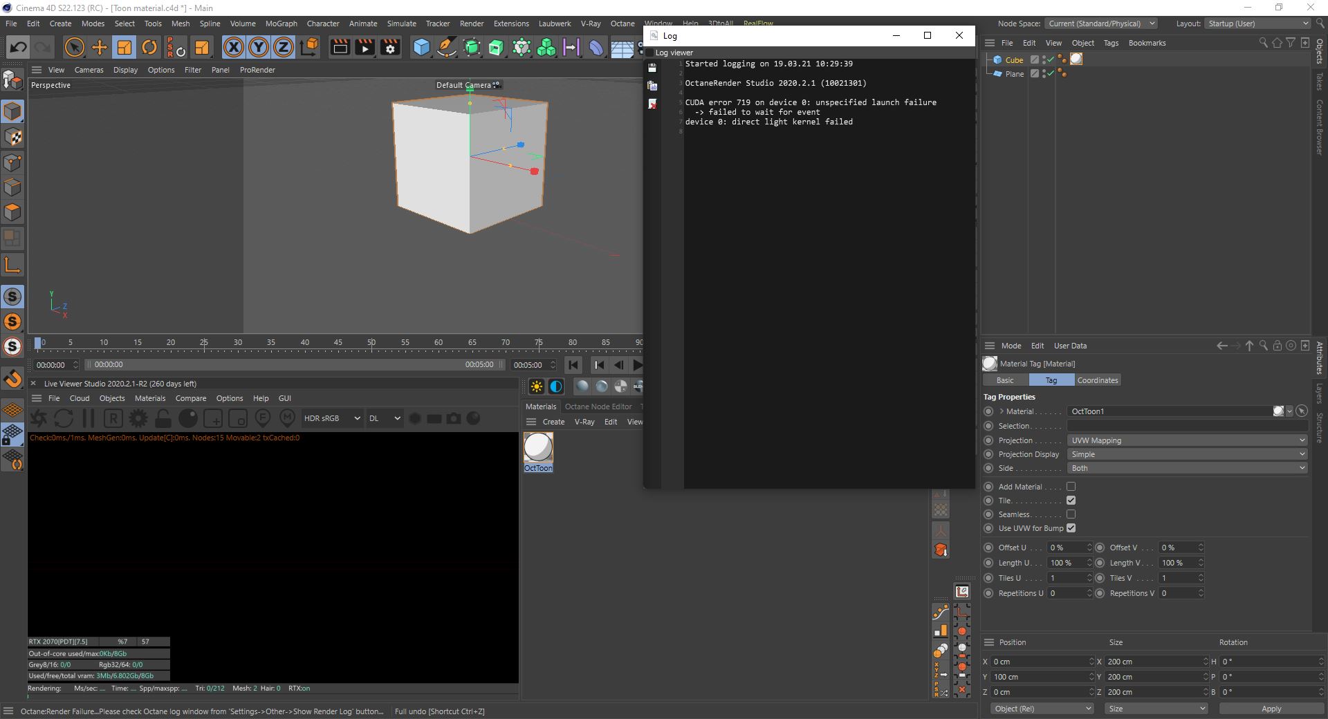

I have still the problem with the toon material on the R2 update. CUDA Error 719 when i lauch de LV.
I use :
- C4D S22.123
- Octane 2020.2.1 R2
- Octane standalone 2020.2.1
- Nvidia driver 461.92 ( I tried with the previous one before too )
- GPU RTX 2070 (notebook)
Here attached screenshot on simple project with a plane and a cube with the toon material with the c4d project if that help .

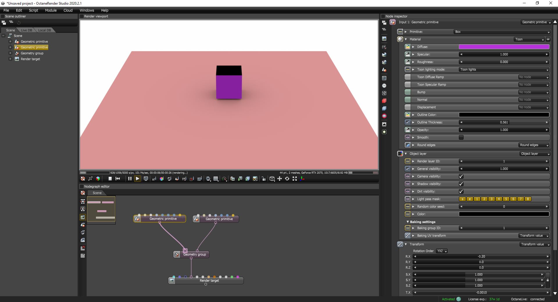

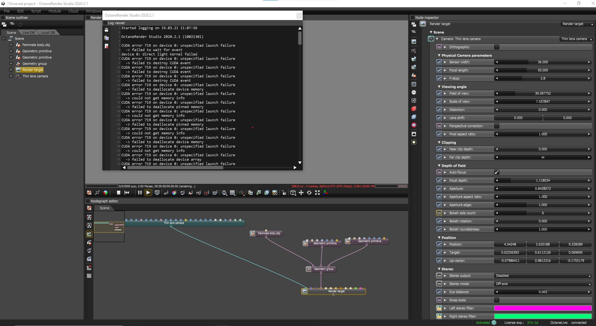

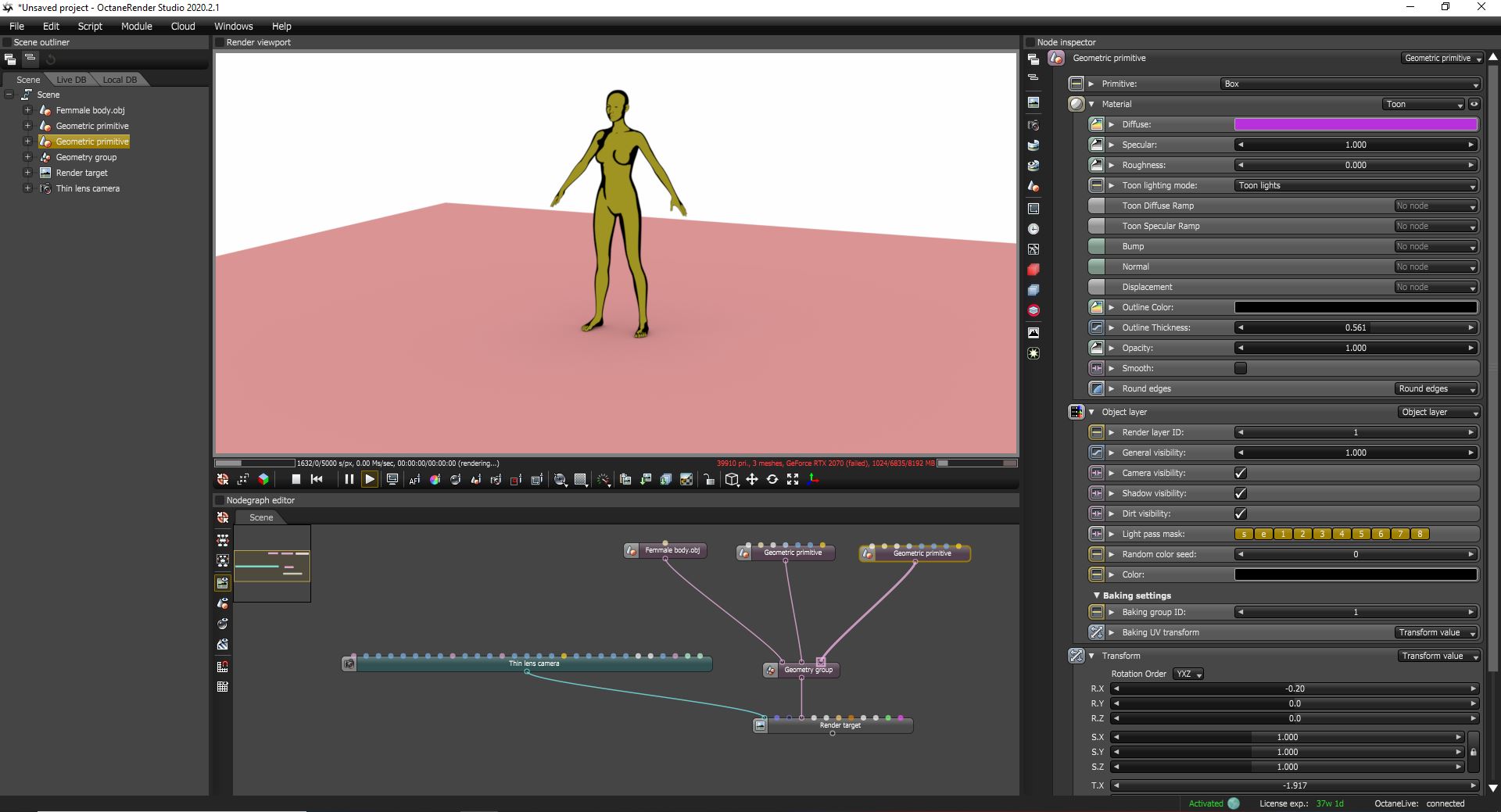

After some test i see it's the same on Octane Standalone but if i put on the scene an second object with an other material, diffuse for exemple, that's work.
But if i put an third object again with a second material toon, that's crash again.
It's the same thing on standalone and plugin.
Hope this can help you

Ok i find a temporary solution for toon material.
If you put an environment texture with nothing to simulate black environment, toon shader work normaly.
For the moment octane don't crash anymore.
Other point :
The parameter "power" of the toon point light don't work. i have the same intensity whatever the values.
On the other hand, the directional light "power" work normaly.

@ pxlntwrk: you are welcome
@ Romano: thanks for sharing the workaround!
We need to have this fixed in the general SDK, and the core devs should have already found and fixed the issue for 2020.2.2 SDK.

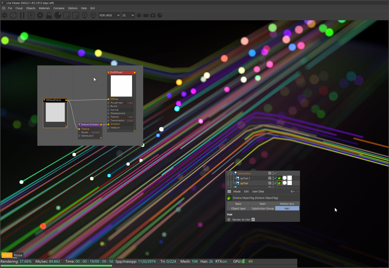

COOL!aoktar wrote:New update (2020.2.1-R3) is available with the same CORE(2020.2.1). First extended support for xpTrails colors that's included. Enjoy it!
