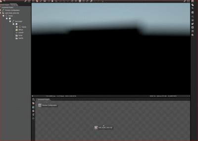

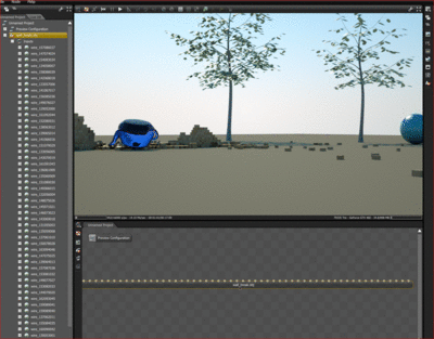

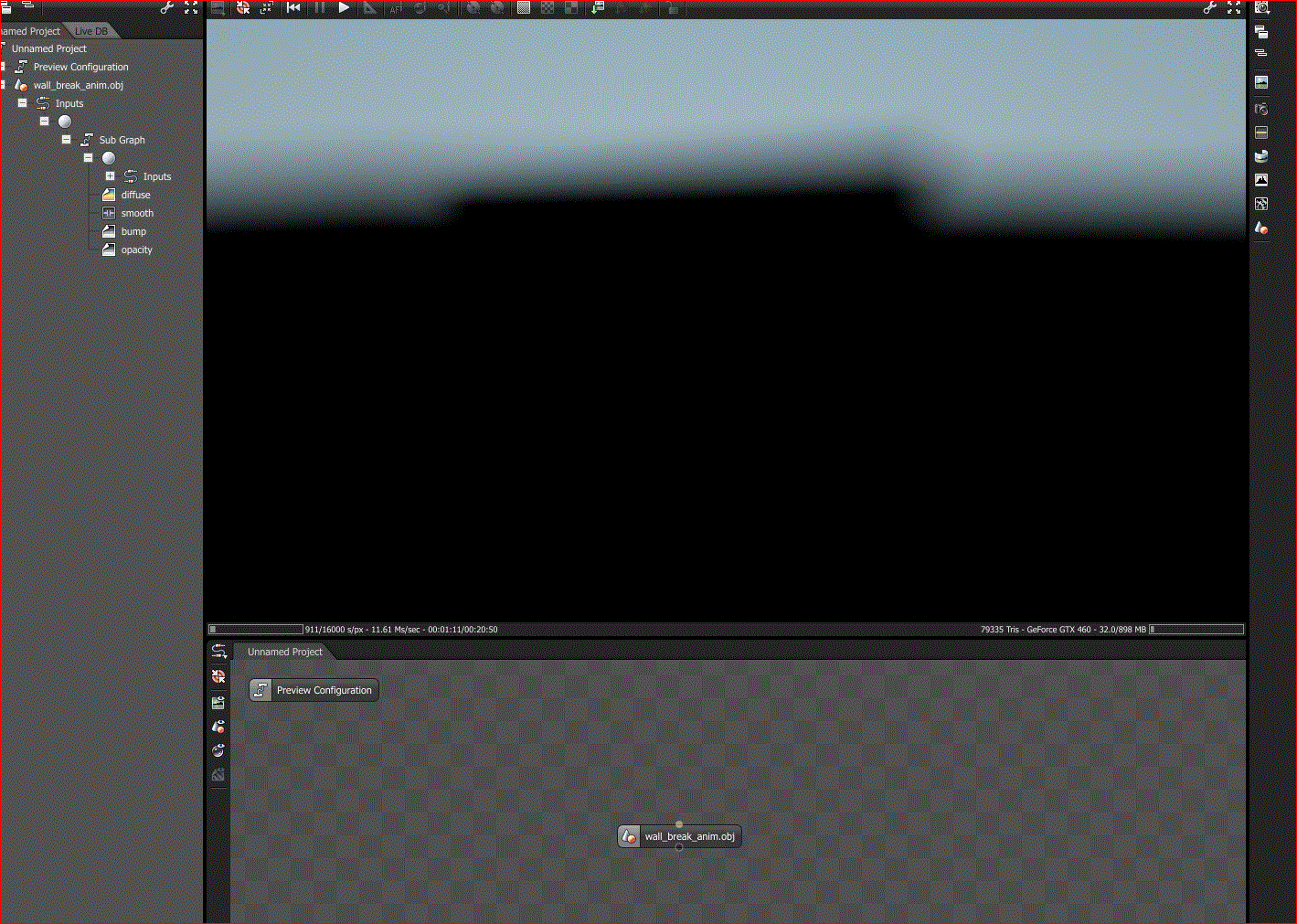

anyways.tried V1.36.
The Good news.
It runs and exports everything fine.
It exports all the meshes and materials on single frames fine.
However it still only exports one mesh and no materials in animations mode.
see the attached screen grabs.
not sure if V1.37 will help with this ?

Jaberwocky wrote:However it still only exports one mesh and no materials in animations mode.
What version of Octane you use?
I remember that some version has problems with "relinking" from command line.. I think in this direction yet...
Look at .bat file: there is the FIRST run with creating .ocs (command line switches "-n" and "-l"), and all subsequent runs of Octane has switches "-r" and already existing .ocs given in command line. So, it is command to Octane to get an existing project (.ocs file) and "relink" to node "blabla_anim.obj" new .obj file (with new .mtl file)... And I think that in THAT stage something gets wrong... Not in MaxOctaner - it produces a right .bat file with right commands (or not?)...
Just my thinking... I will try to play with animation later, but now Mary uses Octane on her computer (makes her work), so I can't test it with Octane right now...

I'm using the latest version 2.49 beta.Did you want me to try it with an earlier version of octane on my scene to see if it works?

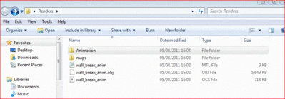

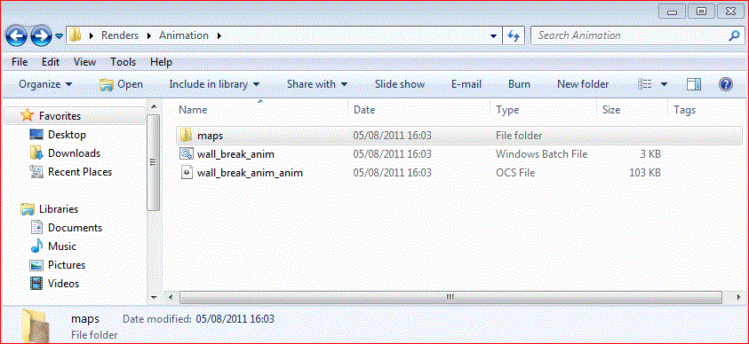

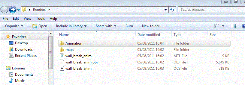

I had a chance to try 1.37.
I think i see the problem with the animation not working
take a look at the 2 directory snapshots after a single frame render which renders correctly and the animation which does not.
As you can see.A single frame export generates the correct MTL , OCS & OBJ files.The Octane .OCS file needs to referance the .OBJ file for the mesh and the .MTL file to reference the materials.
Now take a look at the animation directory automatically produced by the export program
It has the Octane .OCS file as well as the windows .bat file to run and produce the frames.
it does not though have the associated .obj file to reference the mesh and the .mtl file for the materials.
that is why it's not exporting correctly.

I think you do not see .obj/.mtl files for another reason - they are deleted automatically after render... I have them all generated OK.
But I found a bug just now, will post a new version, perhaps this can fix this troble. This bug has born from my unfamiliarity with .obj files structure. In versions inclusive 1.38, in batch animation, when a next step begin, both files are copied to name "blabla_anim.*" from "blabla_100001.*" - .obj and .mtl. BUT .obj file contains link inside to "blabla_100001.mtl, so .mtl file must NOT be copied"! It is my bug, and perhaps it can be reason of your problems too...
But this bug will expose itself ONLY if you have "Keep animation cache" checkbox NOT set. If set - it is no matter.
Will fix it in a few minutes in 1.39.
