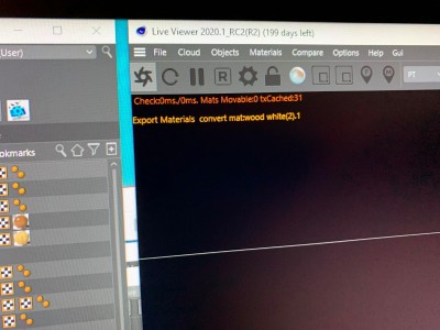

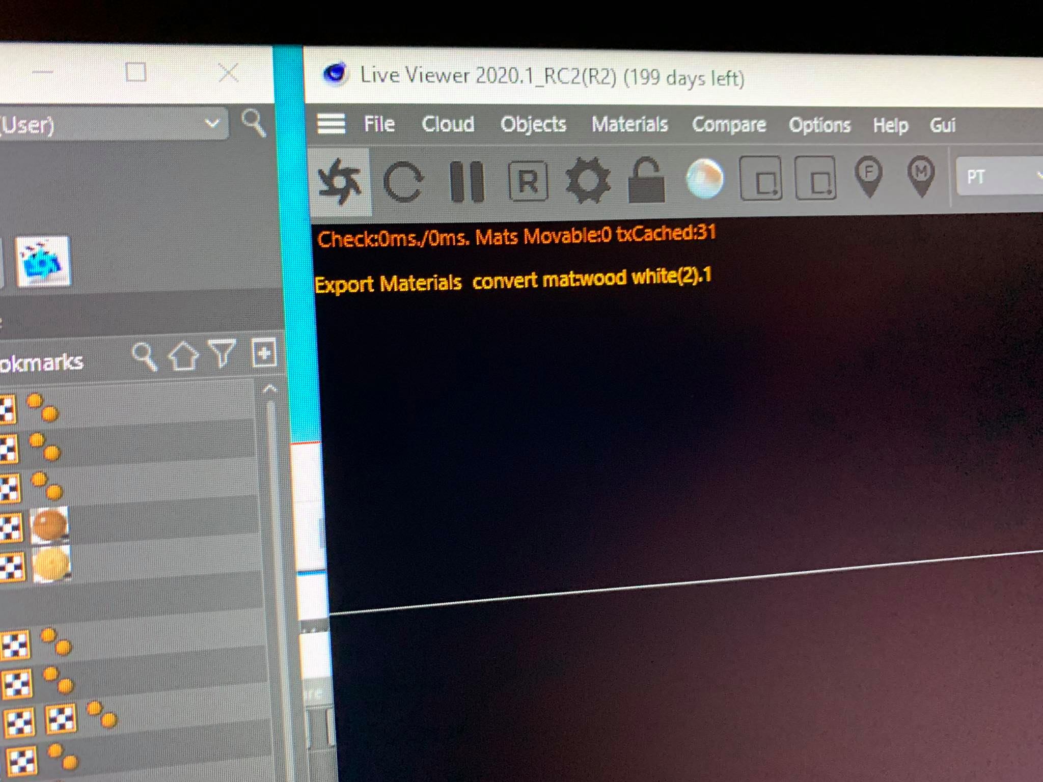

I noticed that Octane Live Viewer window is "blinking" while rotating or moving view when mouse pointer is located in LV window. When mouse is outside LV window and rotating or moving view is done in C4D perspective viewport it works fine without "blinking". This "blinking" looks like for one frame LV camera is reseting it zoom. It is related to previous Octane versions too.

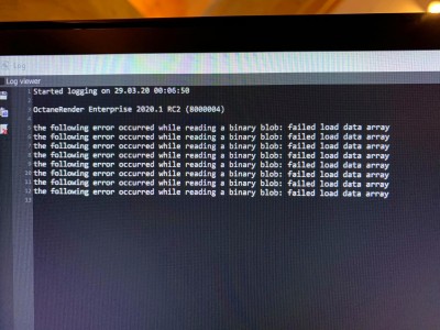

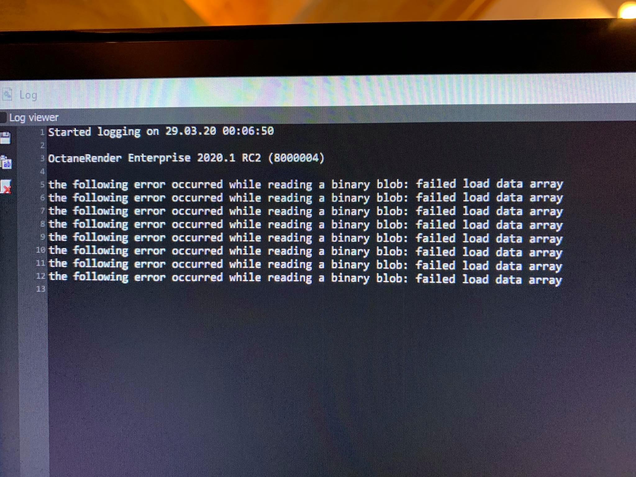

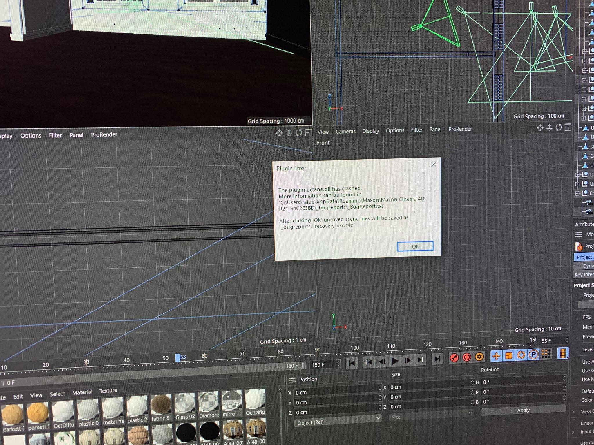

So when I open the scene and start octane render I get this errors:
The octanelogs shows this:

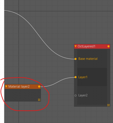

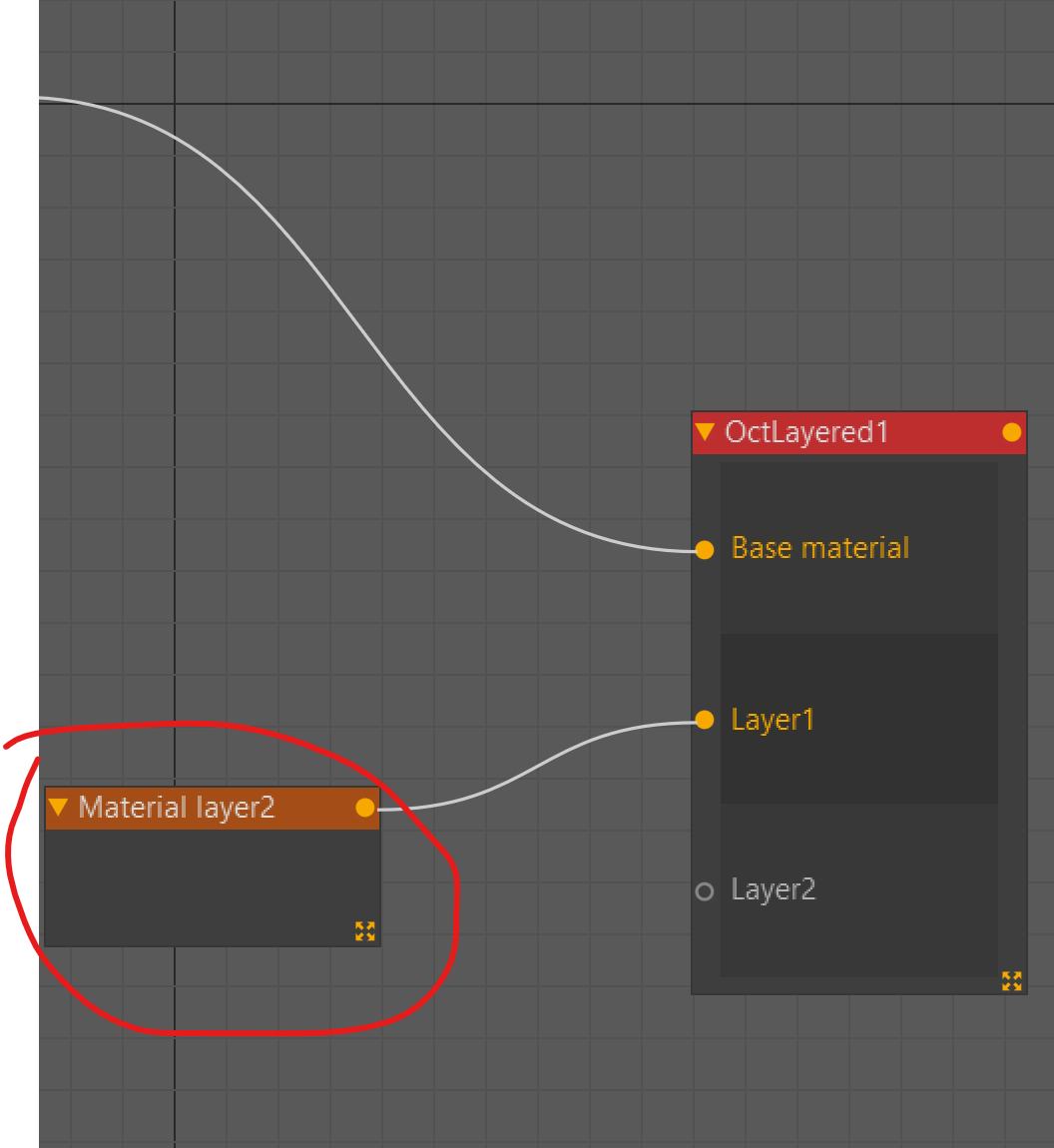

Hi all,
a few questions:
1) Is random walk SSS implemented in any other material types except the basic diffuse material? On every other material type (universal, layered, etc.) the node does nothing, but in the diffuse material I can see it at work. Is there something I'm doing wrong?
2) The composite material is crashing C4D as soon as I drop an image texture in it. Tried reinstalling drivers to no avail.
3) When I try to add a Layer Group into my Layered material, the node appears empty with no slots, like in the picture below.

2- I don't support that's related to drivers. How did you connect imagetexture to composite material?feels wrote:Hi all,

3- Try this buttons
Thanks aoktar, a solution to the first problem above is this:aoktar wrote:2- I don't support that's related to drivers. How did you connect imagetexture to composite material?feels wrote:Hi all,

3- Try this buttons
- If I drag the RandomWalk node from the list of nodes on the left side of the node editor and plug it into the Medium, nothing happens.
- If I click on "RandomWalk" button inside the Medium slot while it's empty, and plug new nodes into it, it works.
Figured you wanted to know.
Thanks for the tip for 3), totally missed that option.
Cheers
