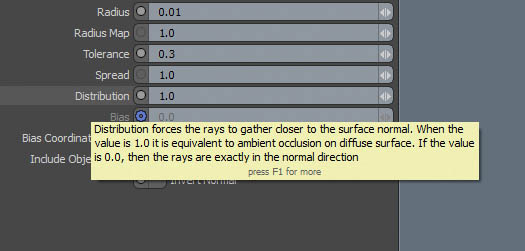

Hesekiel2517
Posts: 467
Joined: Mon Nov 23, 2015 10:57 pm
The Text says this value in the Dirtnode can be 0.0 but the minimum is 1.0

face_off
Posts: 15822
Location: Adelaide, Australia
This is an Octane engine issue - which I will report to OTOY.
