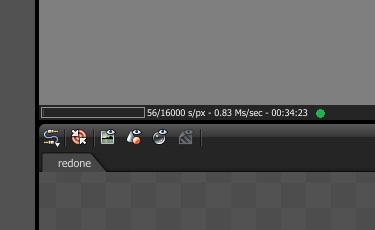

Perhaps there should be a slider to set the screen refresh time? 1 - 100s :roll:
>indications that Octane is actually rendering.
How about my mini traffic light idea?
edit: added some pics. 1 issue cant reproduce atm -sorry :cry:
staus indicator
staus indicator
traffic light.jpg (10.57 KiB) Viewed 2659 times

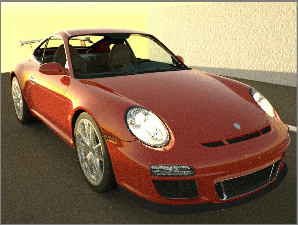

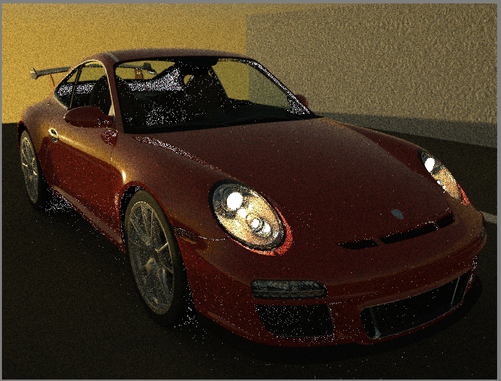

the naked car - not what portal is for though ;)

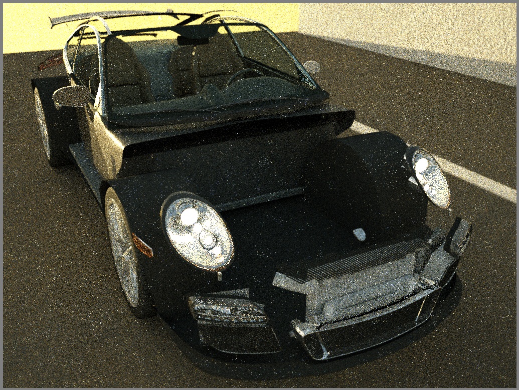

something odd here - got darker and darker -  cant reproduce atm
as usual no issue
as usual no issue

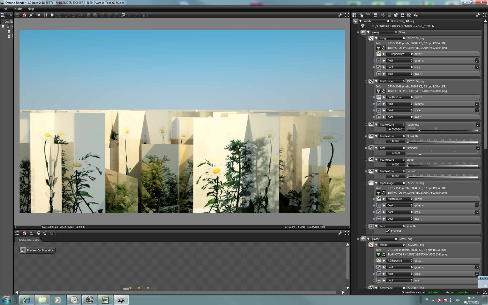

New tests :

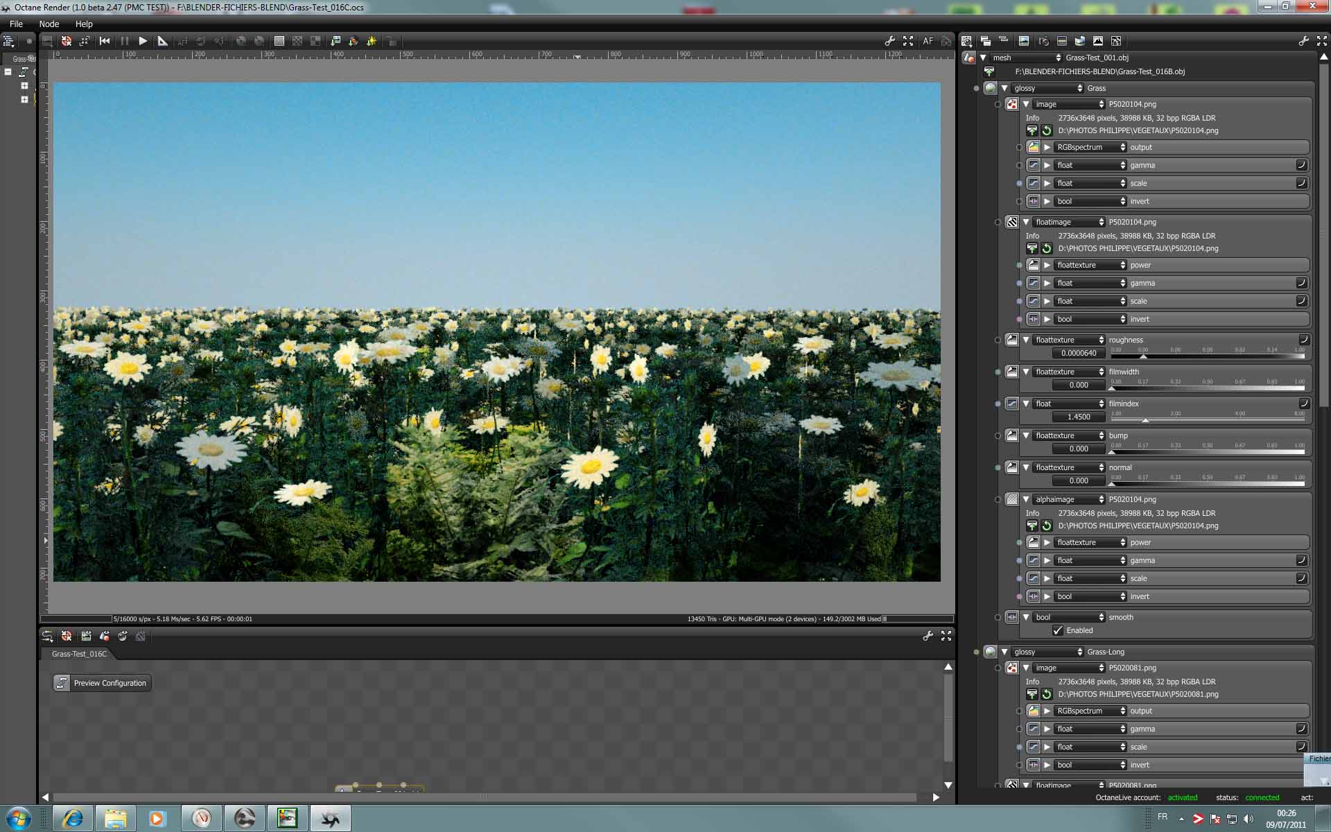

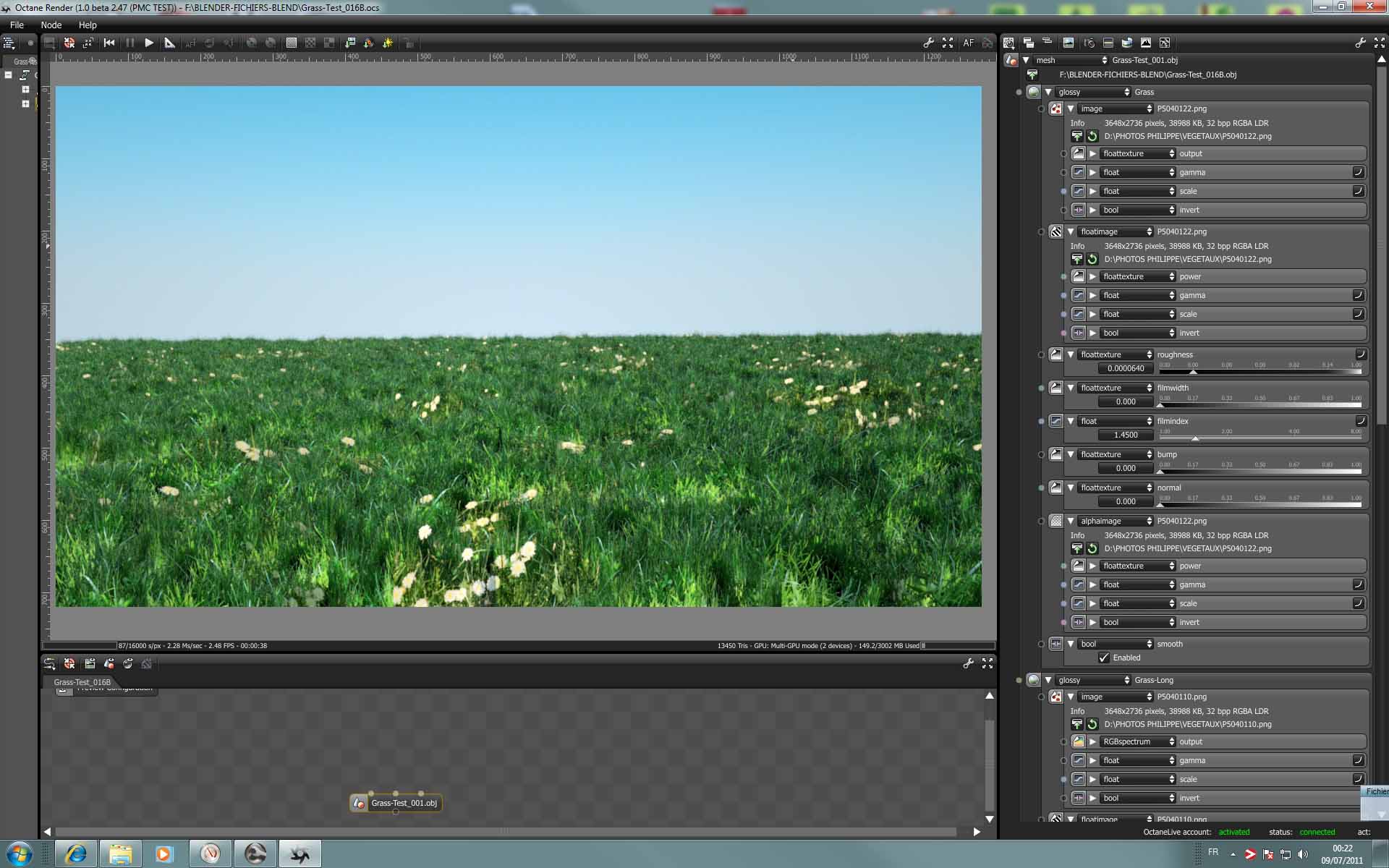

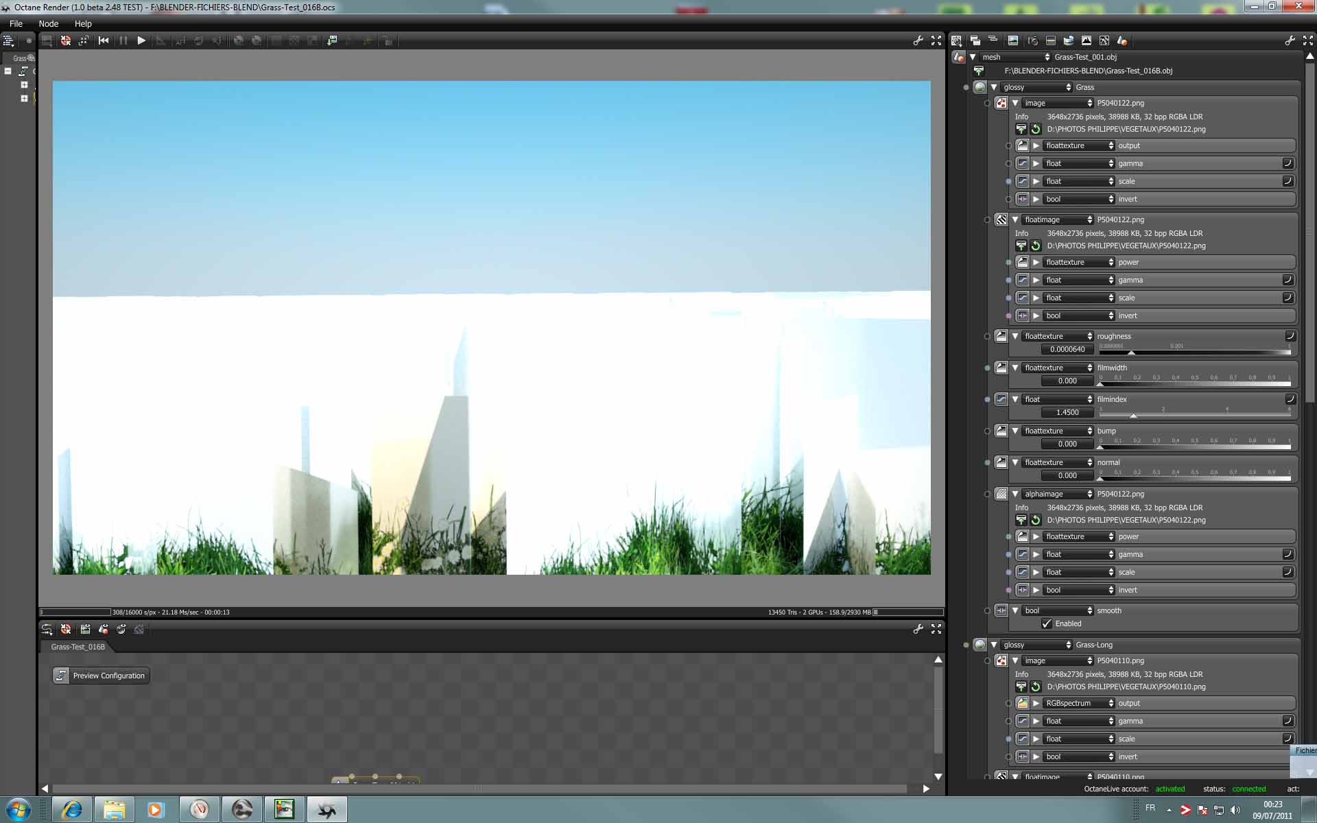

- png Alpha images don't work : No transparency in transparent areas (Checked with paths tracing and PMC). Very annoying bug, because no transparencies brings us back in the very early age of Octane and means Not usable ! Please look at the renderedimages below.
- Loaded a big scene (8.7 Millions faces triangles) and attempted to relink a scene of around same weight with modified geometry : in 2.47 test it relinked with missing objects and broken materials. In 2.48 test it crashes Octane at the end of relink process. :roll:
For the memory amount displayed, according to what displays EVGA Precision monitoring software, it looks +/- correct : EVGA Precision displays an amount of 160-208 (fork of values seen with various scenes)used on each GPU even when idle. I got with a big scene 2400/2872 on my 3GB cards.
Grass field<br />Alphaimages don't work
Grass field
Grass field
Grass field
Flowers field<br />Alphaimages don't work
Flowers field
Flowers field
Flowers field
