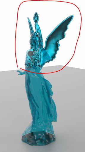

wallace wrote:By the way, can you send me your scene with the thin wall problem? I think there's an issue with GGX + thin wall, but would just like your scene to confirm my guess and to verify the fix.
It's not the exact same scene in my screenshot. I had to recreate it and poly reduce the object.
It just seems to be the environment image being refracted in an unexpected way. I just thought it looked odd/incorrect compared to having thin wall disabled.
Select the LUCY nodegraph to see the material
lucy-dec1-003_thin_wall.zip
(678.9 KiB) Downloaded 208 times

funk wrote: It's not the exact same scene in my screenshot. I had to recreate it and poly reduce the object.
Thanks, I can confirm this will be fixed in the next revision.

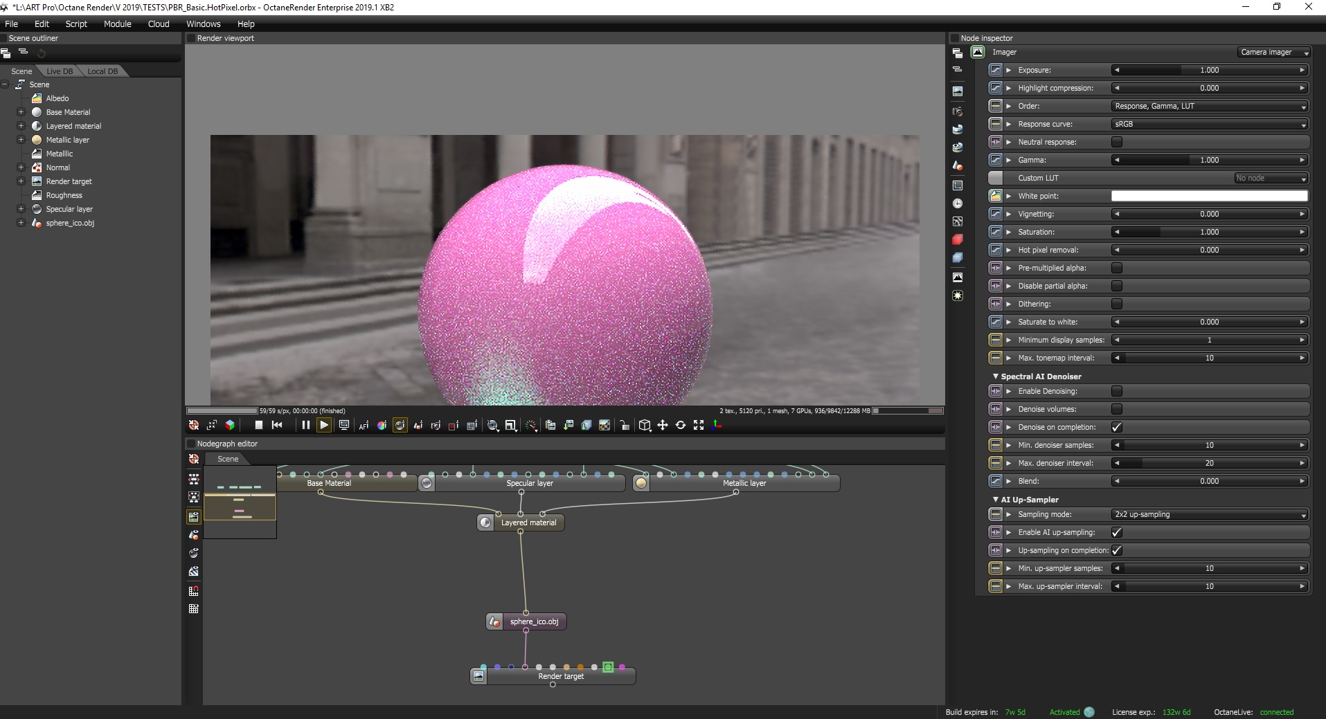

Here you go:
PBR_Basic.HotPixel.orbx
(14.96 MiB) Downloaded 279 times
It is very simple, uses Path Tracing, Transmission, and low sample target to make it more obvious.
When no-sampling or sub-sampling, Hot Pixel slider affects the scene, reducing the hot pixels.
When up-sampling, Hot Pixel slider does not affect the scene, the hot pixels are not affected at all.
One can, yes, increase sample amount to make it a moot point, since hot pixels ultimately render away.
But ideally would like to see it work with up-sampling to maximize the awesome speed benefit.
THX!!!
