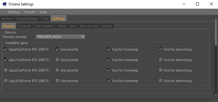

With this version I seem to be unable to render with all four of my GPUs, I'm only able to render with two of them - I have the subscription.
When checking the boxes in the settings on my third and fourth GPU, nothing seems to happen, and when re-opening the settings dialogue again, they remain unchecked.

Currently running NVIDIA "Creator Ready Driver" 419.67
4x NVIDIA GeForce RTX 2080 Ti
Windows 10 Pro 10.0.17763
Cinema 4D R20.059 Studio
Intel Xeon W-2125 @4.00GHz
128 GB RAM

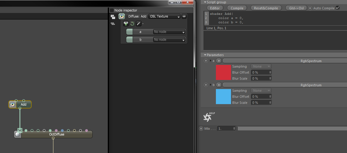

1. Well, it looks like color inputs now don't work anywhere else except in OSL Camera. :|
OSL Texture

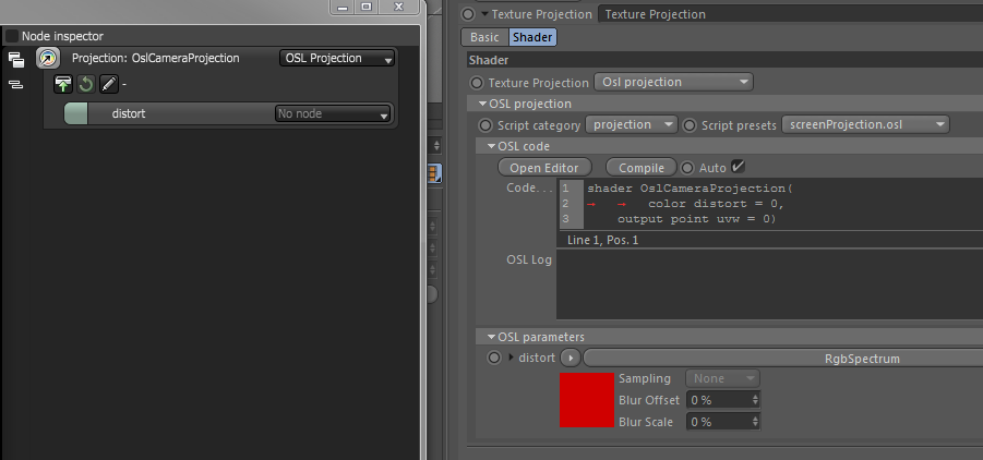

OSL Projection

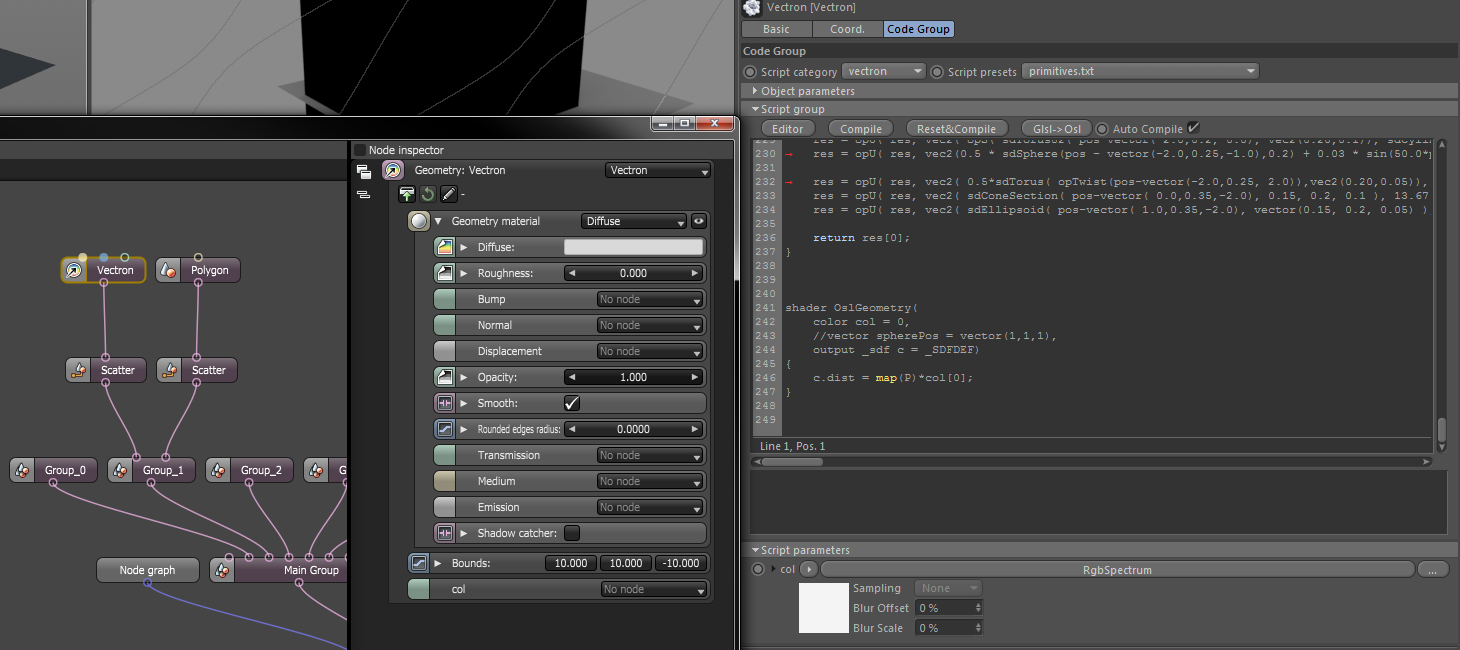

Vectron

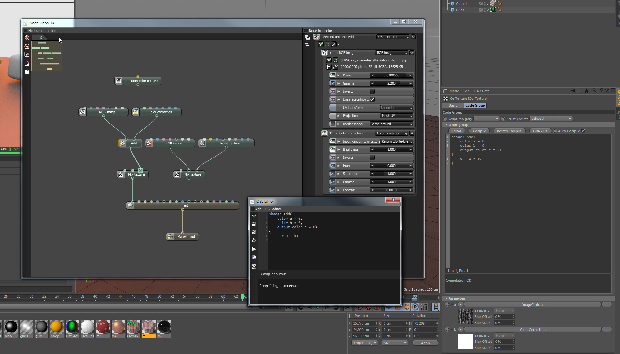

2. Also, in the OSL Camera, it looks like nodes are duplicated every time we change some parameters on the node that's connected to the color input.
3. OSL Baking camera is missing.
Edit: this is in the latest version updated on 25.
Regards
OSL Texture
The attachment OSLTexture color input.png is no longer available
OSL Projection
The attachment OSL Projection color input.png is no longer available
Vectron
The attachment OSL Vectron color input.png is no longer available
The attachment hmmm.png is no longer available

1-I think some textures work some of them not.
2- I'll check it

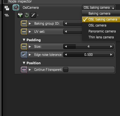

1. That is definitely strange. So far I can see that: RGBSpectrum, GaussianSpectrum, InstanceRange, RandomColor, Dirt and W coordinate don't work.
2. Thank you!
3. It has some extra options that we don't get with a regular OSL camera. I couldn't get it to work without these parameters.
OSL baking camera.png (26.22 KiB) Viewed 4166 times
Here is the description in the OSL docs.
https://docs.otoy.com/osl/camera/#using ... ing-camera
