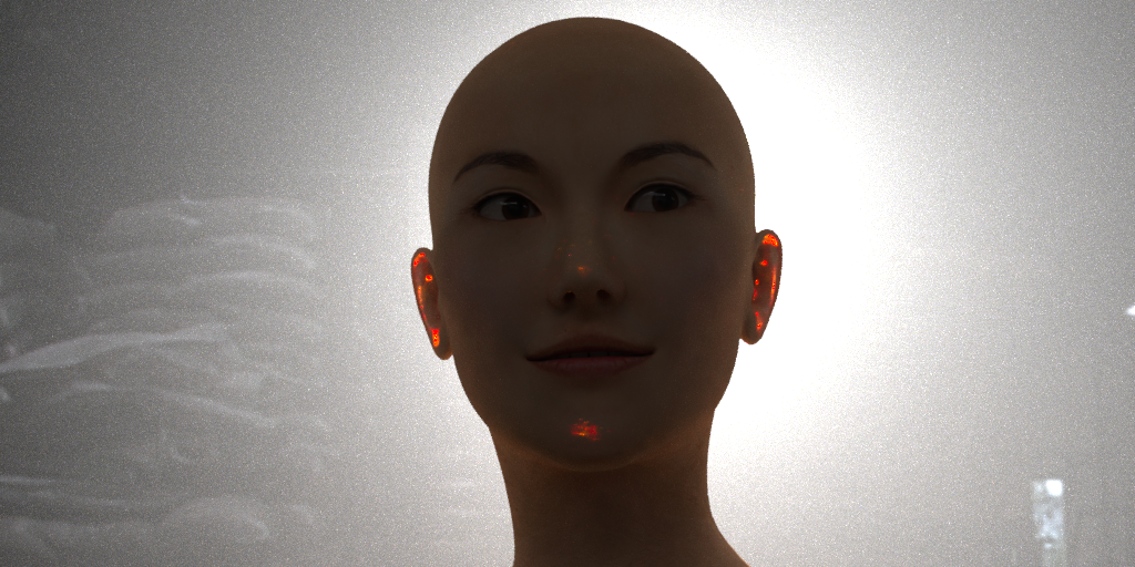

Is there any potential work that can be done on the SSS abilities for the Universal Material, to match that of a traditional Diffuse?
Using the same Transmission settings and Medium settings, I get differences. There are plenty ways to gate the SSS effect on the Universal, but no way to 'fluff' it out like you can with Traditional Diffuse.
BTW - using a Mix Material is an option, but it takes away from the Universal Material's awesomeness.
Diffuse SSS
Universal SSS

Notiusweb
Posts: 1285
You know with the above, it's almost like the Transmission color becomes a reflection shine or something, by the material's own metallic, spec, IOR, and or roughness amounts...
Maybe there is a way to optionally disable that effect on Transmission color, so that it fluffs out if you want, like it would on a traditional diffuse?
