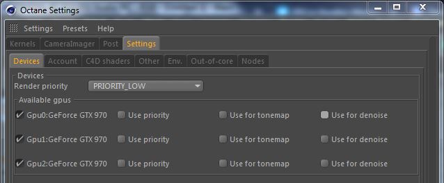

Hi wehuber,
please, share a screenshot of the Devices panel, and some info about monitors connected to which GPU, thanks.
ciao Beppe

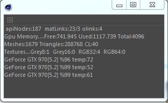

Ciao Beppe,
this is how the device panel and the gpu info panel look while trying to render a scene:
There is only one monitor attached to card 0 via HDMI and it doesn't help if I disable it for rendering.

Hi wehuber,
your settings are not correct, you have no gpu assigned for tonemapping, and AI denoising.
Please, disable in rendering the first 970 connected to monitor, and enable it for Ai Denoising.
Leave the other two enabled in rendering, and enable also the Tonemapping for both cards.
If you want to try with three GPUs, enable also the Priority on the first one, but you always need to choose one GPU for denoising.
ciao Beppe

Hi Beppe,
thanks for the clarification. I already played with those settings and also tried your suggestion but no combination of those changes anything. C4D crashes once it reaches frame 4, every time in any scene. I just don't get it..
EDIT: When I start the render process at frame 5 it suddenly works and keeps on rendering after 4 frames, even with all cards enabled. Seems to be an odd issue...
