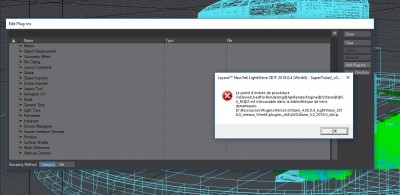

Hello,
I cannot install the lightwave plugin too, I use the 2018.0.4 version too.
Here is a screenshot of the message:
juanjgon
Posts: 8867
Location: Spain
lamerehic wrote:Hello,
The problem can be related to lack of the Visual C++ 2015 redistributable package on your system. You can get it here:
https://www.microsoft.com/en-US/downloa ... x?id=53587
If this doesn't fix your problem, you should check if you have your NVIDIA drivers updated to one of the latest ones. Also, a good test to know if your system has any problem with Octane 4, is to check if the Standalone 4 works fine on it. You can download it from this post:
viewtopic.php?f=33&t=67790
Thanks,
-Juanjo

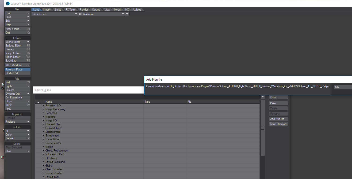

lamerehic
Posts: 21
Joined: Fri Oct 10, 2014 10:24 am
I got Microsoft visual C++ 2017, 2005,2008, 2010, 2012, and 2013 installed instead of the 2015 one... and i cannot install the 2015 one.
It tells me to remove the others versions, but i am a bit affraid to run intro problems if i desintall my versions with my other software..
I installed the lastest driver of my GTX card too.
Do i really need to de-install 2017 version of visual C++ to get the beta working?
juanjgon
Posts: 8867
Location: Spain
You need the Visual C++ 2015 redistributable installed in your system to run the Octane the plugin, not the 2017 one. What error message do you get while trying to install the 1015 redistributable?
In any case, the error that you have attached sounds to me more like a problem with the installation, probably because you have mixed a new plugin build with old Octane.dll/Octane.dat files, perhaps available in your LightWave/bin folder. Remember that now you don't need to copy any file to the LightWave/bin folder, and you should remove the Octane.dll from this place if you have it there.
Thanks,
-Juanjo
