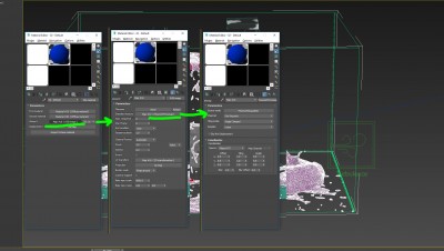

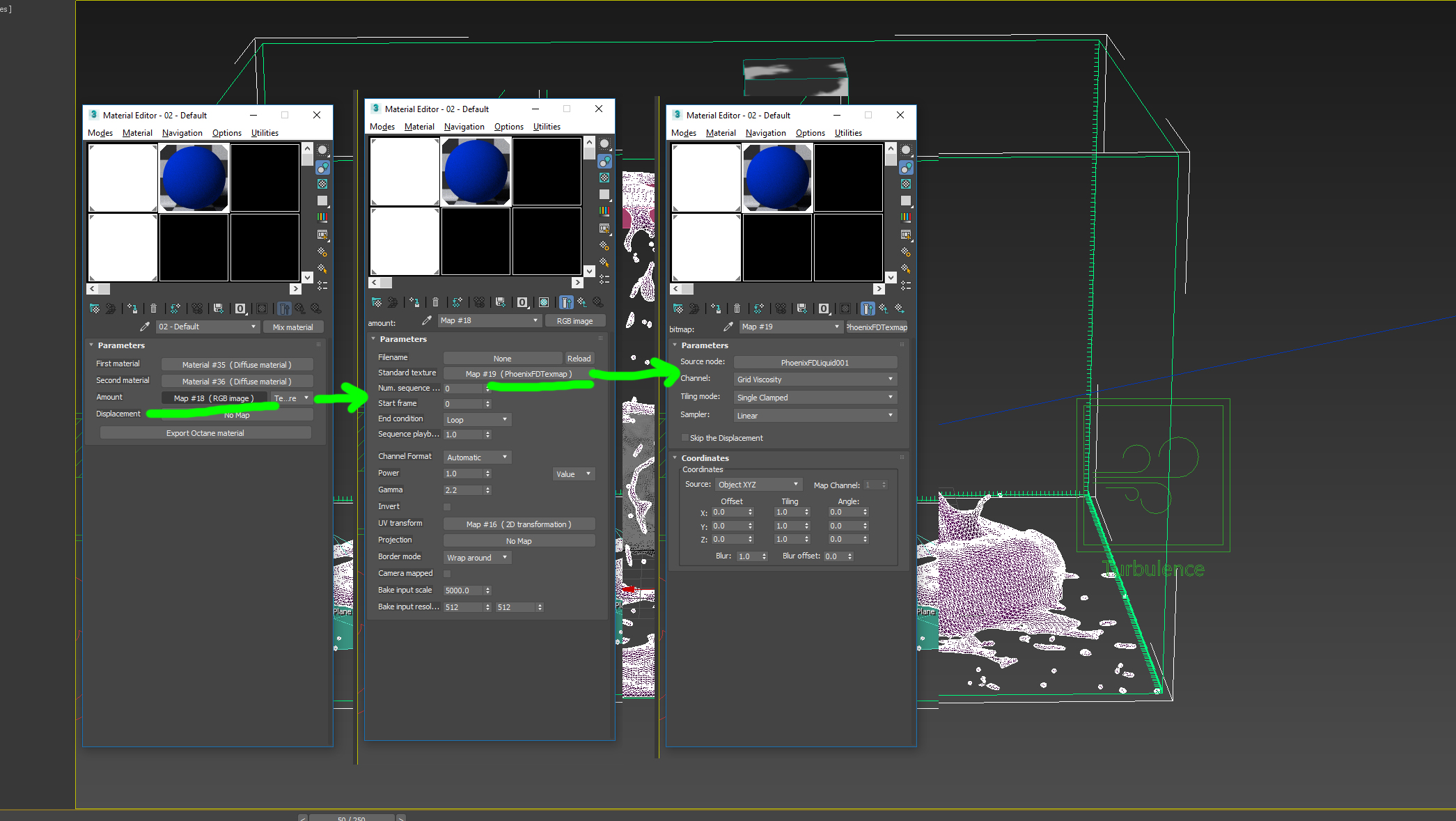

hopefully they can fix it where we can have noise texture baked into liquids. I think most renderer support this.
I also attached the image of phoenix texture map This texture makes hot lava turn to rock over time. maybe otoy can get it working so liquid can change color overtime. Would be nice to have all phoenix textures working in standard texture slot
And one more request. We still cannot have multiple color fluids in one grid. Can they please add RGB support.
