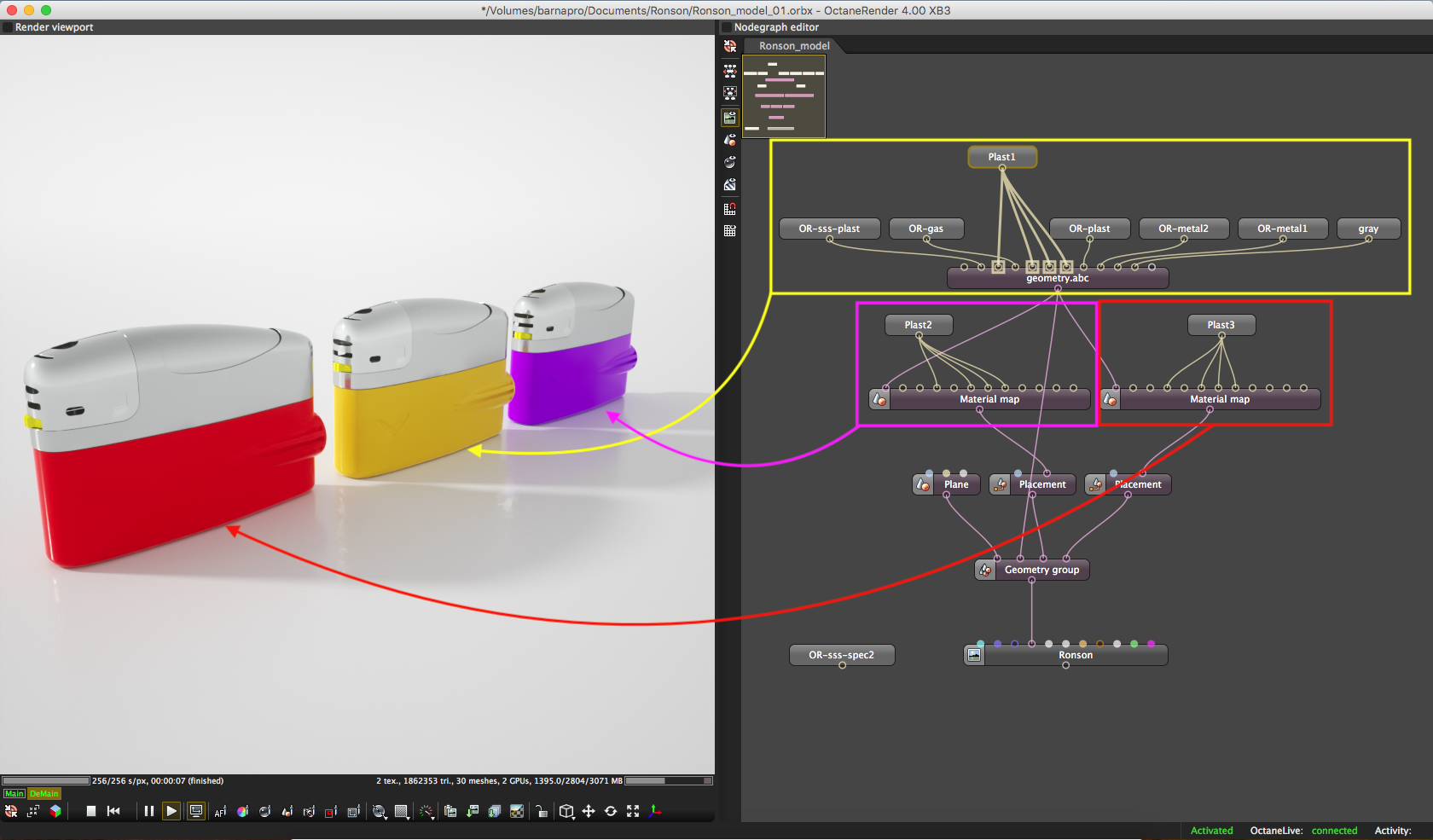

Notiusweb wrote:Could you please post a screen shot of a simple Material Map set-up, doing whatever it does now?
I can't figure out link-wise how it plays into a mix of FBXs, say for example.
I am imagining, as I have 2FBXs, with equal # material node channels, and one FBX with mats already set up, another without any, and this thing (Material Map Node) could link the two to transport the maps from one to the other (?).
But, even though I am a master of nodes, and all nodian things, I have node idea what to do with the Material Map.
Do you node what I am saying?
THX!
PS- Say Node to Drugs!
(Except on weekends.)
sorry for the late answer, please have a look at this example:
The yellow lighter is the .abc geometry, while the red and the purple are material-map nodes with placement node. They are like instance nodes, the poly count does not change.

Oh, I see. It provides a mechanic to display an efficient clone of the geometry. I thought it was actually going to let you pass through a material map from one actual separate geo to another.
I was thinking to somehow we were going to be able to pass, say, a 12-channel material map from an FBX to a 1 channel alembic. But I see now, mechanically that is not possible.
Okay, really good stuff!

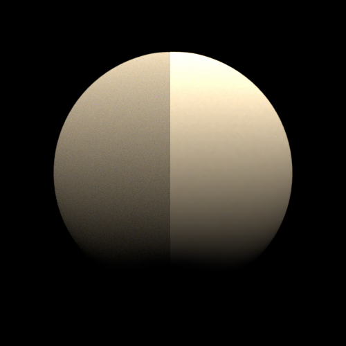

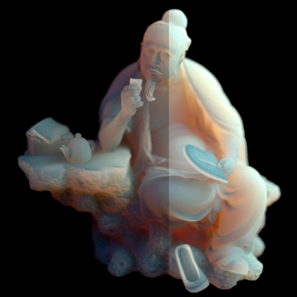

Black diffuse materials with a scattering node plugged into medium are much brighter when denoised

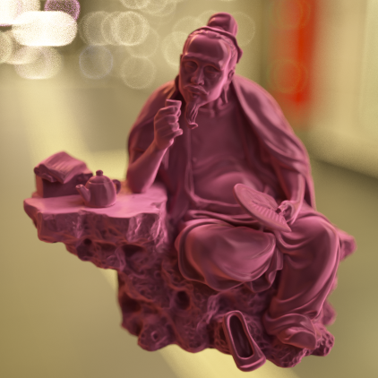

There's an issue with the denoiser not denoising the background.
Here is an image with some heavy DOF. You can see the bokeh generated over the HDR background is noisey even though the mesh is in the foreground is clean.
It seems the denoiser only denoises parts of the image where geometry exists. If we trick the denoiser by surrounding the scene with a large inverted transparent sphere, the background bokeh is denoised.
I hope you guys can fix this so we don't have to use such workarounds.

HHbomb
Posts: 1407
denoiser don't denoise background right now. I found that denoised image is brighter behind specular too.

funk wrote:Black diffuse materials with a scattering node plugged into medium are much brighter when denoised
Could you please send me the scene?

funk wrote:There's an issue with the denoiser not denoising the background.
Yeap known issue, We are working on it.
Here is a simplified scene
left: no denoise
right: denoised
diffuse_scatter_denoise_brighter.orbx
(456.78 KiB) Downloaded 291 times
