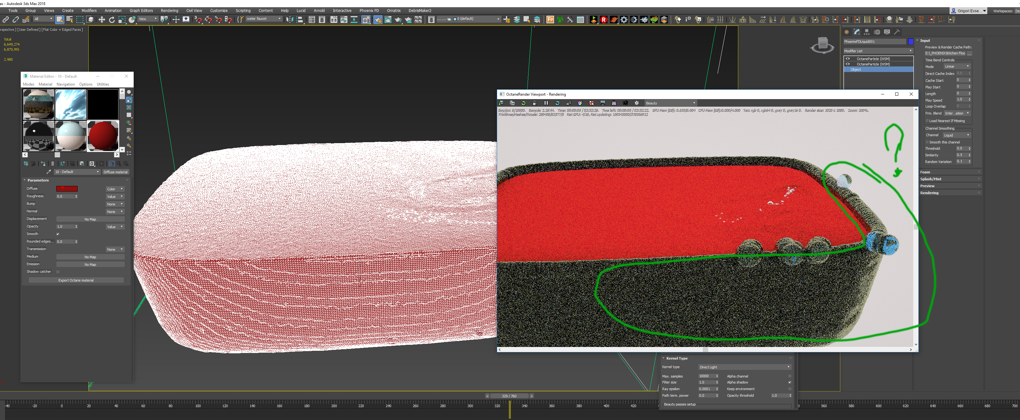

can you import this AUR phoenix sim and render it. For some reason strange bubbles appear around liquid. (Please create 2 spheres and name them foam and splash )
Sink Water_0329.zip

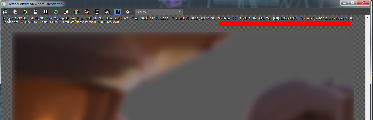

cpu memory not work

Elvissuperstar007 wrote:cpu memory not work
