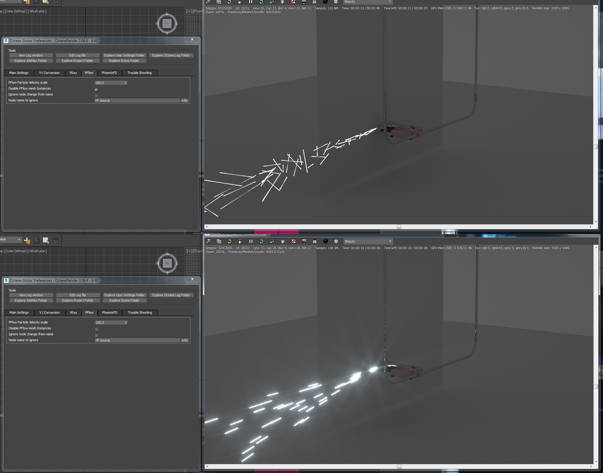

Hi Paride
All those examples were made with pflow mesh instances already disabled. So it looks like a bug

Hi Paride
I am sorry we had this option checked. Looks like it works with it unchecked but now all our sparks are way brighter and the reason we had it checked is slow evaluation times. Not sure if 4.40 version fixed slow eval times
Also cam they rename this button as ENABLE pflow mesh instances. That way when it is checked it is ON. Right now when it is checked it is OFF confusing
versiom 4.39
"by neonZorglub » Thu Aug 10, 2017 1:32 am
The issue comes from the new PFlow instance support
>> Please select 'Disable PFlow mesh Instances' in the Trouble shooting tab of Global Preferences <<
That should bring back the evaluation time to normal !
We currently need to parse the scene a first time (which is slow when you have many meshes..) for this PFlow instance system..
If you don't use PFlow, you should definitely disable this ..
If you use PFlow, it should still be highly beneficial to enable it, but might depend on number of particles vs non-pflow meshe count ..

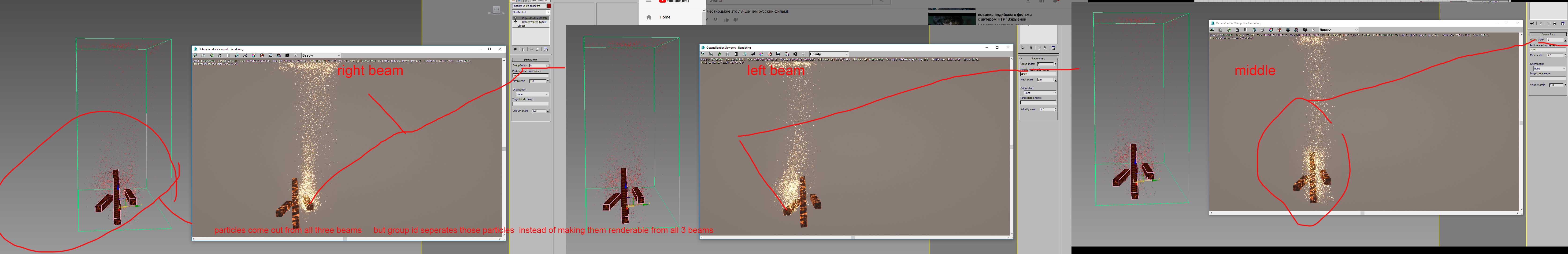

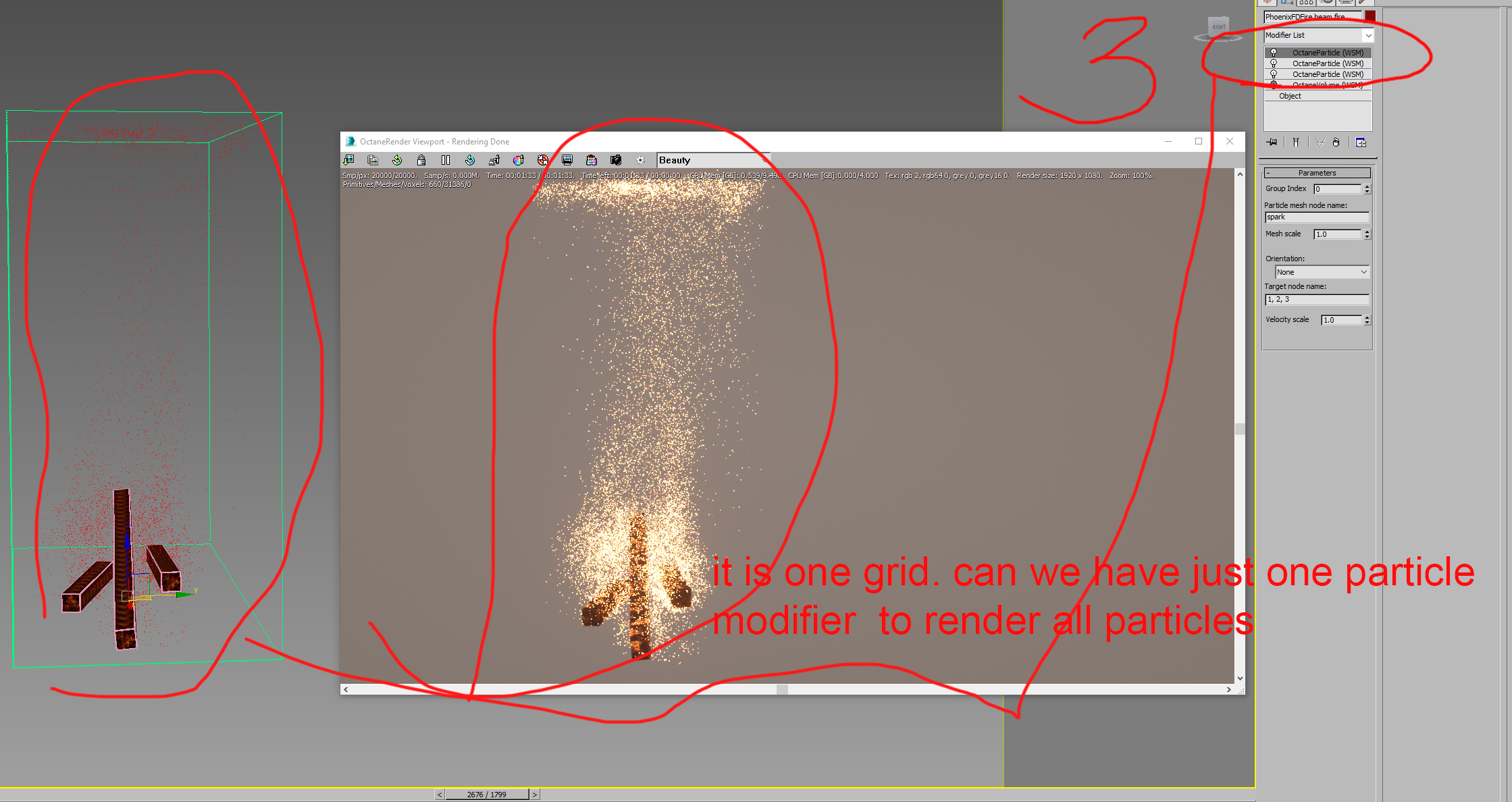

This is about rendering phoenix fire particles. we have three logs that crashed and created sparks. Octane does not render sparks from all 3 logs. Instead, it chooses if it is a beam 1,2 or 3 depending on group index. It is just 1 grid. Why cannot it render sparks from all 3 beams.
UPDATE:
we added multiple octaneparticle modifiers and it works. I guess if you have 10 beams you will need 10 modifiers with group index 0-9. Can otoy for fire sparks make all particles renderable without having more than 1 octaneparticle modifier?

Another bug. WHen disable pflow mesh instances is unchecked it is not rendering animation. pflow is static

paride4331
Posts: 3878
coilbook wrote:This is about rendering phoenix fire particles. we have three logs that crashed and created sparks. Octane does not render sparks from all 3 logs. Instead, it chooses if it is a beam 1,2 or 3 depending on group index. It is just 1 grid. Why cannot it render sparks from all 3 beams.
UPDATE:
Hi coilbook,
I think a single modifier particle could prevent having several sparks in the same grid, such as a firework explosion or something like that.
https://youtu.be/Lrs1DcvkDEc
Regards
Paride
coilbook
Posts: 3095
HI Paride
I will try it with units. It seems brightness is ok now. We are working in inches.
What about pflow is static when disable pflow instance meshes is unchecked. Thank you
