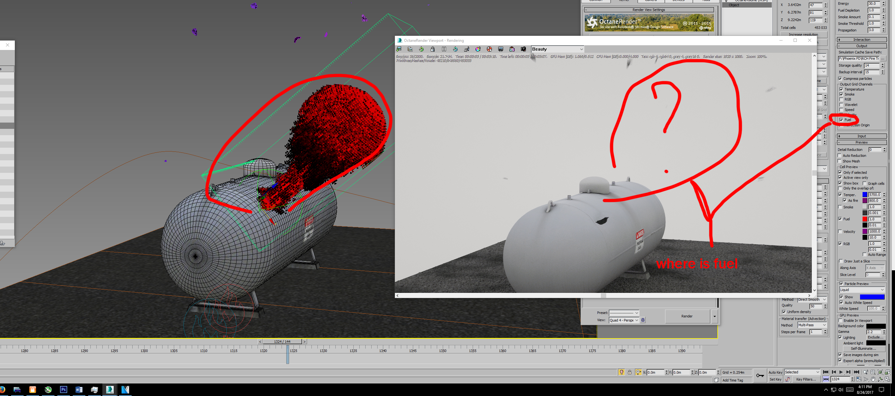

coilbook
Posts: 3145
hi
why cannot i render fuel? did you guys made it unrenderable ?
and when can we get an option where we render fuel one color and smoke another?
Thank you
paride4331
Posts: 3963
Hi coilbook,
It just seems to me too.
Coud you kindly share your file to compare it with mine to send to developers?
Regards
Paride
