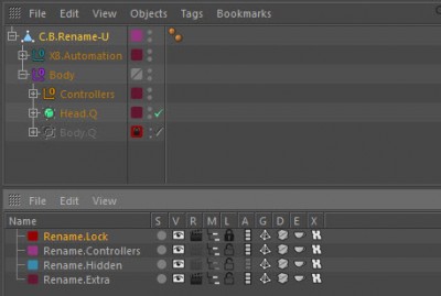

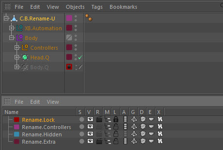

Your estimation is not correct here! Here's a problem about layer system and visibility. See image. There something maybe wrong on my codes or not. Don't know yet.Tag12345 wrote: I noticed Octane ignores meshes if they are under subdivision nurbs?
That with a combination of nulls, cuz I have a rig and have tried a few rigs that have very complex xpresso and subdivision nurbs and they dont appear in the viewer unless I drag it out of the Main Null, which I find very displeasing
I dont know if this is a bug at all, but you can test with the .Lib4d below and see if you can identify why this may be.

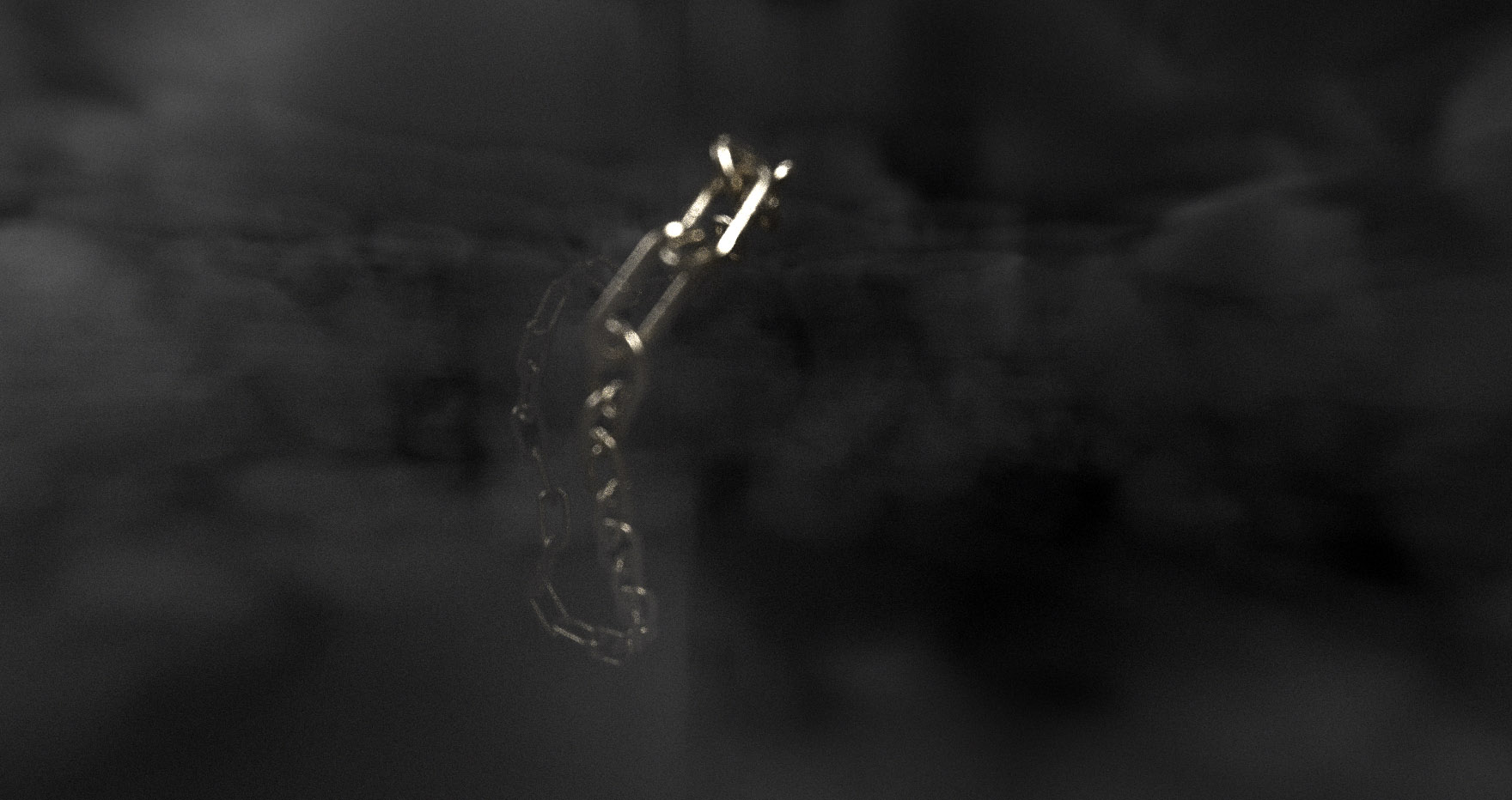

Does Octane render support scaling TurbulenceFD Container or not?
Cos Octane render wrong scale or position.
Here is an image:
https://gyazo.com/5aecbd21773fa7005cb57badcfe1d22a
Default redner make this redner correct.
