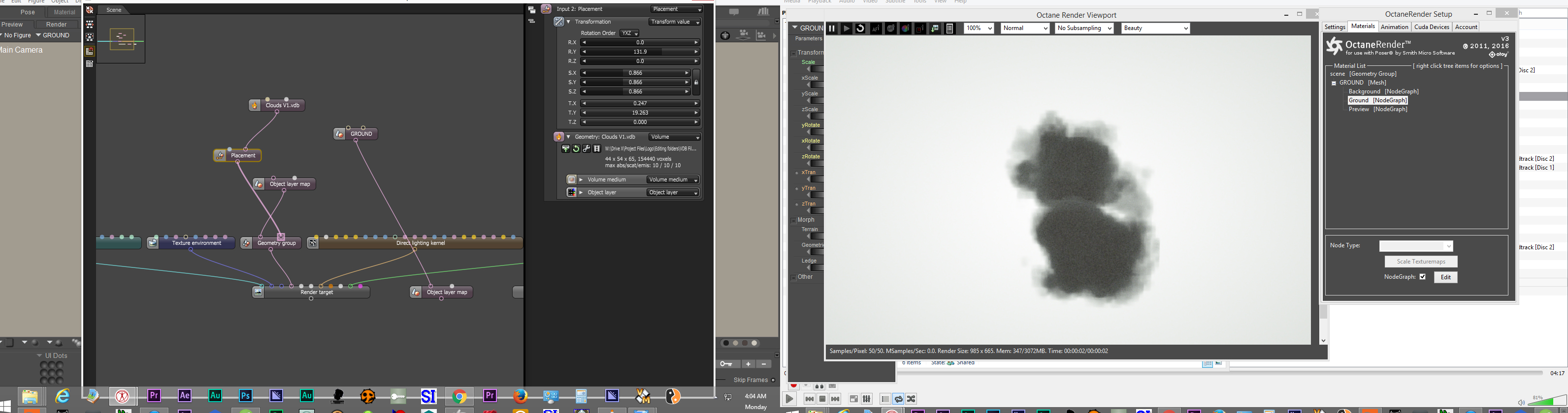

Hey, Paul
What about the NodeGraph feature. That can't just be for textures. Remember in my earlier post I used it to get the VDB files into poser (can't remember how I did it) before you added the Proxy feature to the node type selection. You can choose all the nodes in the plugins NodeGraph that are in the stand-Alone, including the placement node, Plus geometry out node. It's just a shot in the dark. I don't know if you thought about this already but it could be a temporary workaround.
thanks

Paul,
I was able to recreate importing the VDB into Octane poser plugin through the NodeGraph. I attached a placement node to the VDB and it moved the Volume in the poser viewport. So I guess it can be done.
Yes, that may be an option (and is what I have implemented in the ArchiCAD plugin).
Paul
