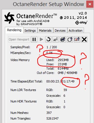

with this (large) scene strange things are happening...
1. The free vram is shown wrong...need to check if this i also with other scenes.
2. The estimated time is much too big when starting this scene, and the MSamples/Sec are shown very low for a long time when having started the rendering,
it seems it needs kind of reload every time after switching cameras (not need to reload the scene).
The rendering times should be around 30 sec, but with some cameras are much longer.. seems to be the rendertimes are sometimes without being able to have used the renderslaves.
I cannot point finger on it, but it feels like this is working slower then previous versions.

rappet wrote:hi,

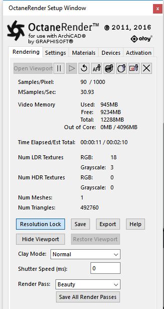

Hi Rappet. I am also noticing a difference at the video ram.
With the display card (M5000 Quadro activated) I see a 2GB difference
If I deactivate the Quadro and leave the 2x TITAN X activated I notice 3GB difference!!!
Is this normal?
I also noticed that if I change a folder name with a proxy used from that folder everytime octane is started is giving a message to search the file. Shouldn't the file be updated the first time I set the new address of the proxy?
ASUS Z10 PE-D8 WS/2 x XEON E5-2680 V4/64GB RAM/1xQuadro M5000/2x NVIDIA GTX TITAN Pascal/ Windows 10/ Archicad 20
This looks right to me. Windows & ArchiCAD will use about 2GB VRAM.
These figures look right to me. Used + Free + whatever-Windows-and-ArchiCAD-is-ising = Total.

Thanks Paul for the info.
Is it possible to dedicate the TITAN Xs just for OCTANE so windows and Archicad can use only the QUADRO.
It is strange that even when I deactivate the Quadro from the OCTANE menu the TITANs are still loosing 3GB (25%)
So even when the Quadro is used for my displays and not used by OCTANE seems that something is decreasing the VRAM memory from the TITANS.
Yes, plug you monitor into the Quadro and disable the Quadro in the Octane devices tab. It you do this - try in Standalone first - so that you get VRAM usage figures which exclude whatever ArchiCAD might be using.
The screenshots you posted only shows 2GB being lost.
This is my current setup. I will try with the standalone and inform you but I am sure that you are right concerning the VRAM numbers. Things are cleared now.
You are right I forgot to add the used VRAM so it exactly as you said concerning the VRAM numbers that look normal. Is it possible to dedicate, with an app or a setting, the titans only for octane while archicad and plugin are used?

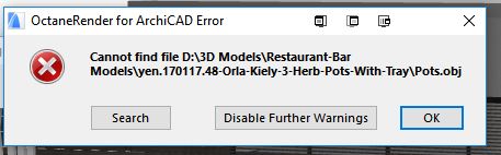

I renamed a folder that included a obj that was used as proxy in an archicad project. Now every time I open this project octane is searching for that proxy and a message comes up for searching. Even if I close octane plugin and reopen it without closing Archicad it keeps asking for the file.
Yes - that is the intended behavior. If the plugin cannot find a texturemap or proxy asset, it will ask you to locate it.
I have one more question. If I have for example one object in Archicad that is connected to a proxy and copy this object the proxy connection remains and the proxy is copied also. If I want to change this proxy to all this copied object how can this be done without deleting and recopying in archicad? It is not possible to multiselect objects and connect them all with a new proxy. Am I right
Load the new proxy into one of the Objects, Materials tab->"Copy", then select all the other host Objects you want to copy the new proxy to and click Materials tab->"Paste".
