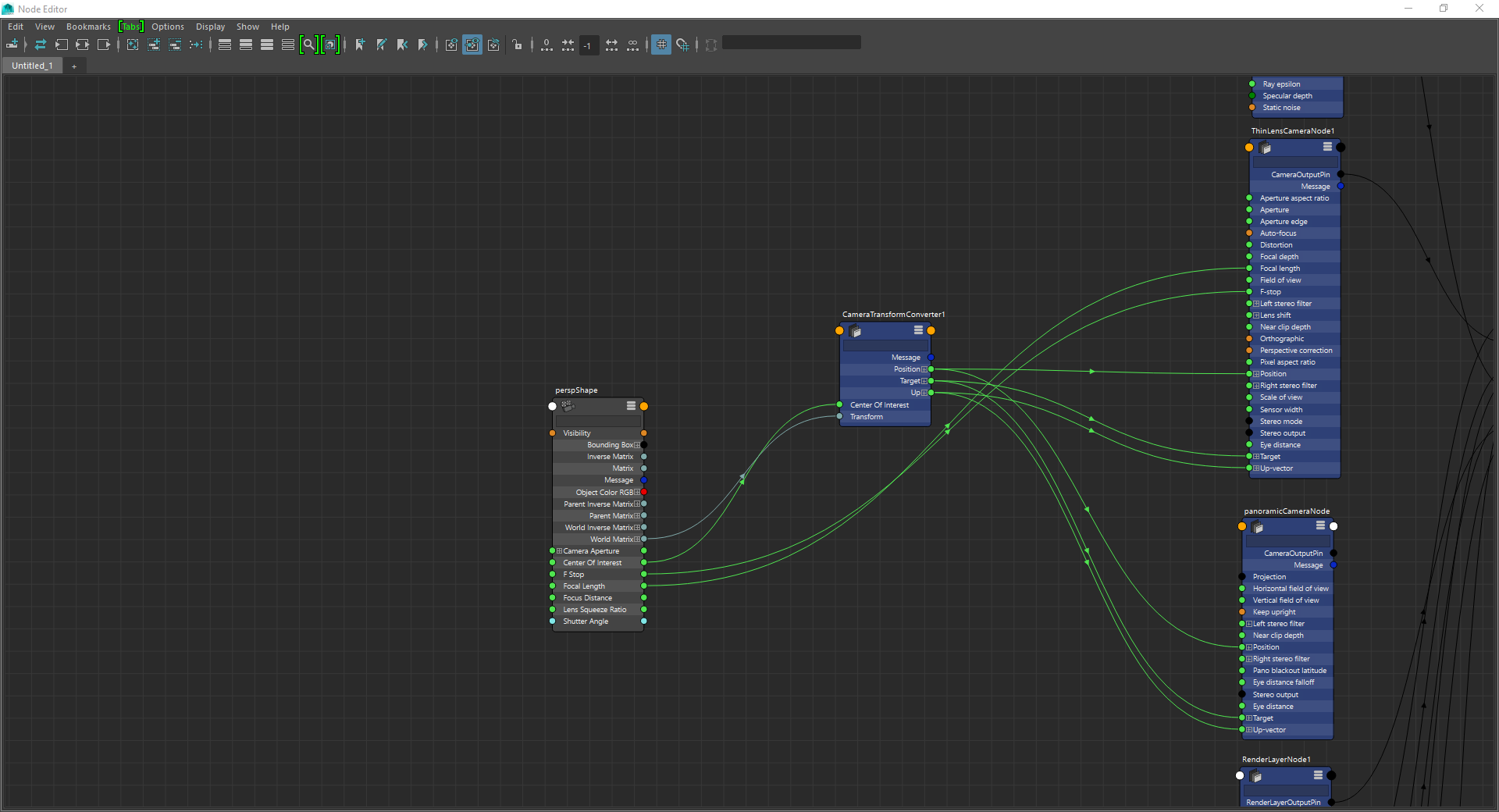

calus wrote:About the camera matrix converter I'm curious,
why not take as input the world-matrix from the camera shape, instead of translate and matrix of the camera transform ?
(and the fluid shape also have a world matrix output ;) )
Not sure what you mean about the hypershade.
Since maya 2015 hypershade is the node editor with a special configuration, do you mean internally you still have to use the functions of the old legacy hypershade ?
Though in 2016.5 we still have to use the legacy hypershade for container node, containers are still not supported in node editor :(
( I guess containers in node Editor = Maya 2017)
Somehow I had in mind the world matrix of shape nodes is a null matrix. Obviously I was wrong!
Changed that, no need to have the transform nodes in the graph anymore!
For cameras and fluids and in the future any shape node. :)

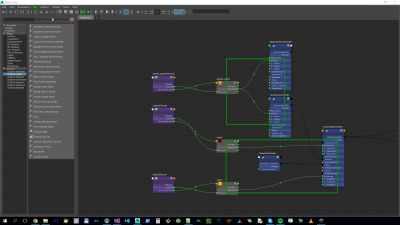

No, I'm not using any hypershade specific functionality (legacy or not).
I was just wondering, if we want material and upstream nodes (textures, transforms etc. ) in the main node graph (as in standalone)
or we stop at the geometry level and have separate node graphs for the materials (like version 2 materials basically).
Just having an idea: The planned geometry collector nodes could be per assigned material maybe.
So we have each material once in the main node graph connected to the geo collector node,.
Each material can be edited there or in hypershade, however you like
and "assign material" from the context menu stays the assignment mechanism.
Need to look up container nodes, cause node grouping in some form would be nice sooner or later!
Again, just juggling design ideas for this part, any thoughts?

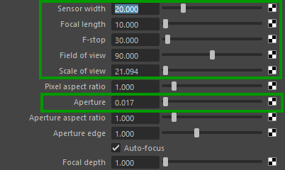

you can link maya camera attributes to octanes, see below:
Just a problem there:
The connection with the maya camera shape attributes,
blocks updates from octane api for interdependent attributes of the thin lens camera, which are:
When you move the sliders, you are able to see the updates from octane api live, like in the standalone thin lens node.
So I'll add, that those attributes, if connected, update their connected Plugs, so the octane api updates don't get lost.
Though you need to link the attributes by hand for now.
But thinking about an automatic link feature for some nodes, where the connections are unambiguous.
So for example these camera connections. :)

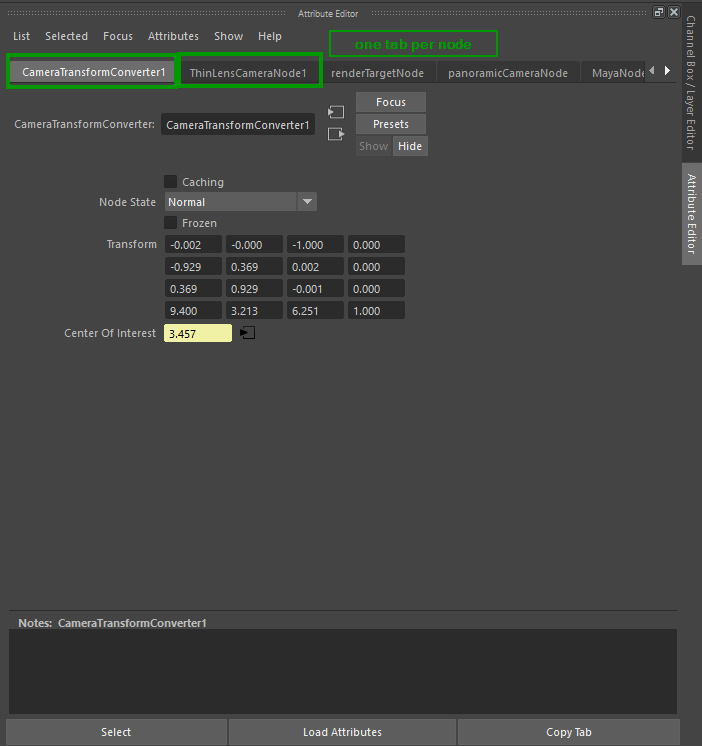

I like nodes for materials and animation, but I hope we can accomplish a lot using only the attribute editor/render settings alone. I'm guessing "ThinLensCameraNode1" would be a tab of the camera transform along side persp and perspShape instead of a frame inside perspShape like it is currently. ThinLensCamera does sound like a job for the shape node, but I guess a single additional tab is fine too (I suppose CameraTransformConverter1 is auxiliar and doesn't clutter the attribute editor).
As far as I can see, the attribute editor displays one tab for each node and shows tabs of connected nodes next to each other:
That's why I want to have separate nodes.
Don't like how much each maya cameras AE (Attribute editor) is cluttered with more octane sub and subsub menus in version 2.
Took me ages to find something. :(
Better have separate nodes and connect necessary attributes (more convenient with an automatic connection feature though XD).
Does for some reason not work when selecting the camera shape node (which is connected to the camera transform converter), no additional tabs are displayed!?
No idea why:
The render settings window will be less important, as I stated above. Just makes sense to go all nuts on nodes, since maya is build for dealing with them,
and yeah all attributes are scriptable than. So thats a plus I think.

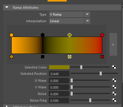

Well as long as the output is a single color (already sampled from a texture or just from a ramp for example) that should be fine:
Using ramp nodes as color dummies atm, for the volumes:
Actual textures are a different case, but I will get to that as well!

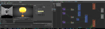

With the updates Calus suggested for using the world matrix of shape nodes to transform them to their place in the world (byebye transform nodes ;) ),
the volumes grew upstream, already giving some nicish results:
Still need to implement the internal ramp attributes (absorption, scatter, emission), but then volumes should be done for now. :)
