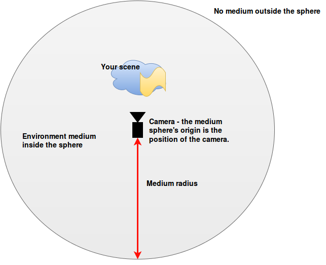

grimm wrote:The environment medium doesn't work for me. :( I made this test scene in Blender to test using the sphere around the camera method. Here is what I was able to get with scattering set to 0.0002 and scale set to 80:
The attachment fog-testv3.png is no longer available
Here are the settings in the Blender plugin:
The attachment fog-test-blender.png is no longer available
Then when I tried to replicate the same settings in V3 standalone I get this:
The attachment fog-testv3-octane.png is no longer available
Here are the files:
The attachment fog-test2.blend is no longer available
The attachment v3-fog-test.ocs is no longer available
Thanks :)
I had a look at this, the radius of your medium is too small (it's set to 3 in your project). It should be something very large. I think you used the radius of the sphere around the camera?
This is how it works, the enviroment medium is defined as a sphere around the camera:
How the environment medium works.
cheers,
Thomas
grimm
Posts: 1332
Joined: Wed Jan 27, 2010 8:11 pm
Location: Spokane, Washington, USA
Thanks for looking into that Thomas. That was the issue, I thought it worked similar to the inverted normals sphere around camera method. :) You are right about setting it really large, for this scene I had to set the sphere size to at least 600. Any lower and very strange artifacts would start to be rendered.
Jason
