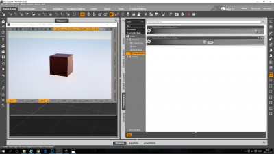

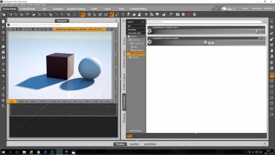

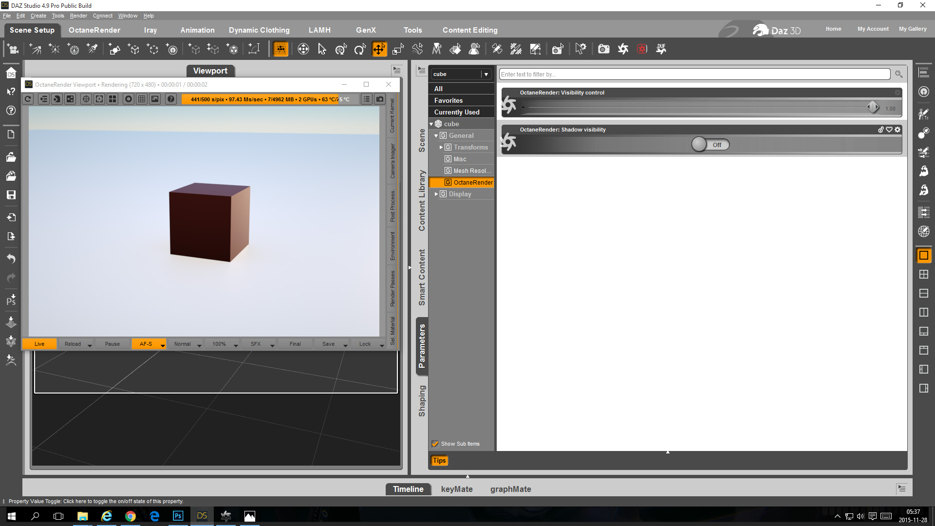

In general the Shadow Visibility button in the DAZ STUDIO paramters tab is sometimes working and sometimes not even when using the same environment.
To experiment:
- place a plane into the scene
- add a cube
- select cube in the scene tab
- go to parameters tab
- try to toggle shadow visibility off
Sometimes the OFF button is working
- do some random things
And some times the OFF button does not do anything
Also tested: I was able to have Shadow Visibility OFF work together with an HDR environment.

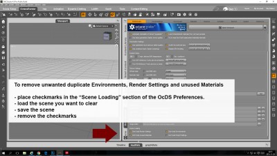

Nevertheless it seems in the OcDS Preferences tab there are actually Scene Loading options:
- Don't load Render Settings
- Don't load Environments
- Don't load unused Materials
- Don't load Project Settings
Those options could in theory be used for the following workflow to remove unwanted settings when loading scenes:
Use Scene loading options to clear unwanted environment and render settings.jpg
To remove unwanted duplicate Environments, Render Settings and unused Materials
- place checkmarks in the “Scene Loading” section of the OcDS Preferences.
- load the scene you want to clear
- save the scene
- remove the checkmarks
Does this workflow do the trick for those having issues?
