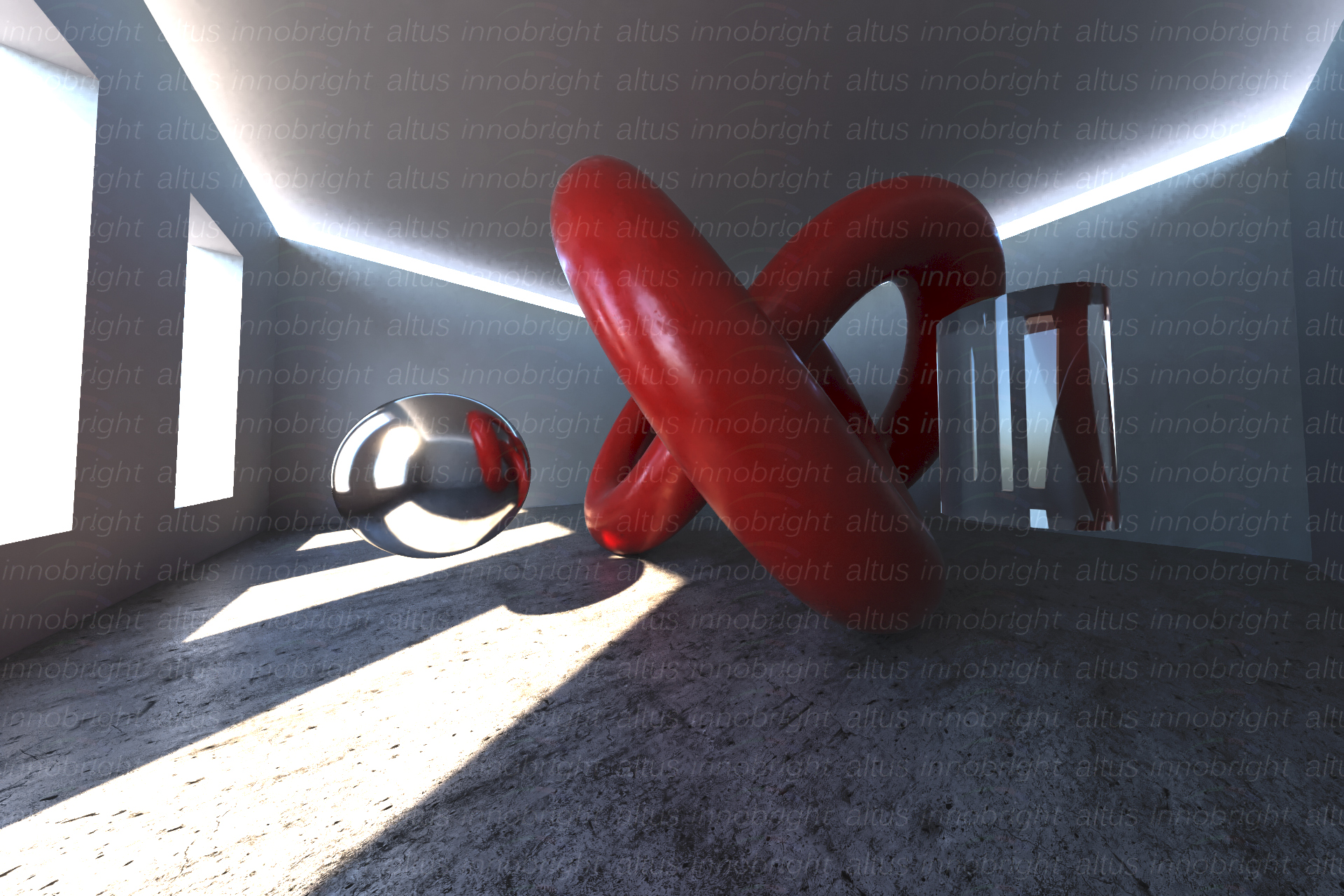

Adaptive sampling is a 3.1 feature and won't take long to implement.
The Altus denoiser is a 3rd party plugin, which we are validating with the new 3.1 native plugin system/SDK.
Today, Alrus does work externally eith Octane with 3.00 beta 1 AOVs renders. This how we tested the denoising samples shown in the GTC slides. We would like to have the denoiser become an integrated 3.1 plugin so it is easier for artists to use in their host app of choice and also available on ORC.

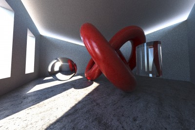

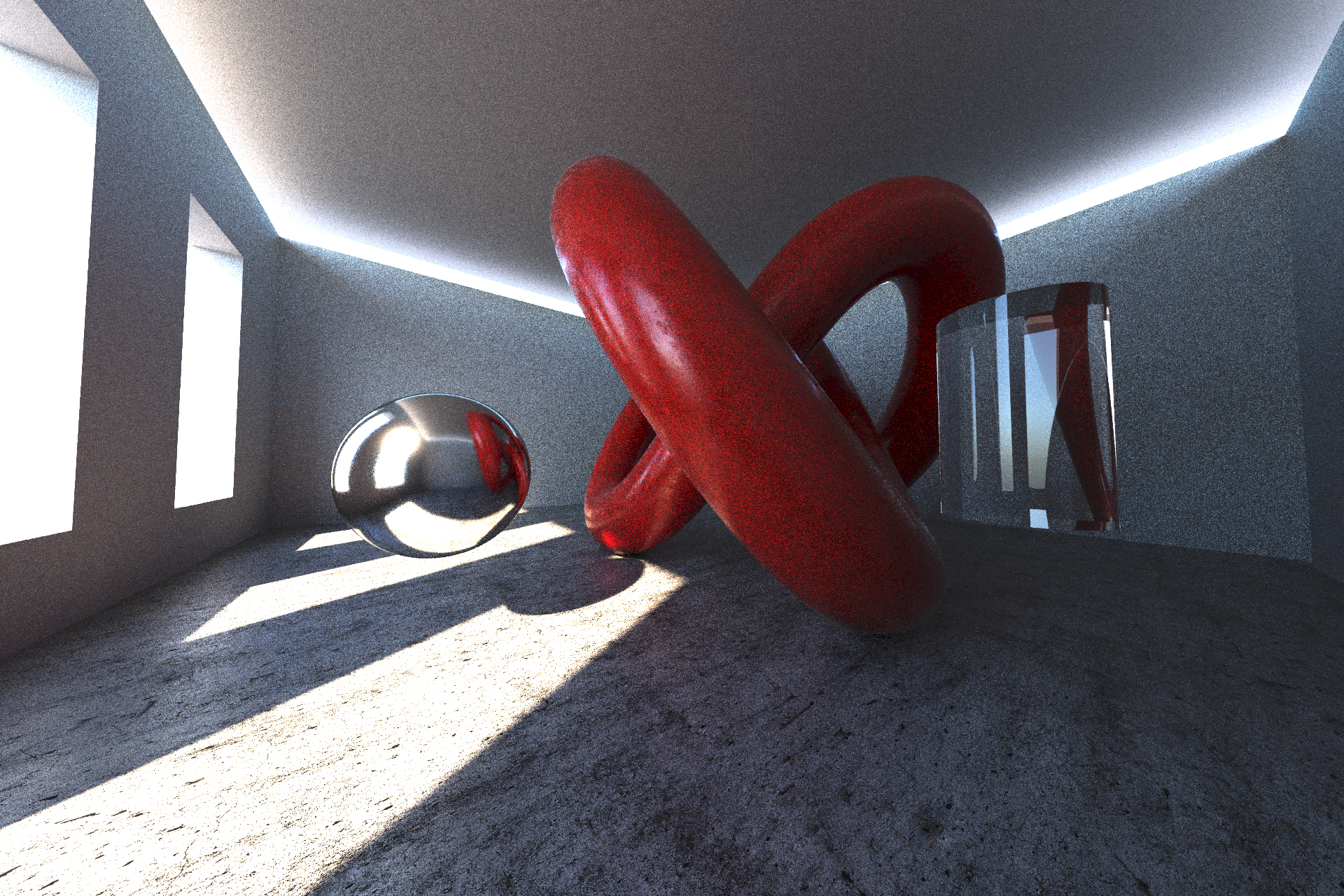

Depends on your source image I would say; after a decent amount of samples you shouldn't loose much.
Compare the renders I posted at the beginning.
From the Corona forums
Rendertime: 1:40 min (4 passes, which is almost nothing)
Filtering Time: 43Sec
Here's a short review:
