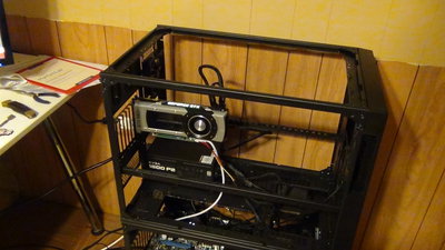

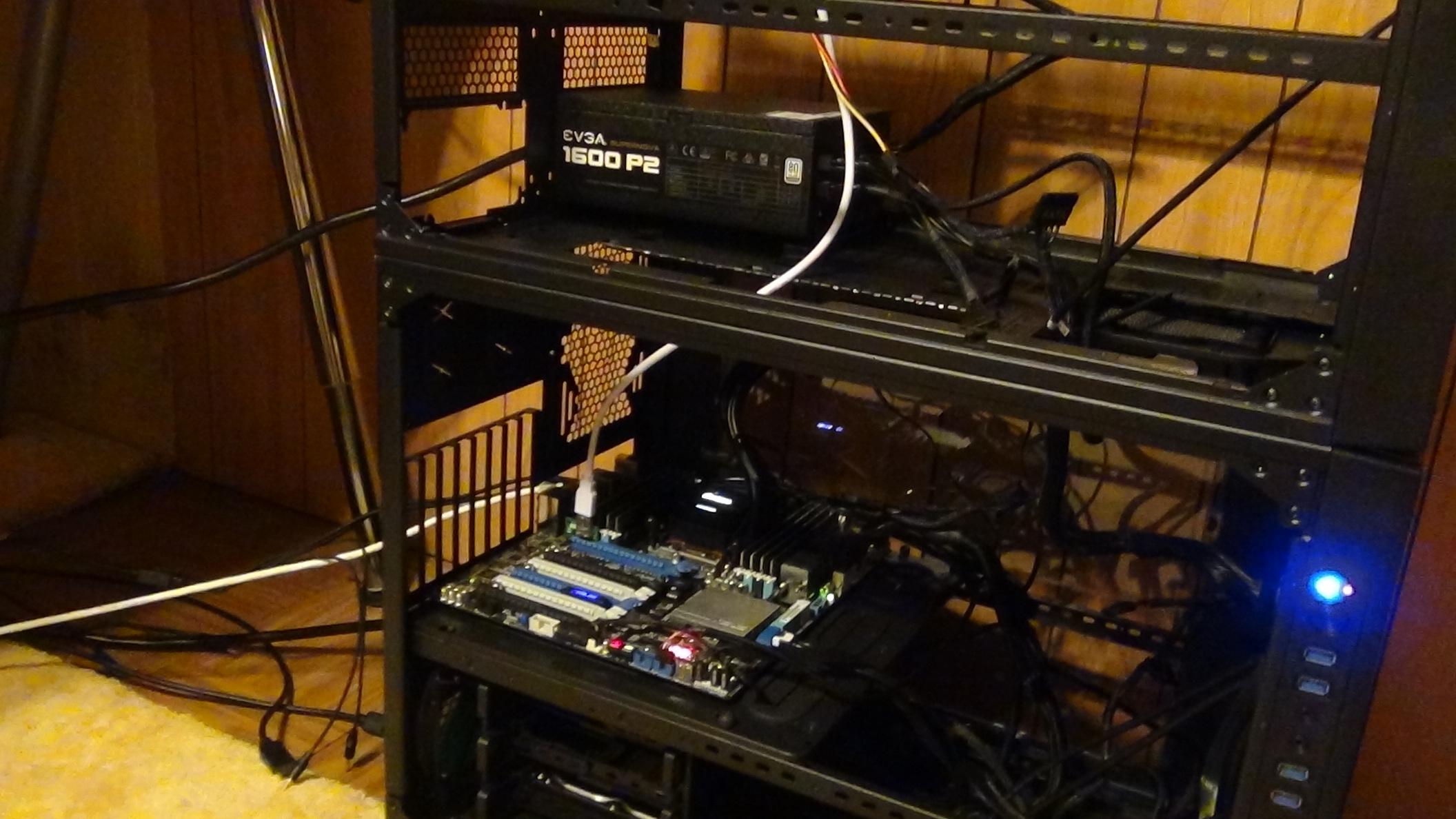

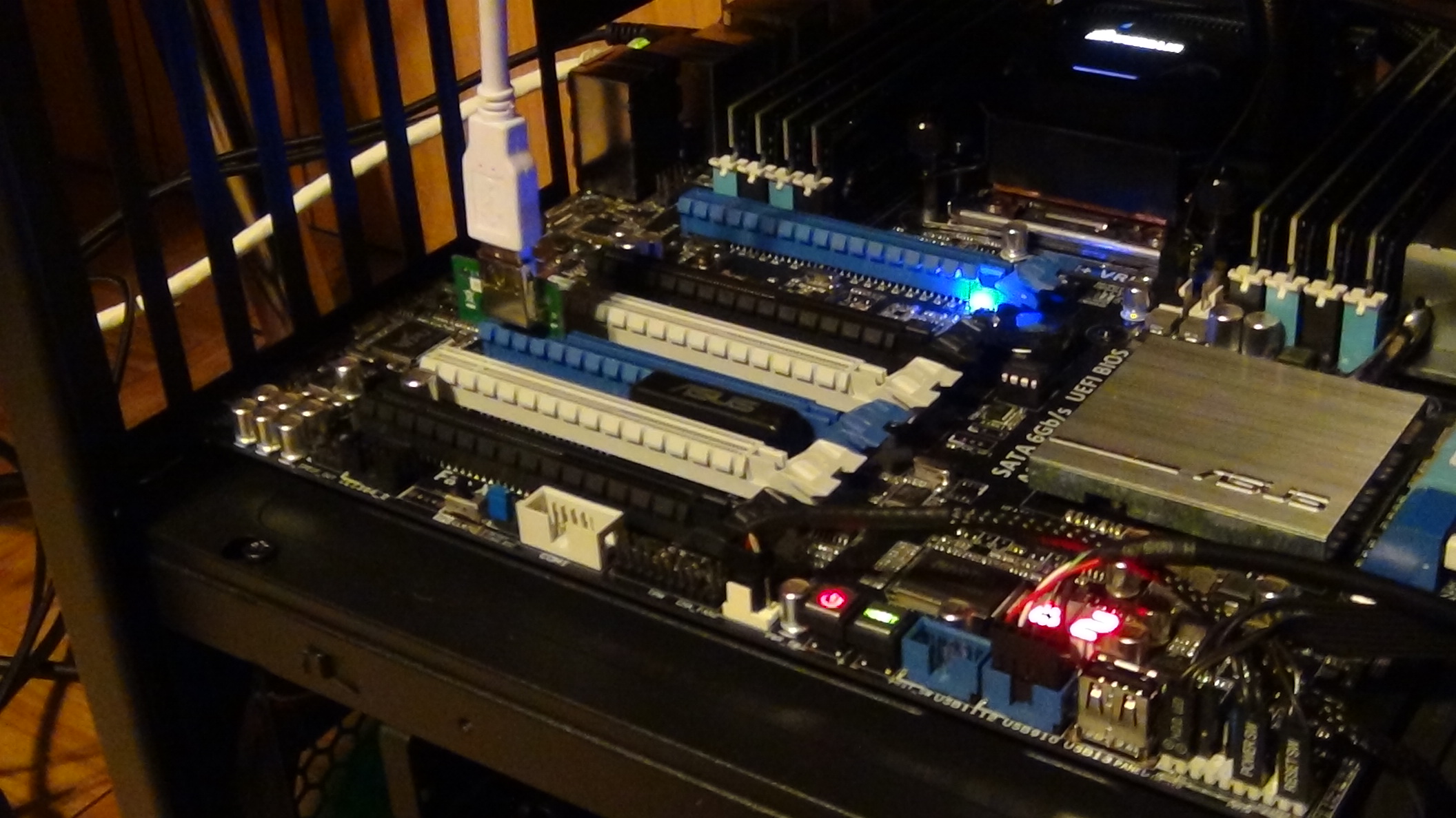

Hello Gentlemen, seeing all these insane setups I thought I try it out myself.... but I can't get past 4 GPUs
I decided to go with the 16x to 1x USB risers http://www.amazon.com/RIF6-PCI-E-Adapte ... e+extender
I'm, trying, to run 6 GPUs (5-980ti's 1- Titan) and I had 5 of them connected via USB and 1 980ti connected on the 16x PCI slot. When I tried to start my computer the boot menu never appeared and remained blank on the screen. I took a look and the LED DeBug screen (or whatever its called) and it was repeating it self so I guess it was in a boot loop. After hours of tinkering I was able to get at least 5 of the 980ti's to work, but when I went to benchmark I got a score of 506 where as the 4 980ti's got 490. I'm no expert in this but that doesn't sound right at all.
I see everyone here not experiencing massive issues like this so does anyone have a suggestion? Is there some type of system bypass to allow the cards to pass through that I'm missing? I'm not well versed in anything dealing with BIOS settings and coding in general, like what tutor was talking about, the I/O space, yeah no idea what that is.
I am also sure its not a PSU thing because I connected 2 1600W togeather via that Add2PSU board.
Any help will be highly appreciated

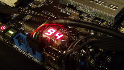

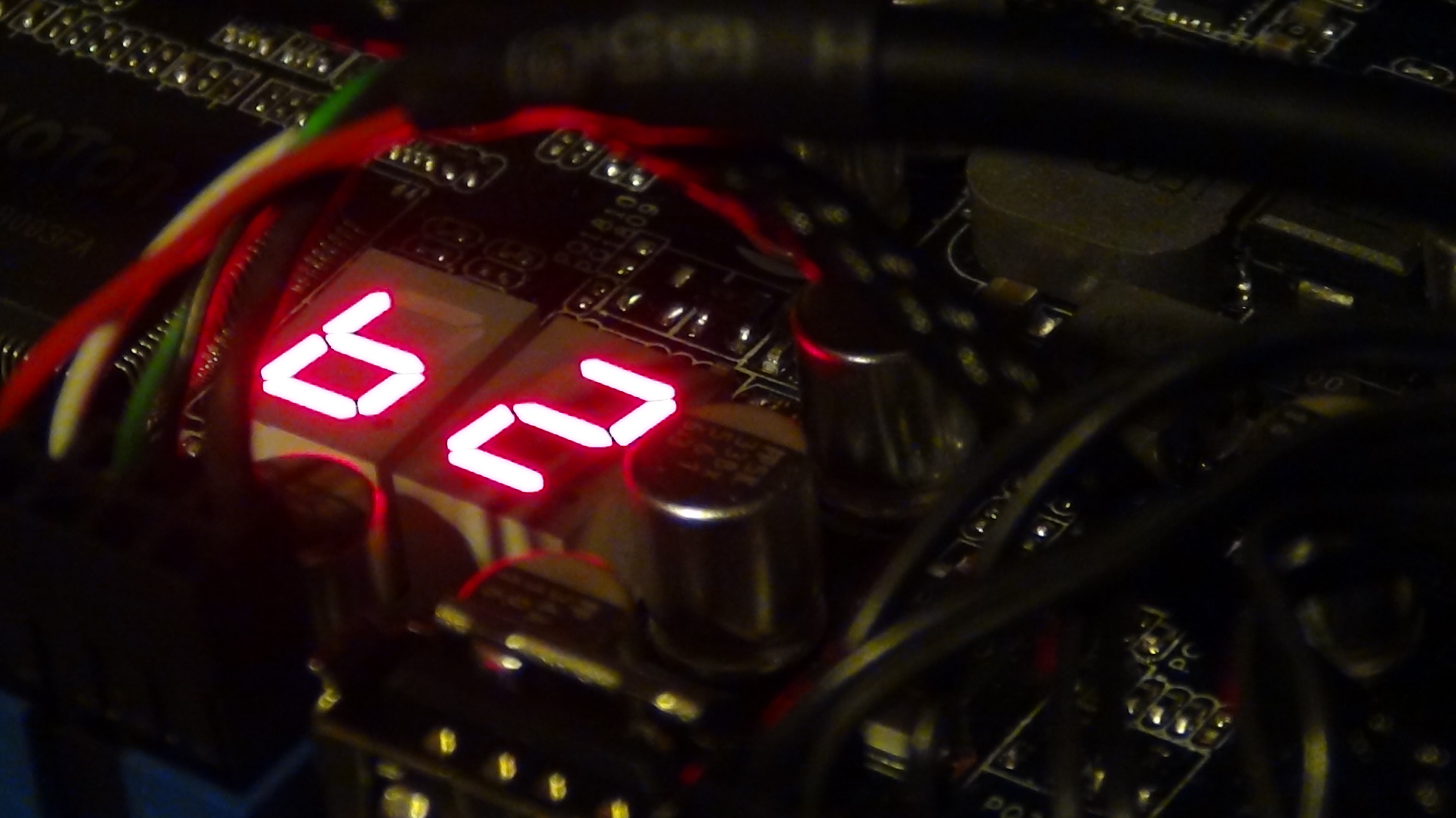

Hello Notiusweb
Thank you for replying and here is what I tried so far...
I tried just hooking 1 GPU to the riser and plugging into each PCI Express lane sequential to see if it was the lanes, and only Lane 1 worked 100%. I was able to get lane 3 and 5 to kinda work but the display was laggy, there was a "curtain" effect when loading the start menu, and random black screens. I even got a "bf" error code. And I couldn't get lanes 2,4,6 to work I kept getting error code 94 and b2 when I had it plugged in to those lanes I'll post some pics.
I then tried to go back to a 4 way set up and I got a Error Code 43 on the 4th GPU.
Unfortunately All this was tested before I did the "4G Enabled" in the BIOS, except for the 4 GPU set up. I had it enabled during that, but still a Error code 43. I'll give it another go in a couple of days, because I need my computer to be operational for tomorrow.
Part, If not the majority, of me wants to buy a new Motherboard because I feel like this should be a lot more simpler (at least this early in the process with only 6 GPUs). I did order that GPU cluster from Amfeltec so hopefully that will show some promise, but what Motherboards do you guys recommend?
Also this isn't a brand new motherboard, its been returned at least 5 times so it wouldn't surprise me if it was the problem.

Polish Ginger,
Cool pics of your rig. Sorry you're hitting these error codes!...
You may want to consider just using PCIE lane 1 for your display card. Usually at default this will yield best performance. I don't know your motherboard's ins and outs, but in general lane 1 will be set to have higher bandwidth through either, or both, of the hardware build or system BIOS config. So, if you use lane 1 for the display card, then mess around with the other PCIE lanes for trying to add as many working rendering cards as possible. I wouldn't worry that the other lanes don't work as well as lane 1. That may be how it's supposed to be, with the manufacturer assuming you will use lane 1 for your primary display GPU.
In my case, for whatever reason, my primary Titan X has to be connected directly to the motherboard itself, it will not boot up (gives error beeps) with it on the USB 3.0 risers I have. If you are able to use a riser for your primary display, that is pretty cool, because it frees up your lane 2 (mine is blocked)...
One other consideration, you had mentioned the benchmark tests with a working 5 cards (1 display, 4 additional). If you wanted to test how each card was pumping out CUDA, I would open a scene to be rendered in the Octane Render standalone and in the preferences menu, click box to enable or disable any combination of the 5 cards. This will allow you to see how the cards work together in a real world render situation. Keep in mind, enabling whatever card is primary will make the display slow down if you rotate angle, change focus, or mod materials, lighting, etc, because it will both try to output the display and generate CUDA computations for the rendering.
I myself am still awaiting feedback from my BIOS manufacturer as to why my motherboard doesn't like more than 10 GPU. I have enough power and lanes to exceed it, it may be the motherboard just can't handle it. In any event, I try to have a firm understanding of where the config stands when working. If I have scenarios working sometimes but not other times, I try to understand what is going on so that I'll be able to take these things into consideration as I add complexity.
Well, let us know how it goes!
