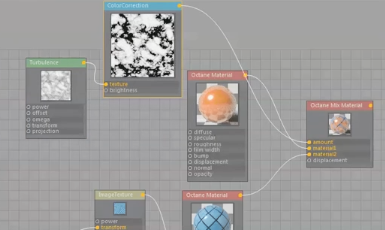

I hope otoy will solve it all in the next v3 version.. right otoy?.. Riiighhht??..
PS: Id like to have everything from C4D users - all features (buttons on preview mode, materials/maps with previews on nodes connections as in the picture, realtime texture baking, lighting passes...)..
pleeeeasseeeee (https://vimeo.com/105328990)

It is great for mixing materials/maps. Of course you can mix maps with different transform and scale nodes using the same mapping channel, but this cannildoe wrote:in to me why multiple uvw maps are so importa
be limited.
Sometimes I have a UV-Unwrap on channel 1, in which I paint some worn or damaged edges oder different kinds of masks. And then I´m mixing
this with a material with tileable maps using my simple box mapping on channel 2.
