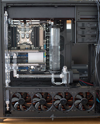

The build is almost done (I need to reduce some pump vibrations over 'shitty' 900D case - way too small - too short - no room for push pull on the beauty 65mm AMS radiator on the top, too narrow with poor cable management space on the back, too shallow - no room for the third fan in front when a lower rad is mounted, terrible design, a foolish hard to remove top cover with a dust filter, lack of access to screws for gpus, cheap thin metal material, terrible plastic mounts for hdds, no mount for an ssd at the back, weak hinges on both sides of the lower chamber, way too expensive for what you get). Sorry guys but I don't see any positive side of 900D for water. If caselabs s8 for 4 gpus costs 350$ (up to 500$) this is a masterpiece compared to very low quality, cheap, shitty 900D

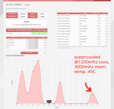

What is good - Zs are working so cool, 45C OC at 1250 MHz on core (I didn't test OC for memory - locked in MSI Afterburner). But in 900D and effective WC there is no more room for extra rads for more than 4 gpus (2x Zs).

hehe =) good points with 900D..it's far from perfect, just good enough option for those who think that You don't need to spend for case.. =) in the end, as they say, You get what You pay..- Case Labs is on different level for sure!
Great performance at those temps =) Guess those fans on AMS rads are whispering silent (how fast You run them under load?) Love routing - clean lines! (see where from You got the inspiration =p) simply beautiful work, Sebastian!

Yes - the fans are dead silent, under 1000RPMs, which is enough for 2x Zs. But the thin metal transfers way too much vibrations from the pumps over the case - I must come up with something to ease Piotrek's ears
