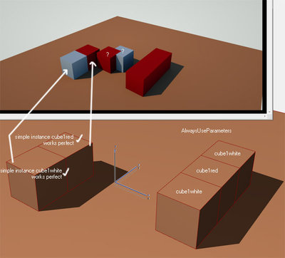

the new features come awesome fast! However, I have done some tests with 2.22.2.45, and I found something not so successfull. Please look at the picture and the set what I have done. Extract everything under C:\TEMP folder. Try it with AC18 as well, I made it with AC17, but it should be the same. It drops the message about the AlwaysUseParameters, it´s OK.
If I change a value in AC, and I refresh the Octane window (or reopen the whole Octane Plugin or the file), than always funny things come. On the left side you can see two simple instances, they work. On the right side you have three instances by AC-Parameters with AlwaysUseParameters turned on. They should be different, but they aren´t.
You won´t see the cubes in the middle at first, but if you change some values, and refresh, you can get it.
By the way, I get some reports in cuda log (ZIP).

Thanks for the bug report. I can replicate these issues with the scene you provided. I will post a fix in the next 24hrs.If I change a value in AC, and I refresh the Octane window (or reopen the whole Octane Plugin or the file), than always funny things come. On the left side you can see two simple instances, they work. On the right side you have three instances by AC-Parameters with AlwaysUseParameters turned on. They should be different, but they aren´t.

There is an issue with the latest release where in certain situations non-GDL parameter proxies are being interpreted as GDL proxies. I am working on a fix for this problem at the moment.That´s it! Refreshing by ArchiCAD parameters works perfectly. My dream came true. Thanks a lot!
