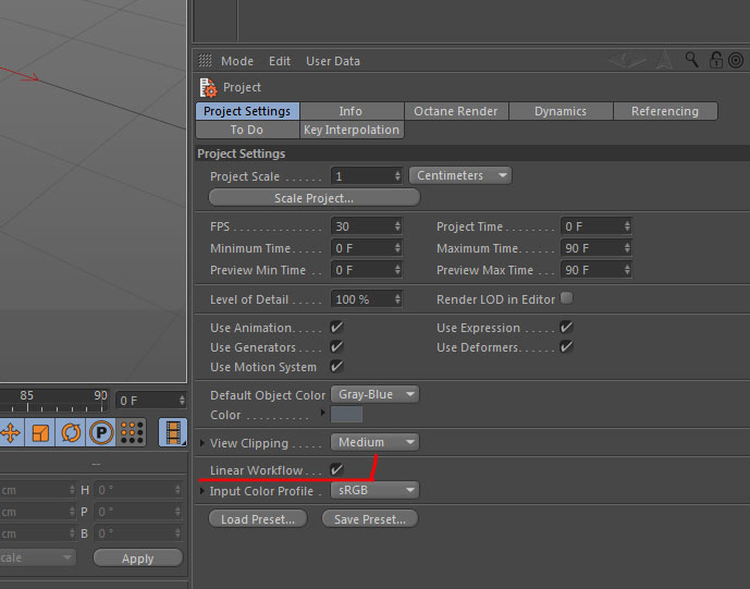

LSDI, in Render Settings at Save tab, is Image Color Profile set to sRGB and is Depth setting set to 8bit?
propably you are on mistake of comparing the tonemapped output of LV with picture viewer. Scene color profile does not affects the render output. It matches opengl and preview material colors with your input colors.LSDI wrote:thanks,
but no effect
Pascal
There is two new parameter in pass settings. "Image color profile" and "Tonemap type". Default values are linear. It should match the scenario of "linear" camera imager with gamma 2.2.

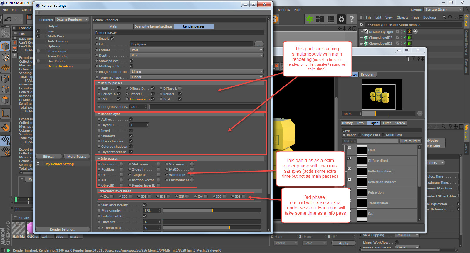

How should render passes be set up with only 1 or 2 checkpoints? Can you elaborate a bit more on this? There aren't that much configuration options for the render passes node. The biggest chunk is actually all the different render passes Octane offers.
What render passes do you have enabled? All the beauty passes are rendered in parallel and afterwards (or in between) the info passes are rendered. There is a performance impact on the beauty passes but it's more likely a few percent. A factor of almost 3 looks like a bug. Can you report the time difference without any info passes enabled. The only reason for this big time difference is if you would have a lot of info passes enabled. I would be surprised if we wouldn't match the performance of Cinema's render engine, can you give us some numbers or an example scene?

i guess that's a wrong test. As Thomas(strafied) said that beauty passes runs parallel. Info passes takes extra time because done in secondary phase. Also if select multiple render masks, they will be generated 3th render phase. Also each pass will take some seconds to save as files.TogTobias wrote:Installed this version. Got render passes and layer masks to work. Here's some concerns.

So there is no straightforward formula like: Normal render=10sec, withpasses=26 sec. So again normal=100sec, passes will take 260 sec. This is completely wrong result on your side. Try different setups with different resolutions. You should be aware this there is two max samples for main passes + info passes. Will decide the passes how long will be rendered. Also be aware that each pass will consume extra vram as main buffer.
Additionaly what's the multiple points to setup. It's nearly ready to render with only a few click. Parameters defaultly are ready to best states. If you share your experience will check it.

I explained background of process in my previous message. which passes are selected in your tests? Test it with only beauty passes without masks, info passes. You'll not see any big differences on render times. see imageLSDI wrote:I Aoktar
