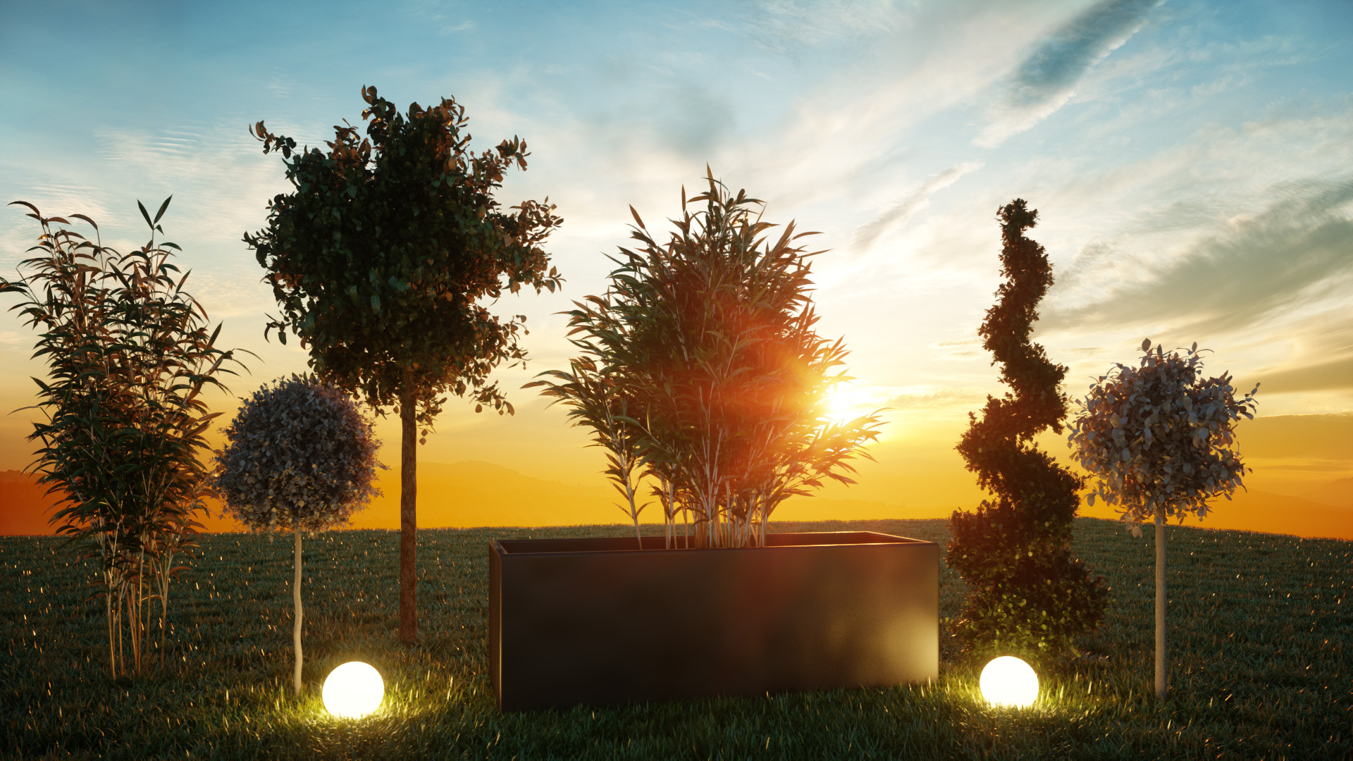

And here is result of that mixing layers combo i described in my workflow made from single TGA 32b+Keep Environment feature (v 2.16), no layers, no passes rendered/needed, quick and dirty but it works and it can work in animation also in AE if the camera movement is slow enoough and oyu have animated couds video/null object attached/tracekd....:). Really i had lot of usages with that nice feature we had before 2.20.
