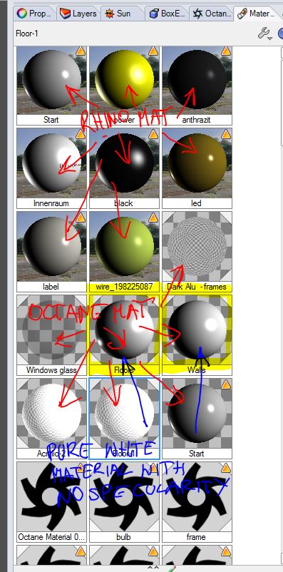

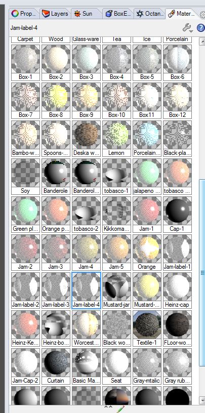

I found another issue with material thumbnails - they are not displaying properly (it looks to me like thumbnails show rhino material instead of octane), and get always updating (or sometimes not - hard to say when - usually when I scroll material window, then it gets stuck for a while to refresh materials, even if I turn of auto update all thumbnails).
Some screenshots in attachment.
You are right. I am talking to McNeel on this issue.
