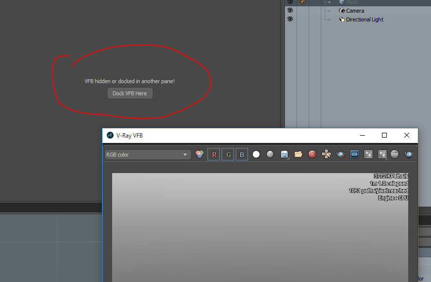

face_off wrote:
Is there a specific reason for preview mode to change?
Yes - because you have have more than one Octane viewport open at once, the plugin does not know which viewport to use as the resolution size. The new fit-to-preview window auto-zooming should more than compensate for this.
I'm not sure what the initial reasoning was behind allowing more than 1 octane viewport, but I havent found any great use for it. In V-Ray, when a second viewport is opened, it becomes the main viewport and the first one is stopped with a message in the window: "VFB hidden or docked in another panel - dock VFB here"
I would rather have 1 viewport available and get the autoscaling when "preview" is active like 801.
Win10 Pro / Ryzen 5950X / 128GB / RTX 4090 / MODO
"I am the resurrection, and the life: he that believeth in me, though he were dead, yet shall he live" - Jesus Christ
