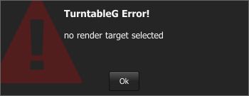

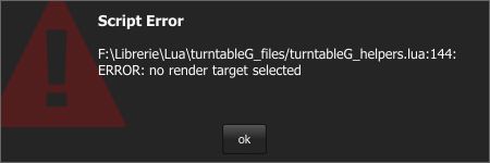

if i select the rt3 node and run the script, it gives me this error message:

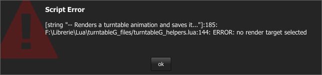

if i select a different rt and after, in the script menu i select the rt3, it gives this error:

I think that would be correct since rt3 is an imported project with its own mesh and target. @Jason were you intending to allow the script to find any render target in the project and process that target.
If you d-click and expand the project then select the render target not its output then the script works.
Posts: 10643
hi,
just to clarify, rt3 is not imported, it's just an rt grouped, infact, it doesn't have his mesh node but an input-mesh-node.
anyway, this is not a big deal, as tupax said, just expand the node and select the rt ;)
