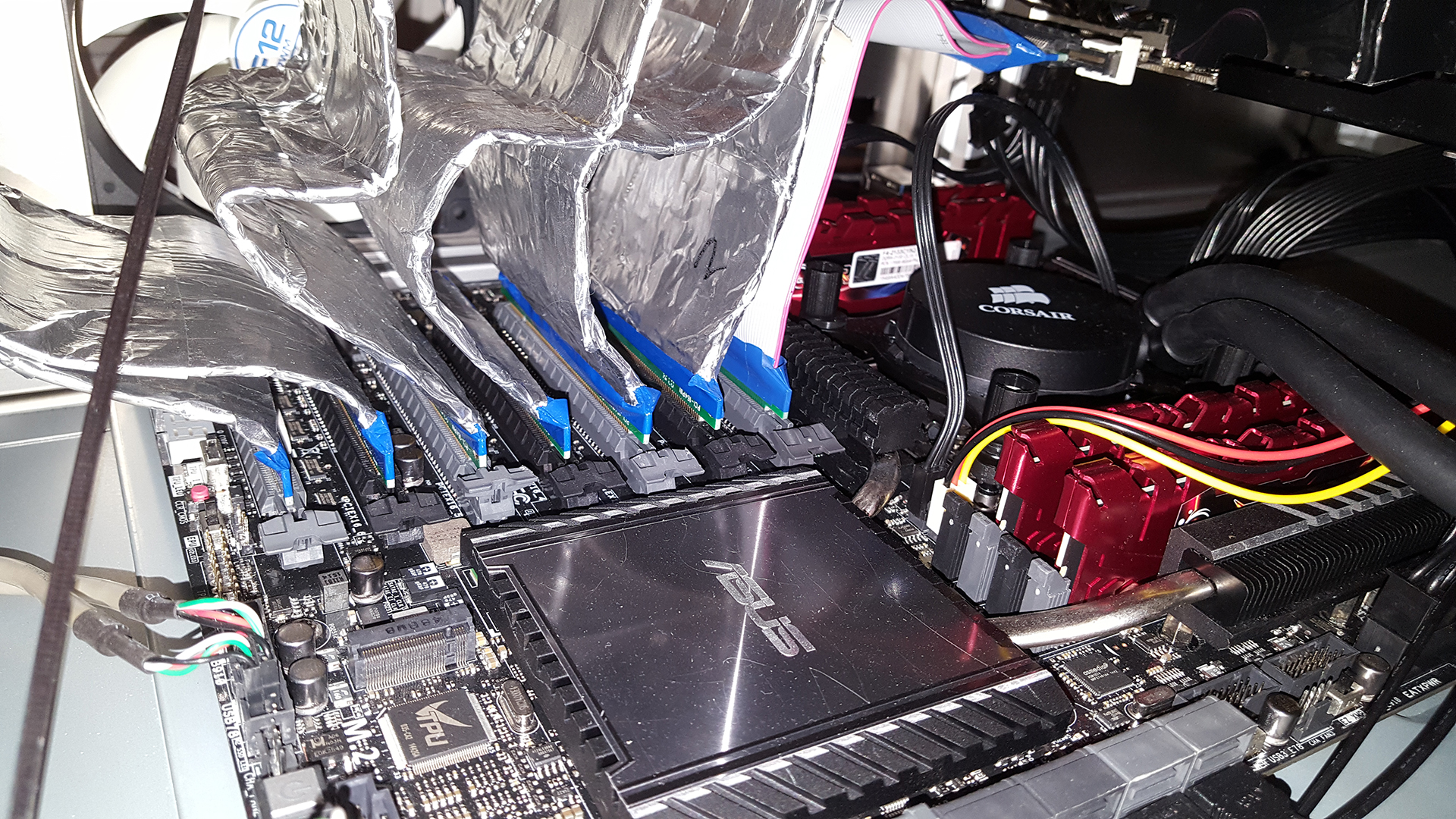

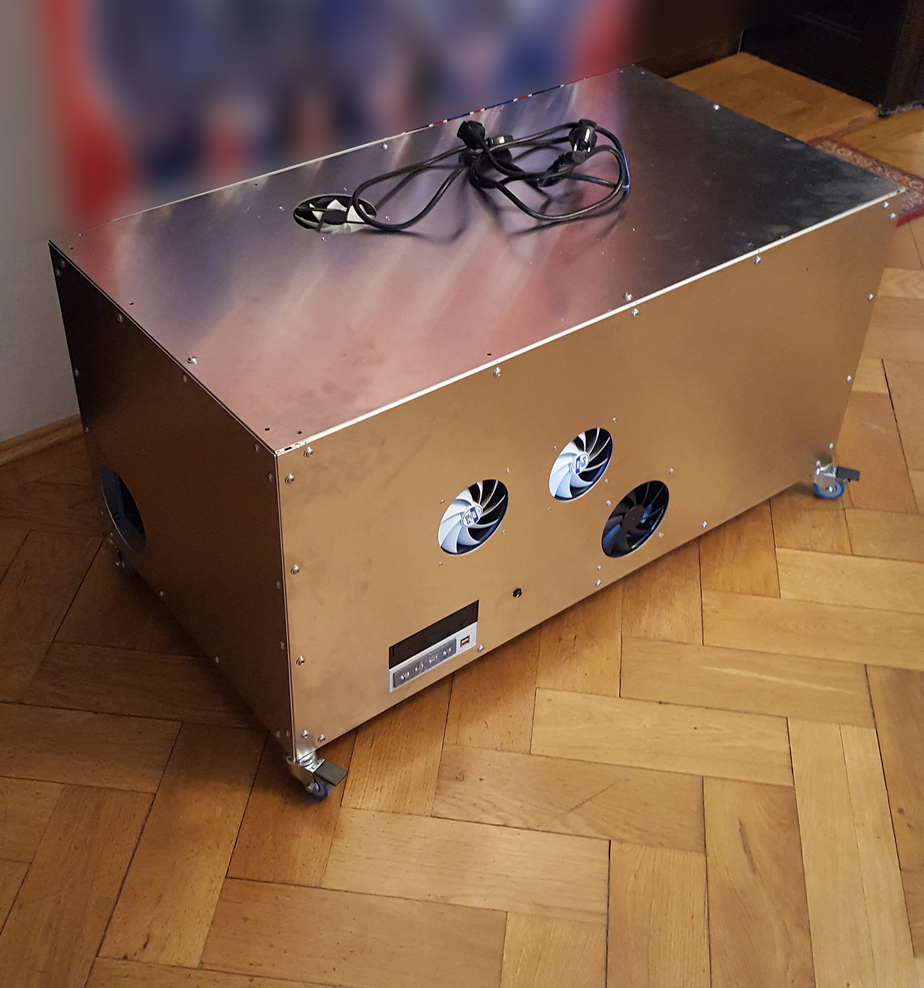

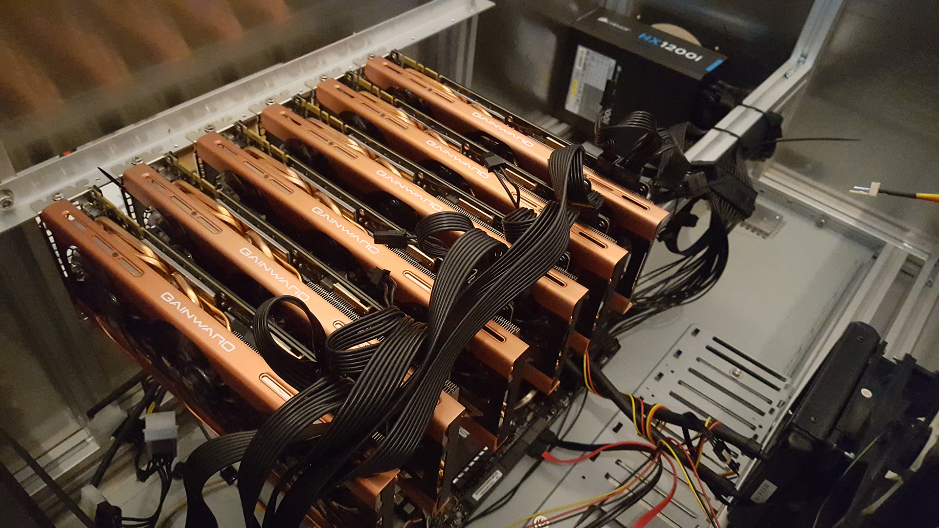

My new Renderclient :-)
7 GPU Rig
glimpse
Posts: 3740
that's nice box! =) is the back side open?
NVN
Posts: 504
Joined: Tue Jun 08, 2010 8:10 pm
glimpse wrote:that's nice box! =) is the back side open?
its also closed.
Heat is around 60° under full load :-))

Awesome! Can we get full specs?
glimpse
Posts: 3740
its also closed.
very very interesting =) & surprised quite a bit to see the temperature inside that box not to climb over 60C.
smicha
Posts: 3151
Location: Warsaw, Poland
Great machine. Tell us more about mobo you are using and any special bios settings - 4G is on?
NVN
Posts: 504
smicha wrote:Great machine. Tell us more about mobo you are using and any special bios settings - 4G is on?
Here u are:
Intel® Core™ i7-5820K
Mainboard ASUS X99-E WS ( Tip from glimpse ) :)
6x 980ti + 1x 960 ( i choose all GPU from one Family, its better driver compatibility)
HD is a normal 1TB, nothing special.
2x 1500 Watt PSU
ok, after 6 Hour Rendering the temperature is about 68°....but its also fine :-)
no special bios settings.
What did u mean with 4G?
