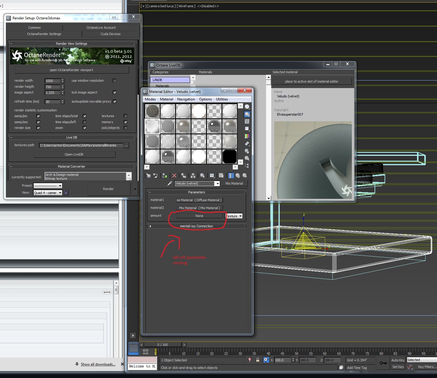

tonycho
Posts: 391
Joined: Mon Jun 07, 2010 3:03 am
Location: Surabaya - Indonesia
Hi Karba
please check
when I download livedb material (veludo (velvet) from Elvissuperstar007)
the falloff parameter is missing
I am using max 2013
http://www.antoni3D.com

tonycho wrote:Hi Karba
please check
I am using max 2013
I will fix that.
