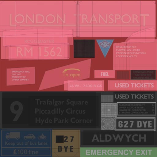

Alpha maps are not necessary and would mean more images. I use my own method. The color of the bus in areas without UV is taken from a sample image of 2x2 pixels. This color is the exact color of the background of my main texture map. Taking the color directly from the main map would be possible but would require a complete UV unwrapping of the bus, that could be very tedious and messy. A procedural color is the simples and most economical way, and can also be used to avoid this 2x2 image if required, but I used the image sample because I can't get easily the exact color in the color mixer of Octane (seem to not match photoshop Hexadecimal value).
I use very few textures (less than 10). Individual textures are necessary for tileable textures like the front grille, or complex like the platform floor or the advertizing billboards. Most of the textures of stickers, plates... are on the same 2048x2048 image on which I use every smallest surface available. Textures are very optimized on this project as the bus will be integrated in a city scene, it is most important !
Here is a reduced image of the main texture with used UV areas shown.
I will use smallest spaces to add some details like screw heads or small stickers.
A high resolution is required (2048x2048 may not be enough) because I want to render in 8000x4500 at least for posters.

Ah, ok. So you put several textures into one texture and make sure your UVs match up, thats what I figured. But, why so many materials? you could have all the parts that use a single texture to be the same material.

Sharing textures is not enough. Every part with same texture has not same specularity, or some have bump and other have not... so I really need as many materials or almost as in real world.
It is not yet obvious, but the inside is modelled and textured as well ! This bus is intended to be seen from every possible point of view, even in close up.
