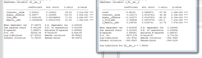

If I were to be more precise: 780, 780Ti, Titan, Titan Black, Titan Z are made on the same GK110 chipset, so their specs differ primarily by number of cuda cores. From my statistical inference (my signature and the attachment) we know that Octane speed comes in 1/4th from memory clock, and in 3/4th from core clock (useful info for OC). Hence theoretical comparison between all GK110 chipset-based cards may be given by (base clock used, divided by 1e10):
780: 2304*6000*863 = 1.19 => 100%
780Ti: 2880*7000*875 = 1.76 => 148%
Titan: 2688*6000*837 = 1.35 => 113%
Titan Black: 2880*7000*889 = 1.79 => 150%
Titan Z: 5760*7000*705* = 2.82 => 238%
Now if we assume that 980 performs close to 780 you may find these relative indicator useful. Bear in mind that watercooling may give much better results, i.e., 780 6GB runs at 1300 mhz core and 7000 memory, so in theory it is 75% faster than in base clock (measured 45% faster than a 4-way setup on air cooling with no extra space between cards).
