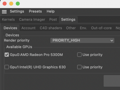

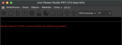

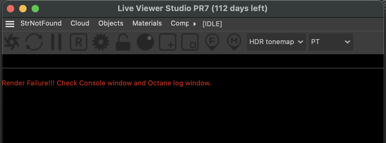

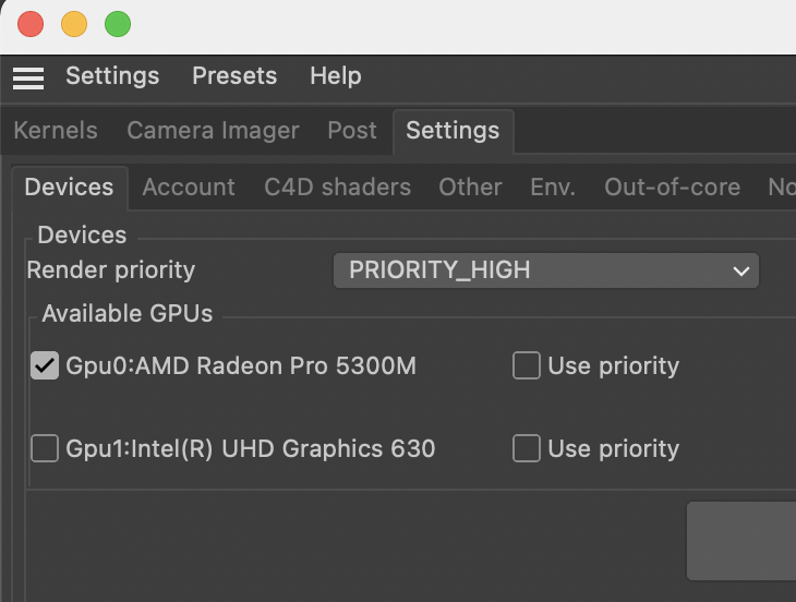

atoyuser1 wrote:Upgraded to Big Sur and Downloaded PR7: Is there a reason it still says PR6?
The attachment Screenshot 2021-01-21 at 16.23.17.png is no longer available
Weirdly, now it's displaying PR7, but crashes on render (completely empty scene):
Any ideas why?
Edit: Same with PR5. Hoping I can solve this without having to roll back to Catalina

Posts: 10490
do you also have an Intel GPU in your Mac?
If yes, please disable it in c4doctaneX Settings/Devices panel, and render only with AMD GPUs for now.
If not, please, open a scene, then go to c4doctane Settings/Other tab, and, at the bottom of the panel, enable all the Log option checkboxes.
Then, load the scene in Live View, then in Picture Viewer, or until crash, then reopen c4d, navigate to c4doctane Settings/Other tab, press the Generate log report button, and share the octanelog_report.zip file, thanks.

Hi, it's just AMD. Have DM'ed you my crash log
Also, I think I figured out why it says PR6, because the startup layout was saved when 6 was active. You need to close the octane diaglog and reopen (then re-save startup layout)

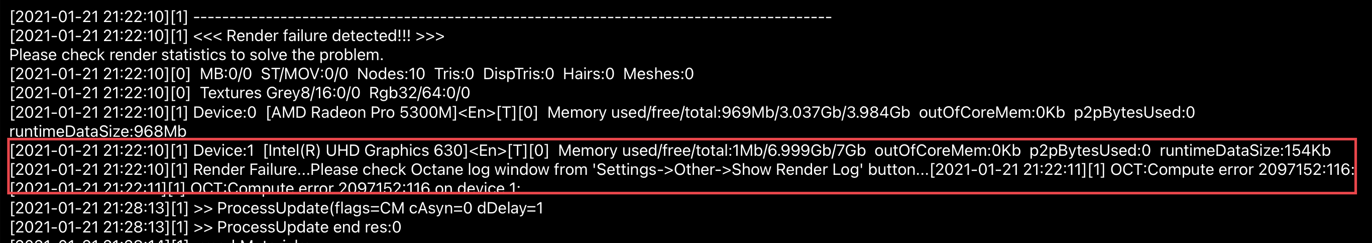

Posts: 10490
atoyuser1 wrote:Hi, it's just AMD. Have DM'ed you my crash log
the log shows that the Intel GPU is active, so it crashes, please completely disable it in Settings/Devices panel, and render only with AMD for now:
AI Denoiser is not working in PR7, and must be disabled in both Camera Imager and Render Settings.
C4DOctaneX is available for R21, S22, R23.
Please note that C4D R20 is not well supported in Catalina itself, and older versions are completely not supported in Catalina or newer Os X versions:
https://support.maxon.net/kb/faq.php?id=58
A new version is on the go and will be published as soon as ready.
Thanks in advance for your patience.
ciao Beppe

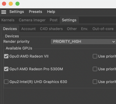

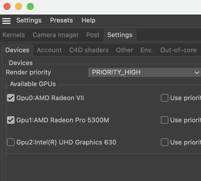

atoyuser1
Posts: 212
Joined: Sat May 02, 2020 1:10 pm
bepeg4d wrote: Hi,
Thanks, that's odd. I use C4D both with and without my AMD in the eGPU, but never have the 630 activated:
