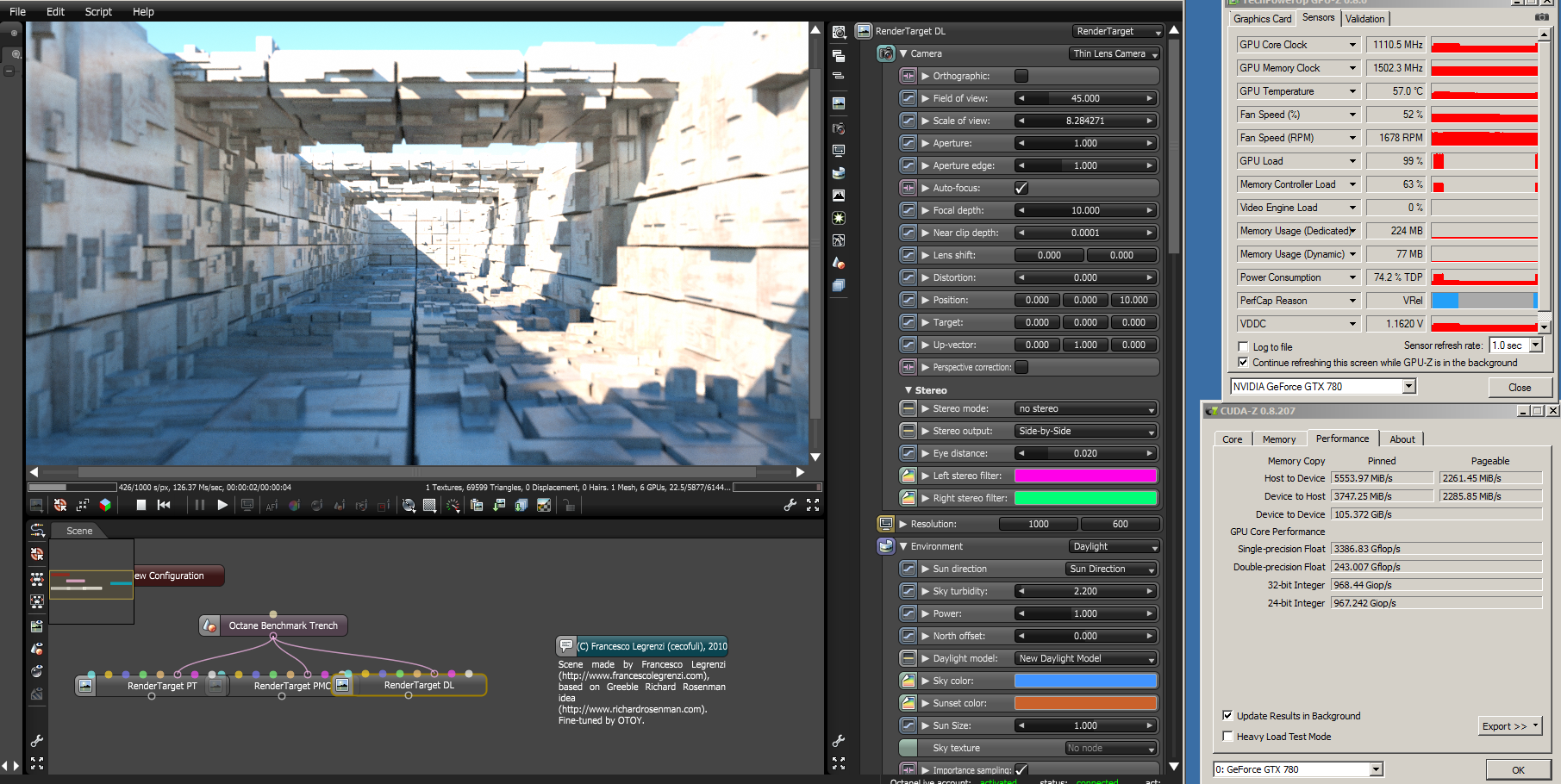

6xGTX 780 6G - GPU processor OCed by 200 MHz - air cooled
DL - 126.37 Ms/sec
PT - 103.03 Ms/sec
PathTerm = 1 and Coherent Ratio = 1.

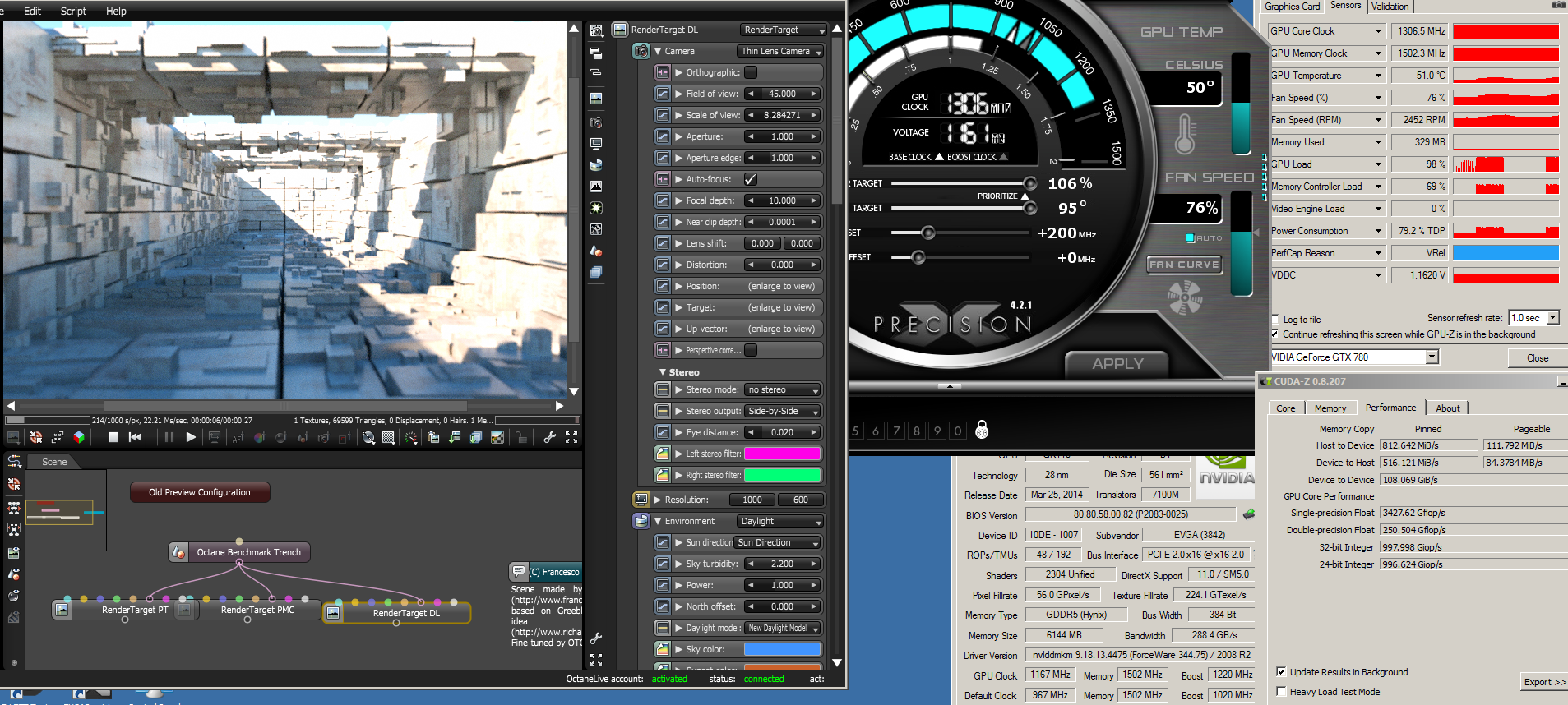

1xGTX780 6G - 200 MHz overclocking - air cooled
DL - 22.21 Ms/sec
PT - 19.47 Ms/sec

Tutor,
DL should be higher - around 300.
Nice temps at 1123mhz core clock. Do you have extra space between cards? Are you using raisers?

Thanks Smicha for your observations. That was my thought also. I'll soon be water-cooling these GPUs also.
smicha wrote:Nice temps at 1123mhz core clock. Do you have extra space between cards? Are you using raisers?
The cards were all packed closely together. I don't have any raisers. The temps are low because these GPUs are in a Tyan server that has that characteristic wind tunnel cooling.

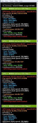

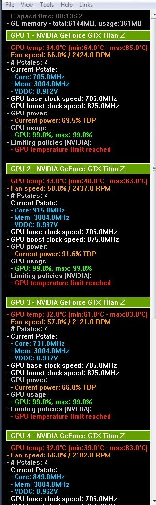

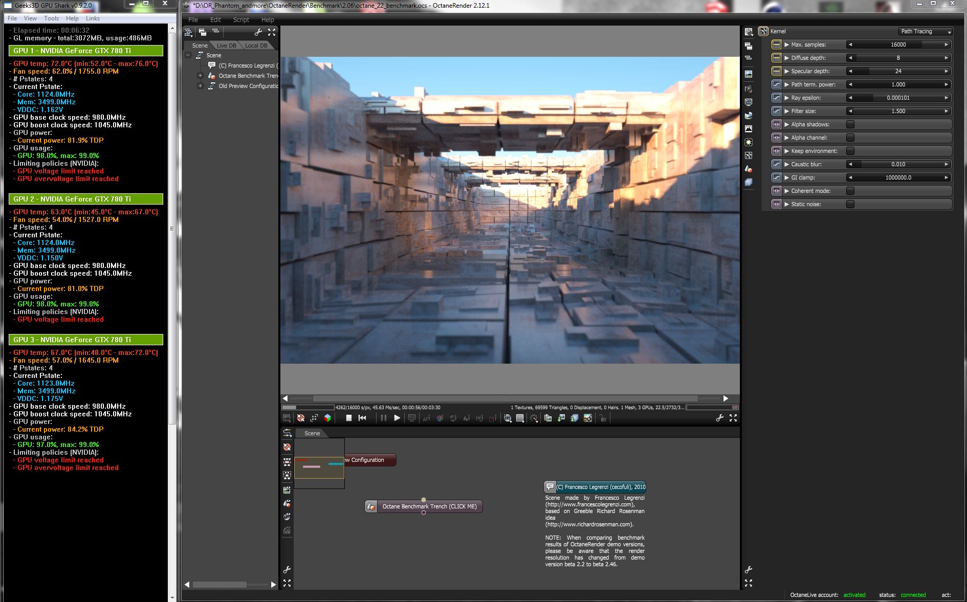

Nice to compare the 780Ti with TitanZ:
PT, Alpha shadows off (>15000 s/px):
path term power 1 , coherent mode on
test done twice
2x TitanZ: 43.30 Ms/sec (around 15000px), 3:09 sec for 16000px
3x 780Ti: 45.34 Ms/sec (around 15000px), 3:30 sec for 16000px
You can see that MS/sec does not say much, because this numter is changing during time.
Therefor the total rendertime , i.e. 16000px is a better number to compare.
Both setups have a slot space between the cards and therefor a very good airflow
Looking at the numbers he 780 Ti is really a winner (compare 3gpu of the 780 with 4gpu of the Titans)... if 3gb is enough and if you can have them in a case with a slot space between the cards!!!!
cheers,
edited: added the numbers of the 2x TitanZ
